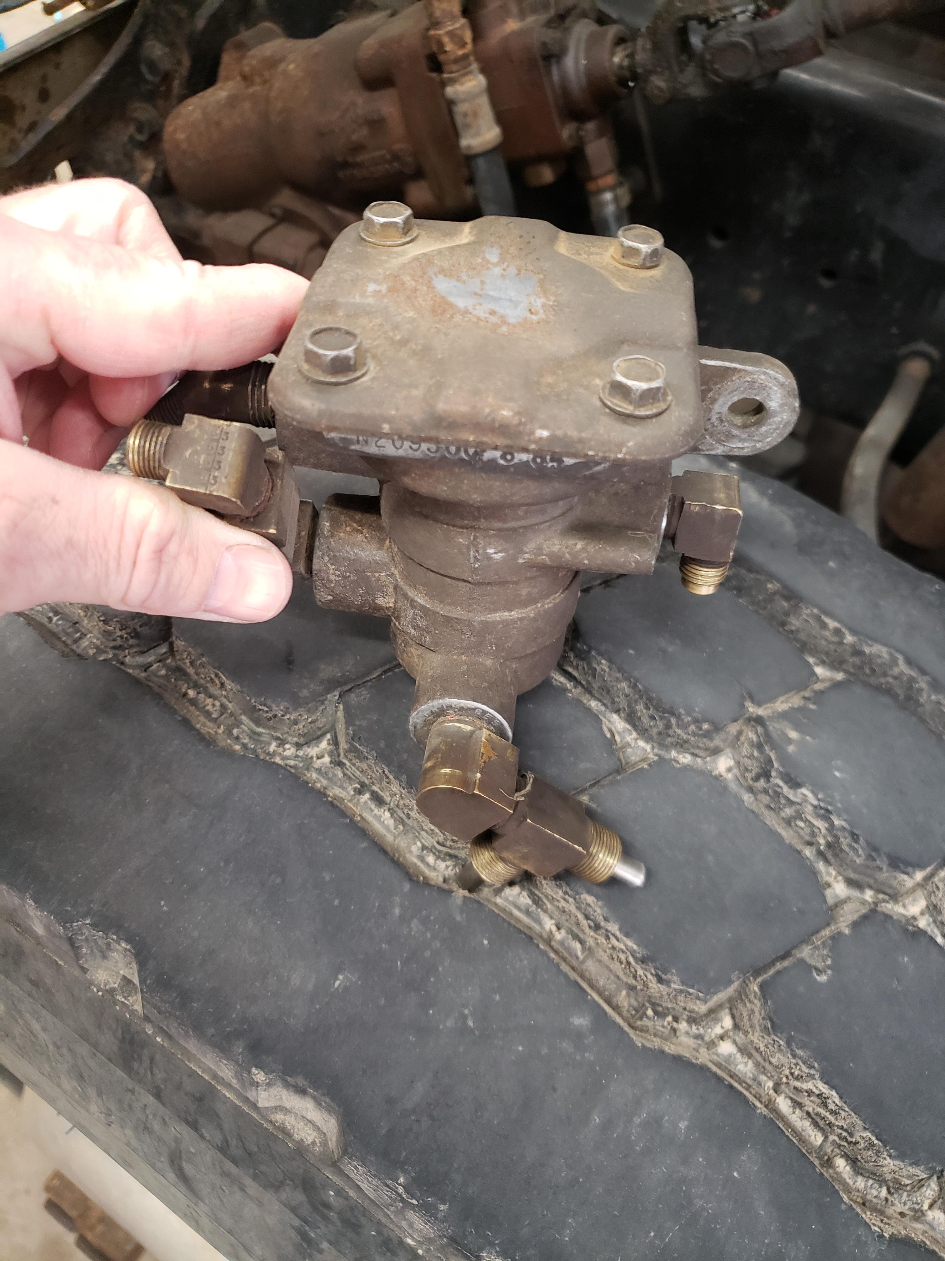

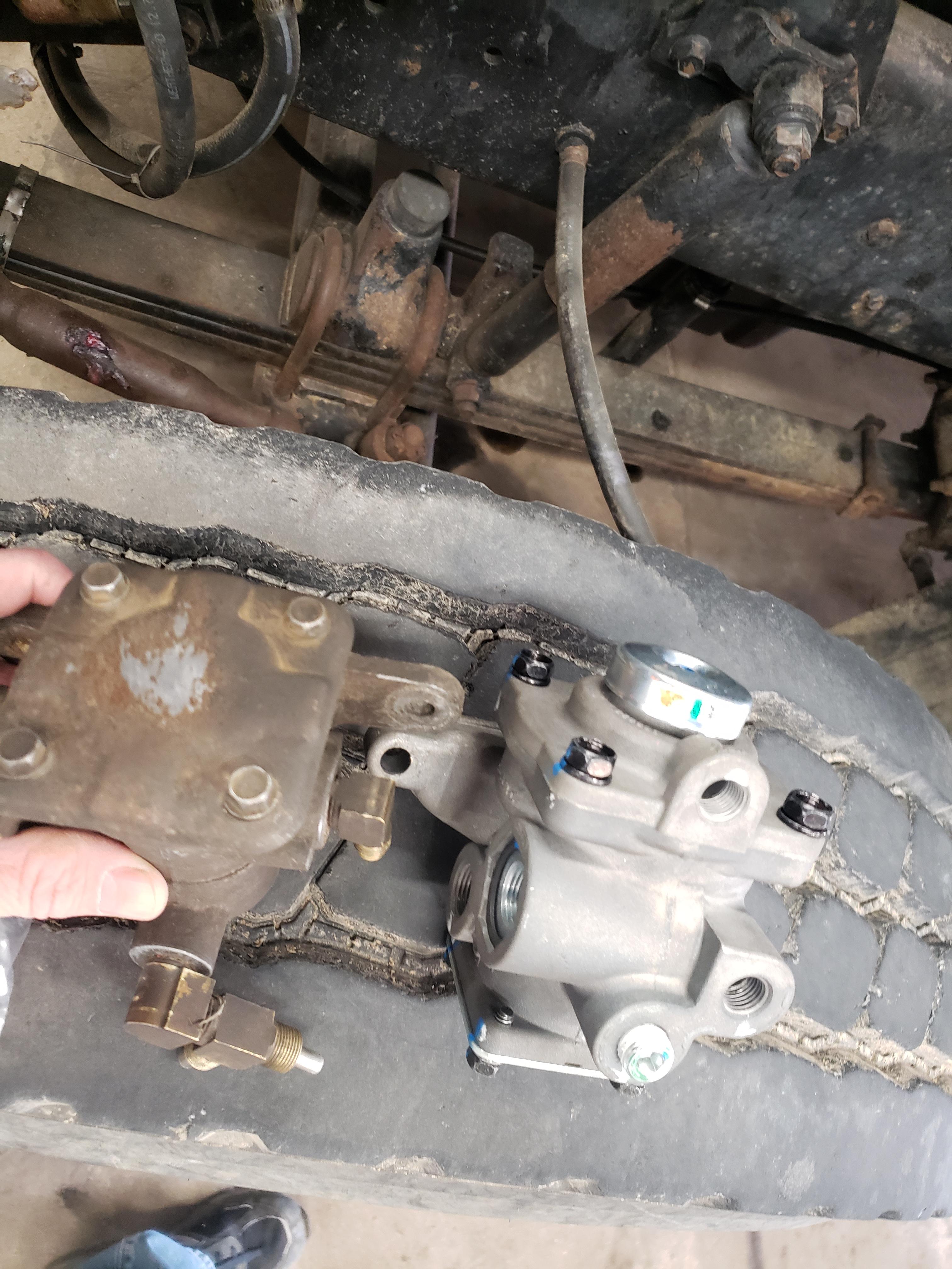

Hi all!, just looking for some info on this spring brake valve I believe? I went to my local dealer and this is the part they gave me but the new part will not bolt up to the cab and the new valve has another fitting hole to it? Is this the right part and a updated version? Or just the wrong part? The truck is a 85 rs688lst with a e6 350 engine, any help would be great! Thanks in advance!!
That's a Midland inversion valve. not familiar with the new one. The inversion valve controls the spring brakes and helps to stop you if you lose air in primary system.I would just eliminate it, they quit putting these on back at least  25 years ago.
