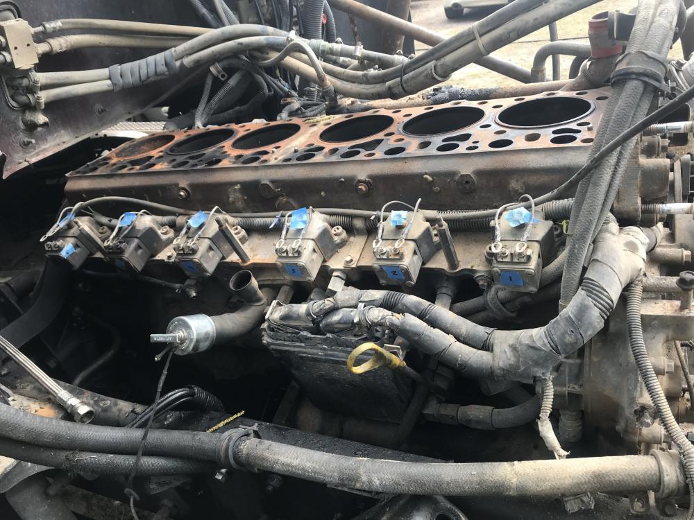

I have a 2000 cx613 trying to do an Inframe but not sure what motor I have truck says to be E7-460 but could have been swapped. I can’t find anything on the motor telling me what it is. Any help would be appreciated
vin 1M1AE07YEYW002545

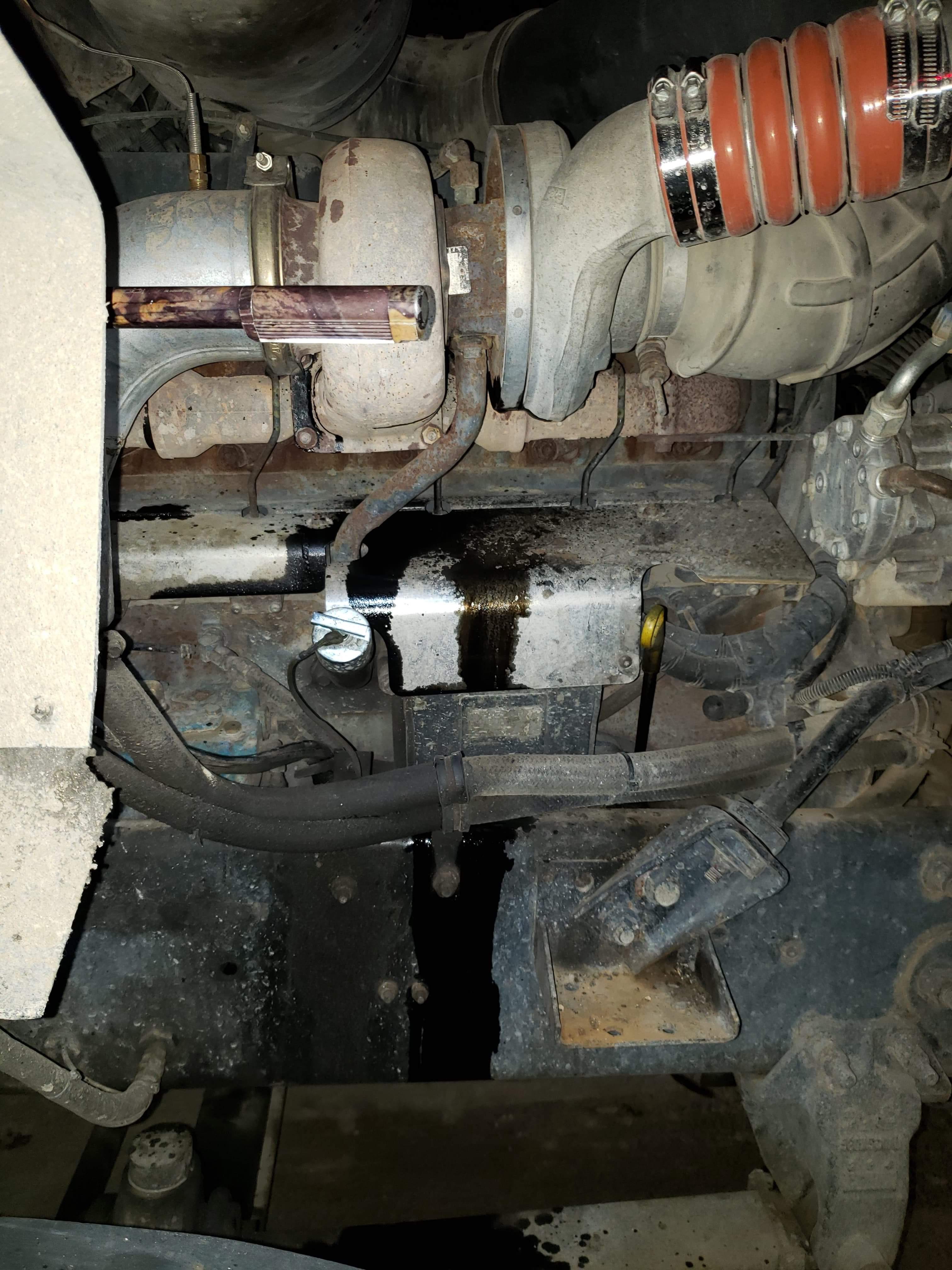

also found these numbers on the block under the oil fill tube
950140
5537M 9272 6374

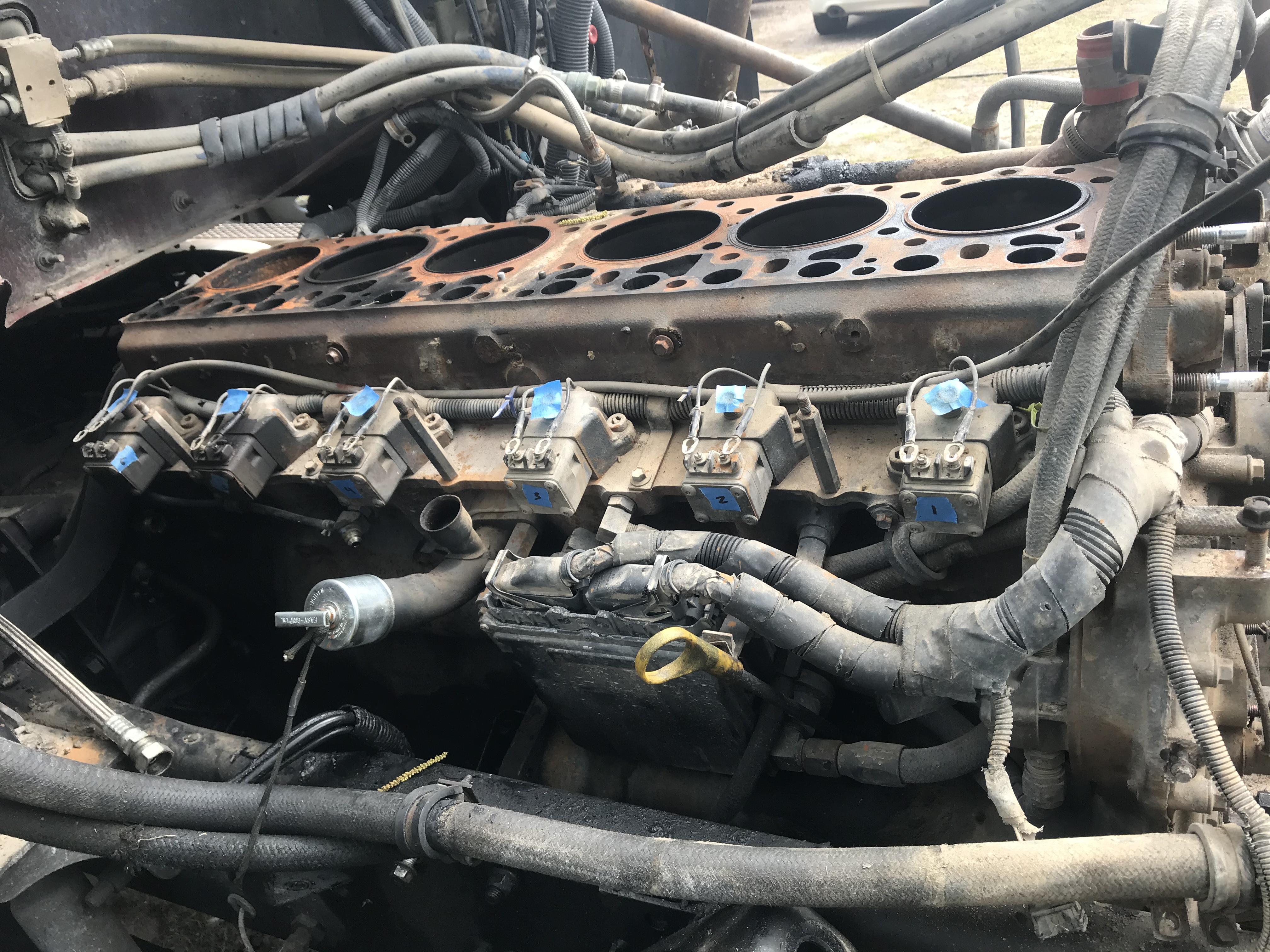

Rare chance you have a retrofit engine from a different vintage. It’s a pain in the butt to convert. The only engine better than yours is a 2002, and it won’t share computers. By 2003 it was an EGR engine and you’d never install that to a pre-3 emissions. Your truck is in the middle of the post-PLN V-Mac II 1998-1/2 and pre-2002 CCRS era. PLN has one pump. Take a side pics of the engines right side and post them.

That's a post 1998-1/2 and pre 2002 CCRS E-Tech. Low likelihood that it's a swapped engine, most likely original to the vin. Even if it was swapped it has the same internal base engine parts (for those years) as the original.
Looks like somebody had a head start on your overhaul.... why did they stop?

Good to know thanks!! Yeah me and my brother have been working on it slowly I need to pull the cam and order parts just not sure what kit to get I was thinking the pai performance kit with the coated pistons and bearings and such
