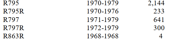

20 minutes ago, 67RModel said:
It would be really sweet to own that lone RS800 or at least even see it. I wonder who it was built for and why they only made one of them. 800 series DMs were fairly common. Did Mack build any R800s in Allentown?
Four, in 1968, it appears...
I can't remember.  Somebody remind me what the SECOND "R" stands for (Like in the R795R).  I know an "F at the end was for "Fire" apparatus.  But, I can't remember what the "R" suffix meant.  Slippin'...
Never mind.  Right-hand drive.  Duh!  Like I said, slippin'!  LOL!

On 1/20/2022 at 10:29 PM, doubleclutchinweasel said:
Wonder why this table points out a few models produced up to 1983 and even 1984 years?
Possibly was it mean "Hayward models" which didn't mean "trucks made in Hayward"?
