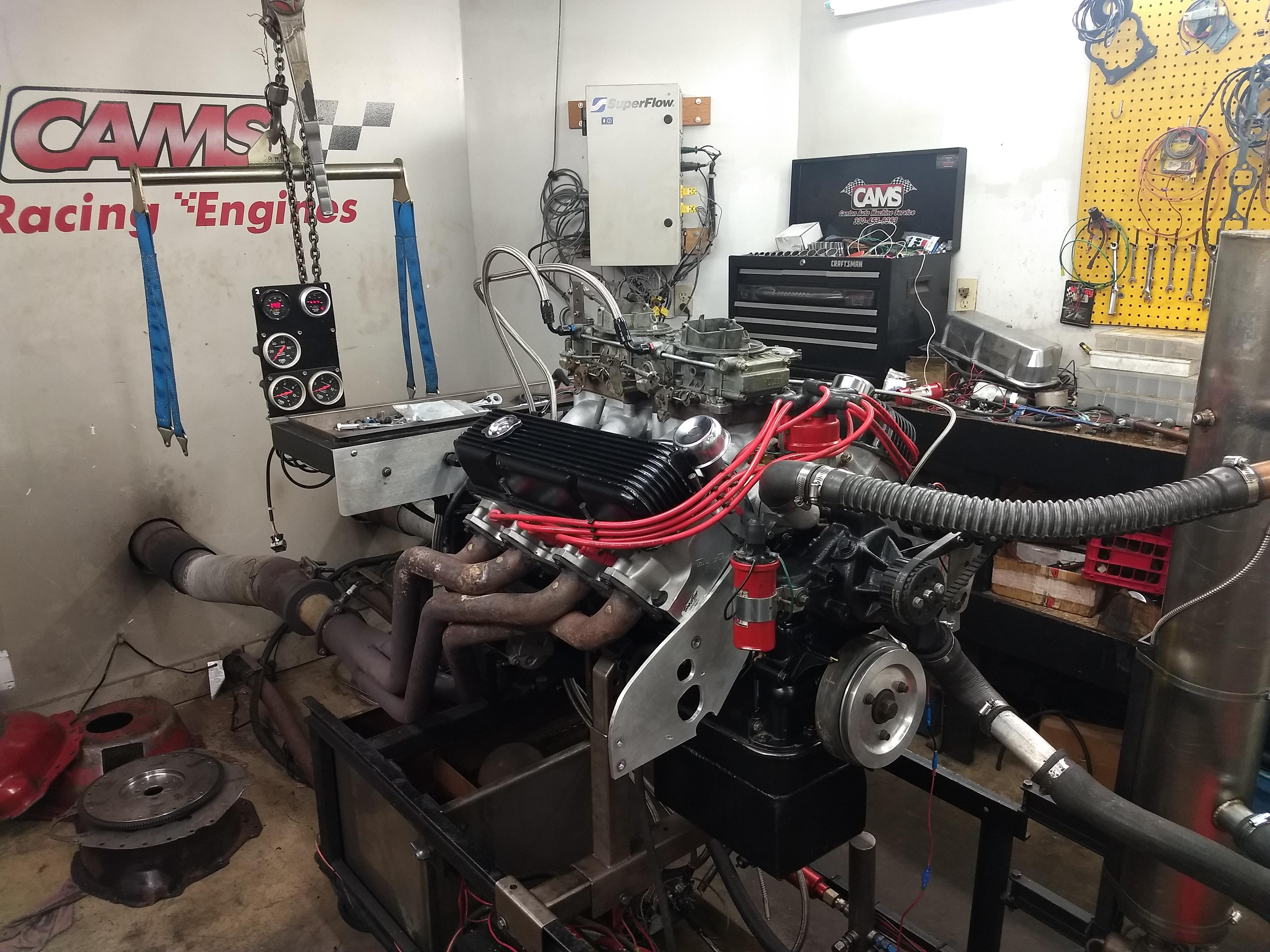

I finally dynoed my new engine last weekend.  Really snowballed to more then I really wanted to put onto it.  496 FE, trick flow heads, roller cam, TD rockers, tunnel wedge 2x4 intake with 2 600 holleys.  Made 665 hp at 6600, 630 ft lb at 4000 rpm.  Car went 10.69@125 last year, it should see 10.4's?  Hope to install it this weekend.  First stick race is june 27.  Really wanting to get behind the wheel again!

That’s cool Larry, I’d like to make it to one of those UMTR races one of these days but who knows when?  What does the wagon weigh in at these days?  BTW, I have a T+D shaft setup on the engine in this car and they appear to have been worth the money.  Andy

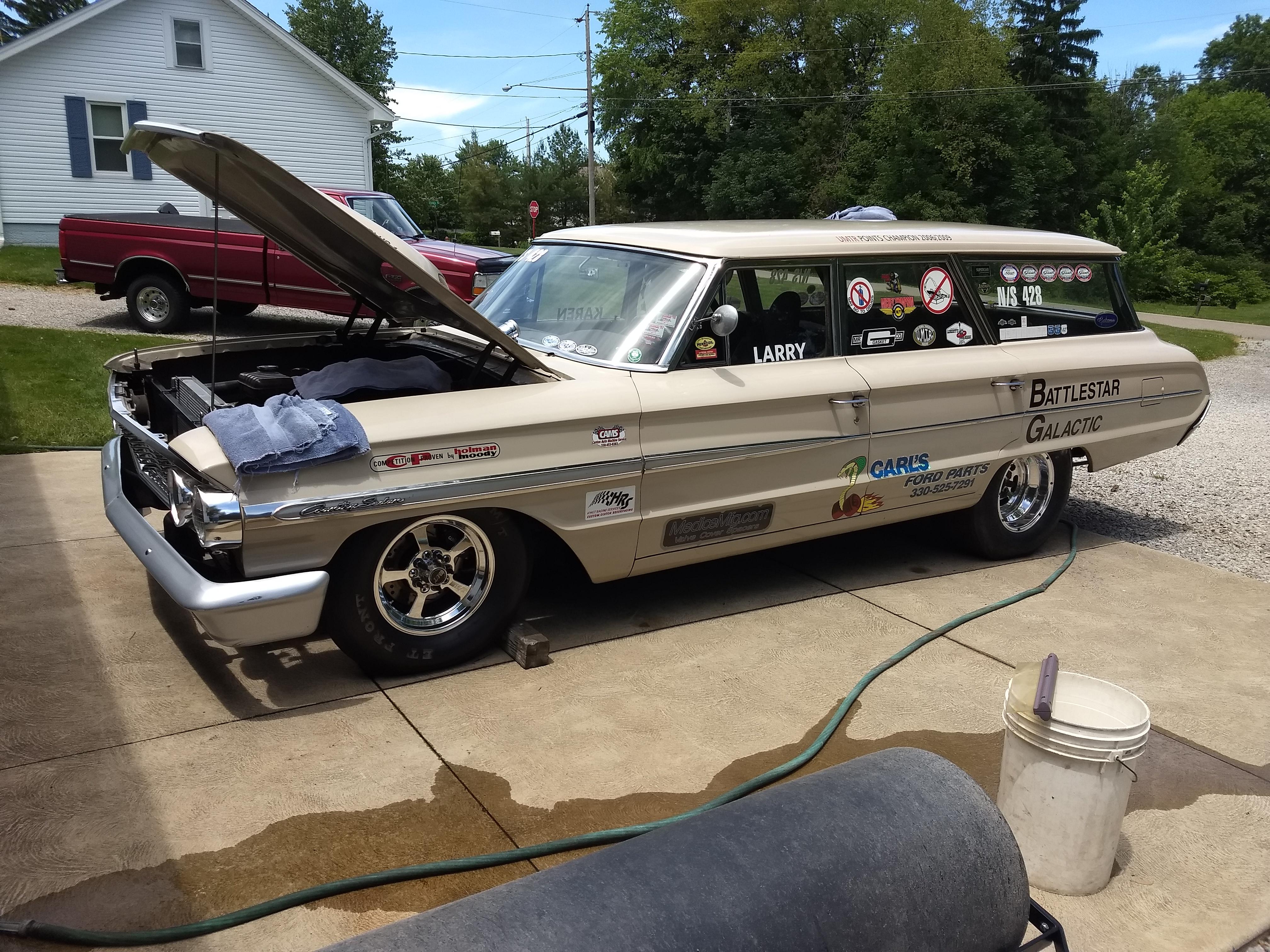

Well, i brought it home Friday afternoon, got an early start today and it's in the car and running by noon!
Got some tidying up to do, wash the car and get it loaded up tomorrow?  Hope to tnt it next Friday to see what it will do and be ready for the race on the 27th.

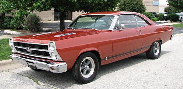

          I remember a 69 issue of HOT ROD mag that pitted the Z28, Boss 302 and the AMX. The AMX killed the other two, Both the Z28 and the boss couldn't break 100 without slicks.
          I owned three of these at one time years ago, two GTA's one GT. One GTA had a 428 with a manual body C6 with a Side Winder intake and several other fast parts.

 " I owned three of these at one time years ago, two GTA's one GT. One GTA had a 428 with a manual body C6 with a Side Winder intake and several other fast parts."
A friend of mine had a GTA way back in the day, he did swap a 4spd into it and 4.56 gears.  Was a real go getter then.  He also owned a Boss 302 in the early 70's.  He borrowed the motor for his altered wheelbase Comet he bought to race.  That Comet turned out to be Hayden Proffits car, which was bought and restored by another friend of ours.

wow,,,,what a good lookin SOB     :thumb:...bob
