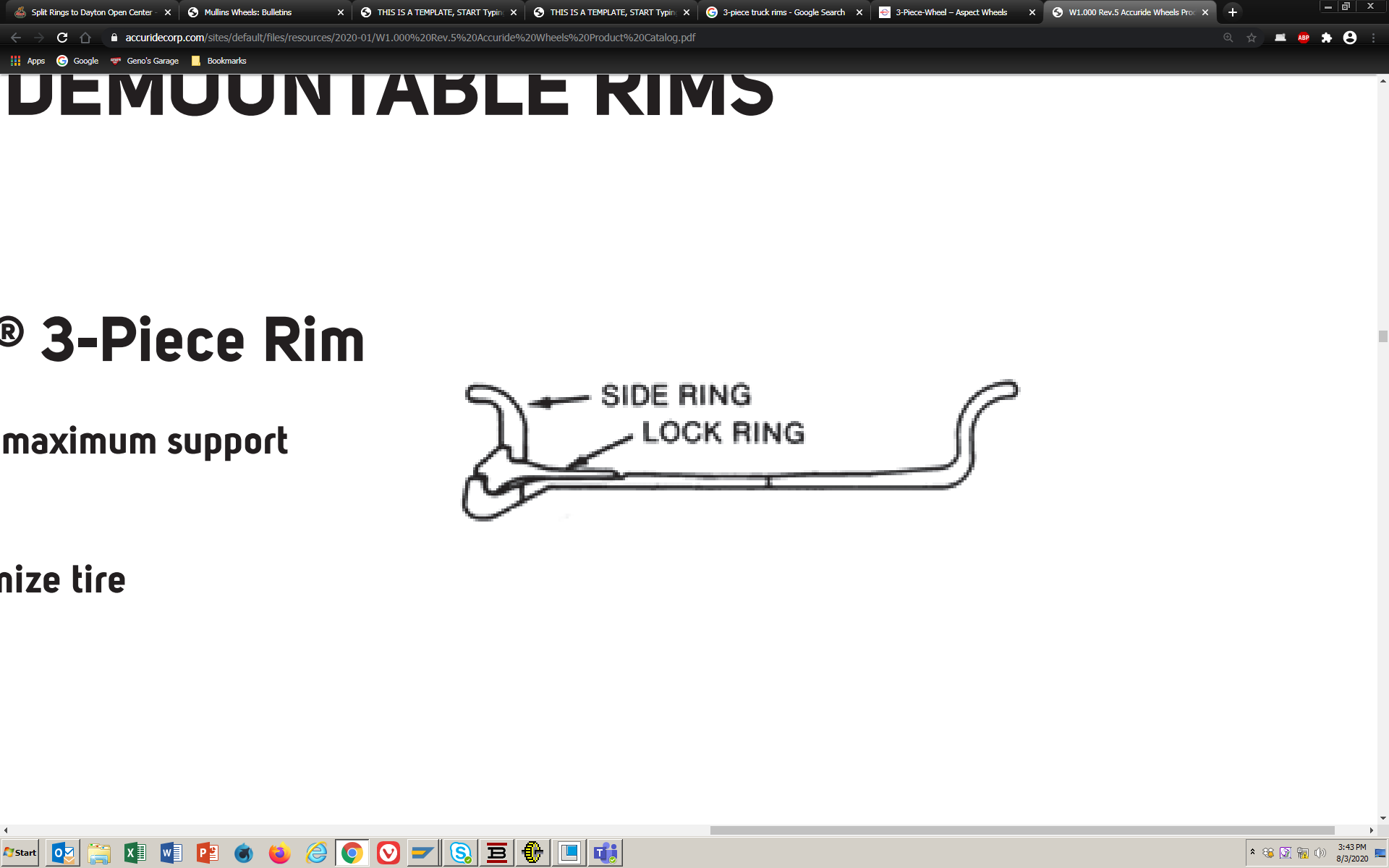

I also had another tube-type rim on my truck.  It was the 3-piece design (see below).  Accuride still lists these.  Had a solid (not split) outer rim.  Press the outer rim down and put the split lock ring on.  When the air built up, it pushed the solid outer rim over the split lock ring, squeezing it down, rather than pushing it out.  A lot better than a 2-piece widowmaker, but still nowhere near as good as a 1-piece tubeless setup.  I recall seeing that same 3-piece setup somewhere else with an o-ring to seal it up and use tubeless tires.  Never had any experience with one though.
https://www.accuridecorp.com/sites/default/files/resources/2020-01/W1.000 Rev.5 Accuride Wheels Product Catalog.pdf
