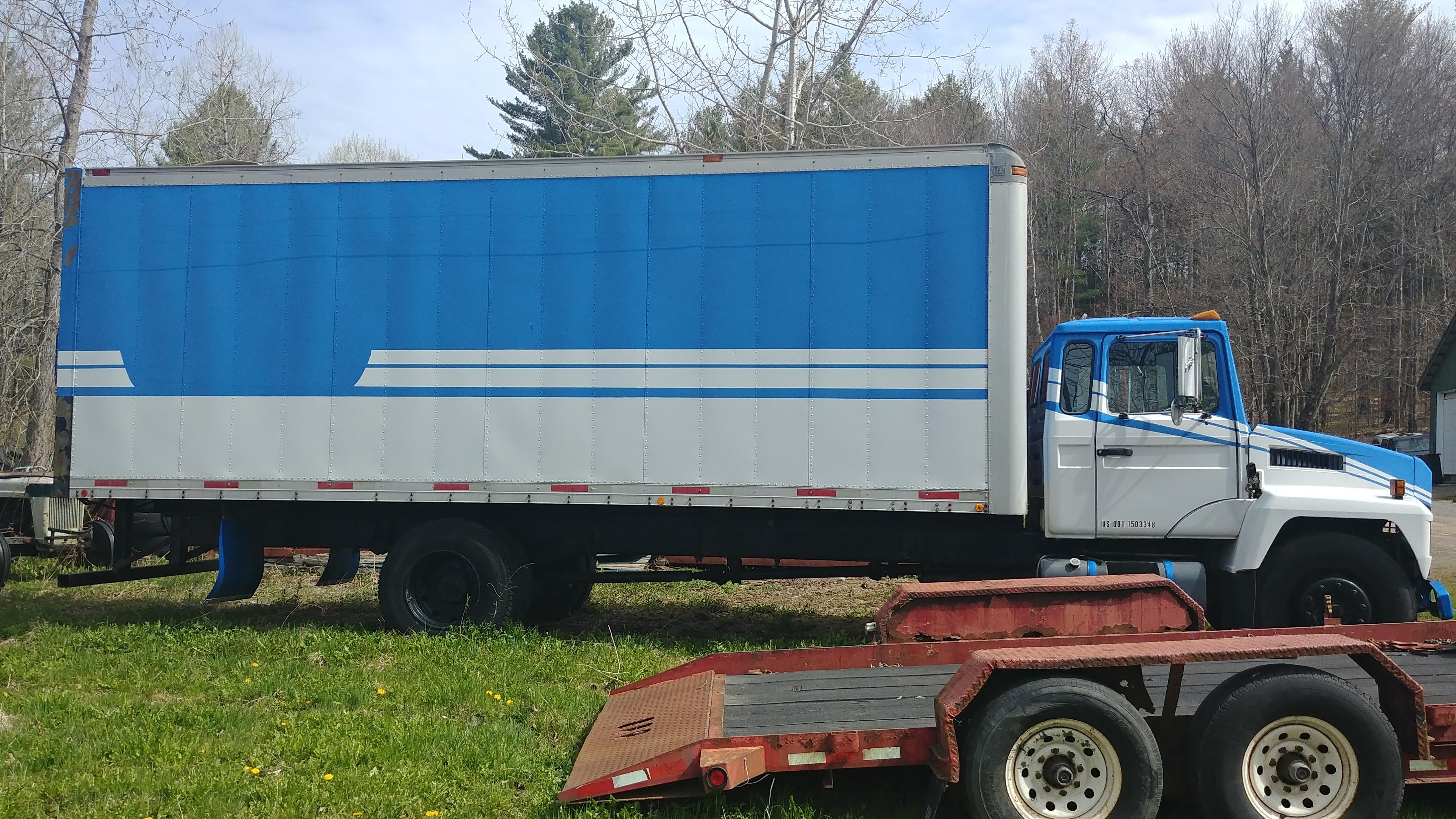

not far from me..... but god oh why god would you ever pick a midliner to build something on. chassis parts are beyond unobtainable and if it has juice brakes or air over juice they are junk. worked on many and a few with air leaks and parts are non exhistent. youd be better off finding parts for a 60 year old B model
I know they have there issues but it was cheap and ran /drove good.  Its full air brakes.  I know they are metric air lines and that can be a problem.  I've got $1800 in and I figure the box is worth $600.  I've got a guy who will buy the truck without the box for $1500.  I haven't completely committed to using the truck.  I like the long wheelbase but its a class 7 and I don't have a CDL.  I thought I would throw a B model on it and register as a B.  If I found a decent running diesel B for $2500 I would Probably sell the Midliner and look for a 5th wheel trailer to pull my stuff with.  Cool to see Mack man near me.

Thanks Paul,
I'm not totally commented to the Midliner chassis, but it was cheep and I could use the storage box.  I seen a few of these trucks sitting around.  I spoke with someone who works on these and said the engines are great!  And like you said just order your airlines off the Web because they are metric fittings.  When I first looked at the truck it would crank fast enough to fire, so I ordered a starter off the internet for $100 shipping included and it worked perfect! The frames have a tendency to be prone to rust/ delamination post 1996.  Also thought about a school bus frame, but couldn't find one as cheap as this was and there all automatics.  Not too keen on the automatics.
