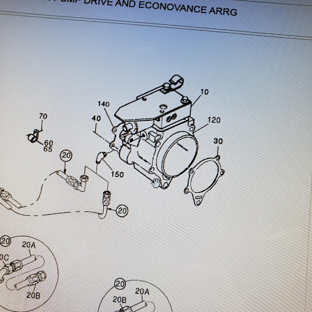

Truck idled rough at low rpm, thought it was fuel problem. But it was timing sensor on fly wheel. Now when my truck hits 1800 Rmp its doing the same thing at a higher rmp and runs perfect at lower Rmp. Mack dealer told me it was the Econovance. They told me the housing was the problem and mack doesn't make one anymore. I found one in a junk yard. But is there another company that makes that housing or is there a way to replace it. I called all over the US today and found one. Why does Mack have this part on their trucks and no longer make it.

Was told today by the Mack dealer that they have not took off the encovance because the truck would be dead in the water and wait until I found one to rebuild. Does that sound right?  They told me that if they go out it's more than likely the housing. I asked about a rebuilt kit they said it's better to wait to take it out. Drove truck home today, drove great till 1800 rpms. Then went to shit. I can still work truck till I get that one in. Be a turd pulling if I cant get over 1800 rmp. But I got to work it.  What have other people done to fix this problem? Replace the motor, fuel system or what? All help needed thanks. He checked the line going to it and the solenoid. Both are good. I trust the mechanic, he has done wonders in the past for me. So not doubting the Mack Mechanic.

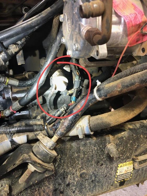

Hello, I have an 04 mack ch613 with the ac460p engine. Monday the truck lost all power and came to cost, still running, but kicking tons of grey smoke. Got it towed and ended up replacing the fuel pump since the old pump wouldn't draw water from a bucket with a 1ft hose. New fuel pump installed, fired up with rough idle and more grey smoke. When the turbo actuator got air it closed the vanes and the truck killed, getting way too much fuel. If i unplug the variable turbo and speed sensor plugs, the truck runs. A little rough on the low end but can still drive smooth on the highway revs up solid with no smoke. I just came across this part and it sounds alot like the issues I'm having. The truck has 1,002,000 miles so very possible it's never been touched. I check position sensors and fuel timing sensor. Replaced the fuel timing sensor, checked fuel relief valve, opened all fuel lines and check for obstructions, hooked up to computer with no codes to guide me. Trying to avoid a visit to mack for $175hr. Tomorrow morning I'll check into this further, but i need guidance. Anything to help diagnose or test or any other direction to go... oh i also tried jumping ground cables to various spots just to make sure. Thanks in advance!
