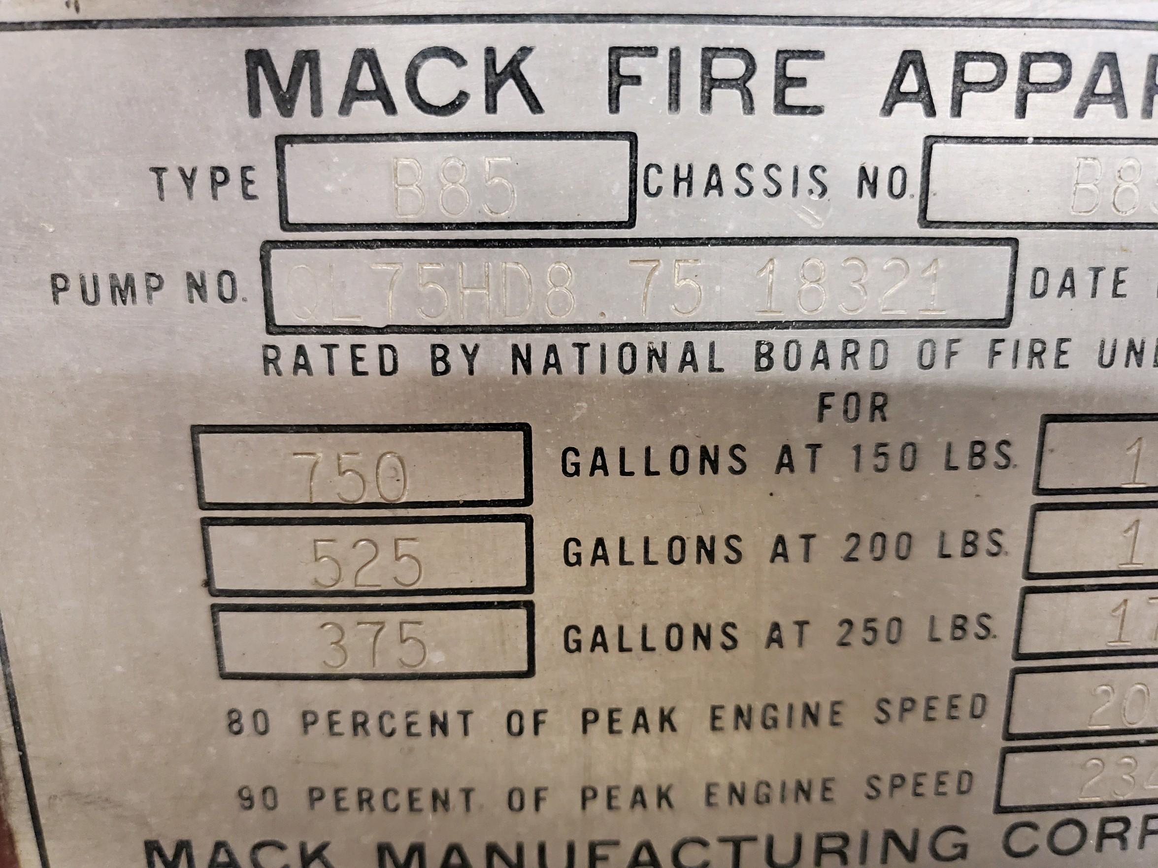

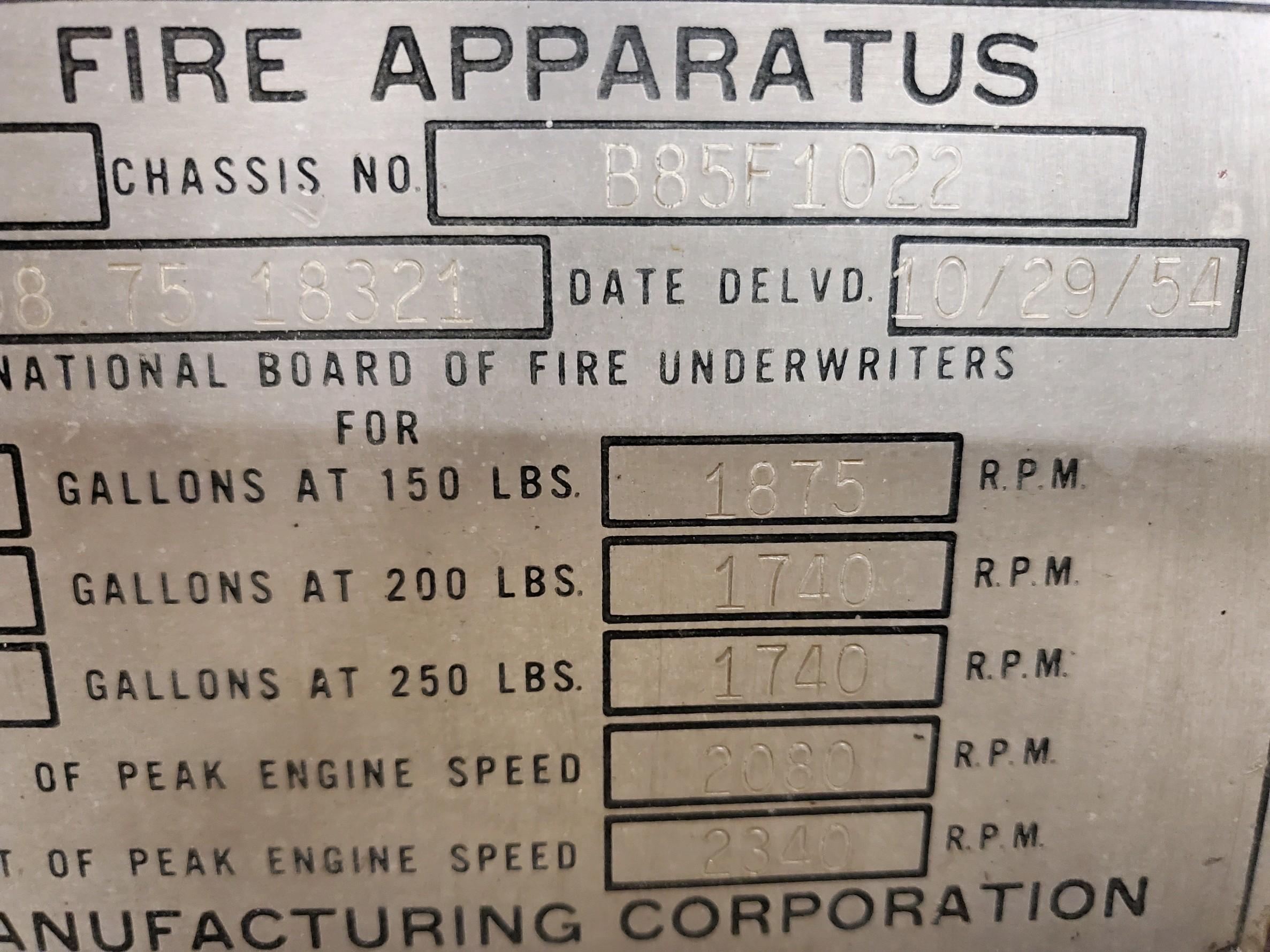

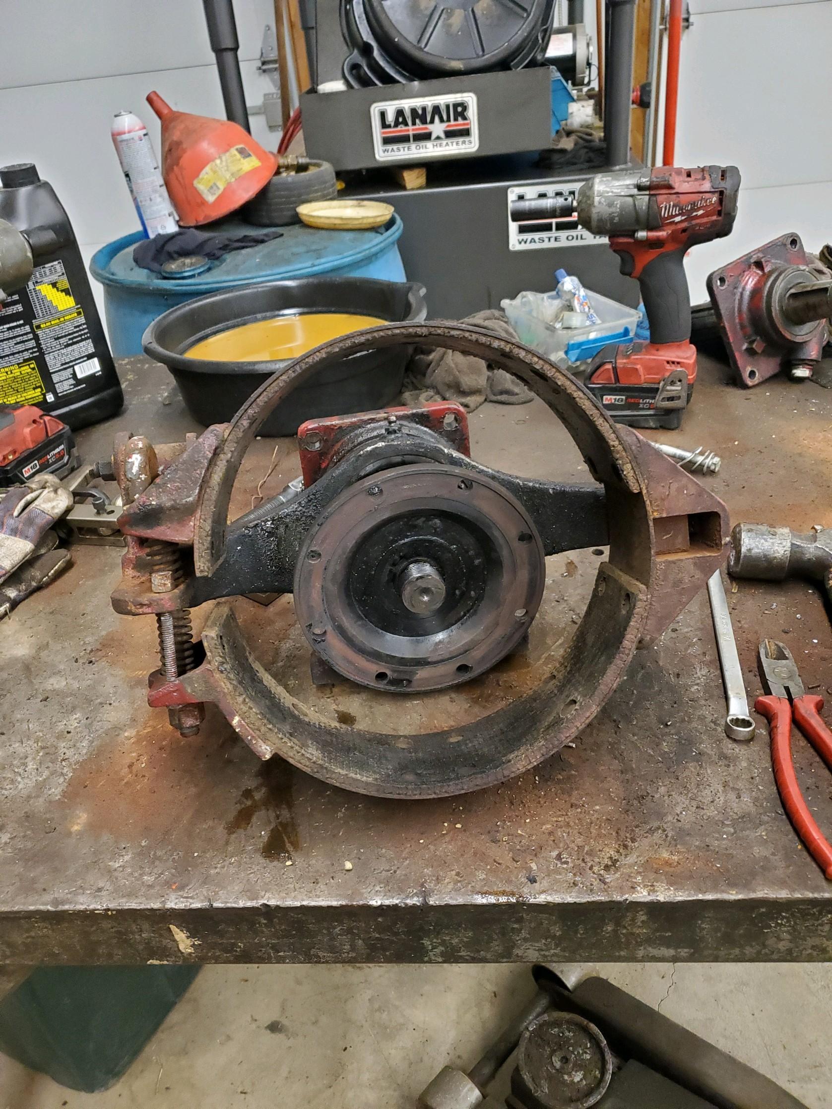

Last year we bought a 1955 B-85 open-cab pumper that had been stored uncovered for over 30 years in an old building. This engine has significant sentimental value for my family. When initially recovered it ran and drove. Our local heavy truck mechanic (also well-versed in fire equipment) has been working on it this year. Electrical issues and other problems were solved. He's been working on the transfer case for some time. It was full of water and bearings. He called tonight with the news that it is shot, and there are no parts. I am not a mechanic, but here is what he told me it would need:
     Input/Output Seals,  Output shaft assembly, Driveshaft flange, or an entire Rear Output assembly. Otherwise, this rig is dead in the water.  The pump is a Hale QL-1. He sent me some pictures and I have attached them.

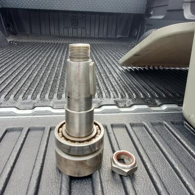

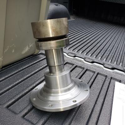

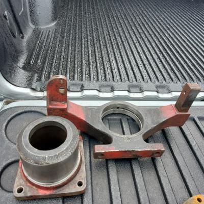

A big thank you to all who have responded and helped us along the way with this project (especially Firemack!).  Much progress has been made. We had several parts re-machined and some made new via CNC. Reassembly is in the new future.
On another note, if anyone needs a shop for machining, welding, cutting, or CNC work I cannot say enough good things about Dave Amon of D&M Fabrication in Jerseytown, PA. (570) 594-6727.  Dave has a work ethic that has to be seen to believe, and a love for old things being made new. He took on our project and turned it out in three weeks and far exceeded our expectations!
Again, thank you all!  More to come...
