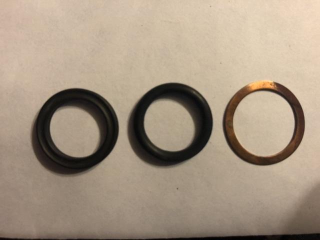

Not sure if you ever got this fixed. Here are the seals I got for my old R. There’s a quad ring, an o-ring, and a copper washer. Got these from City Diesel in Knoxville, Tennessee.  Was pretty easy to fix.
