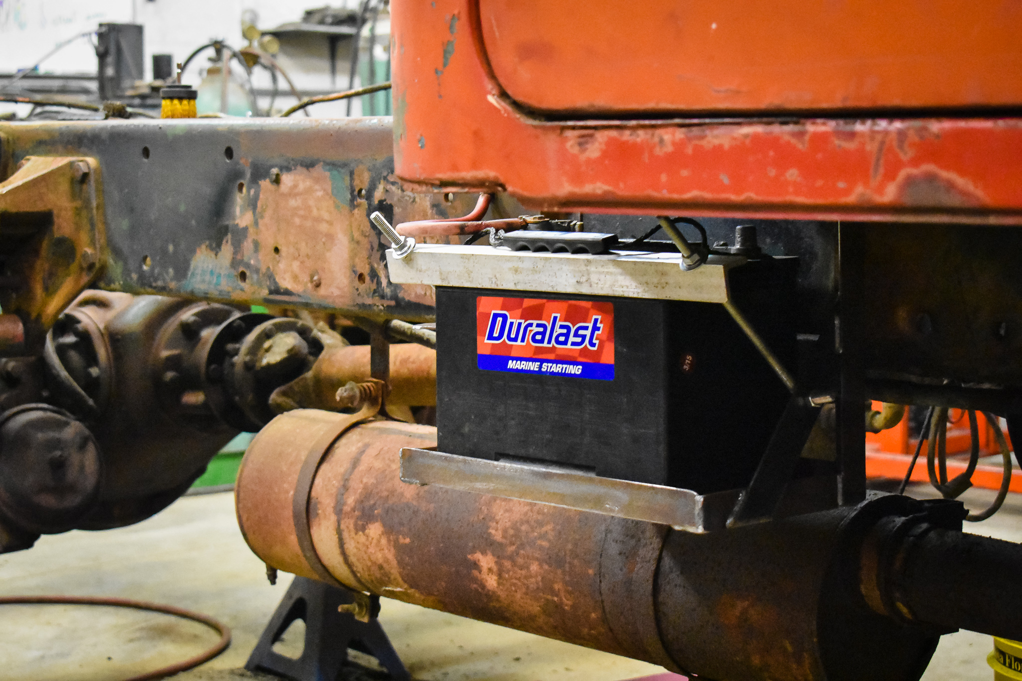

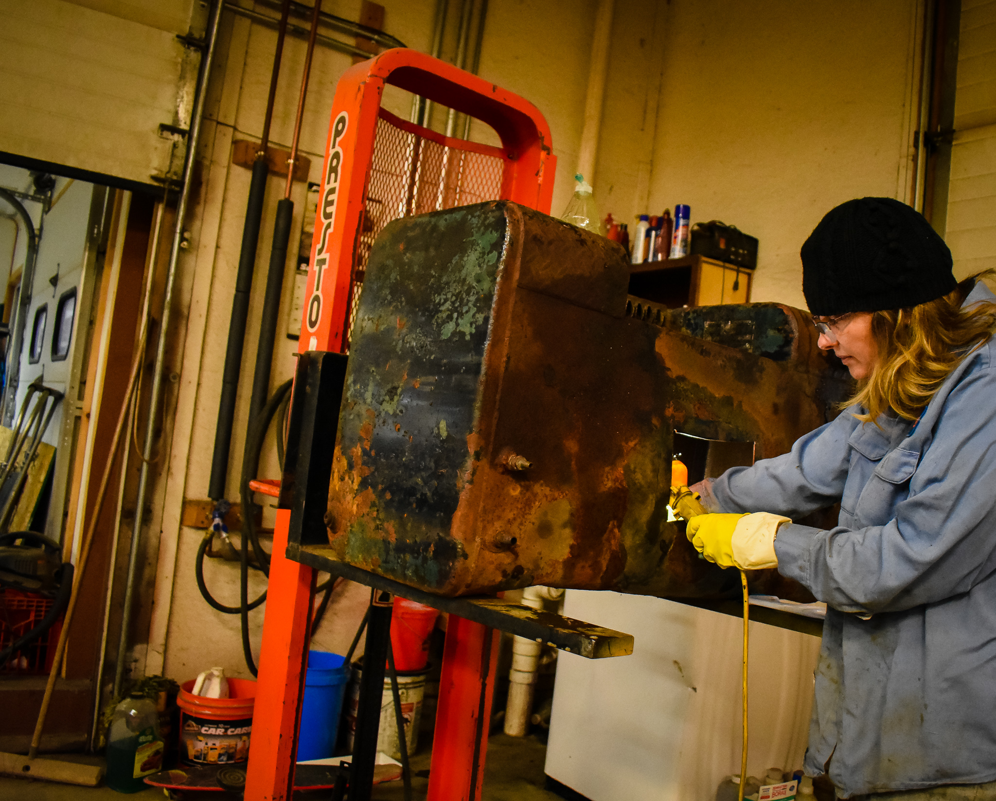

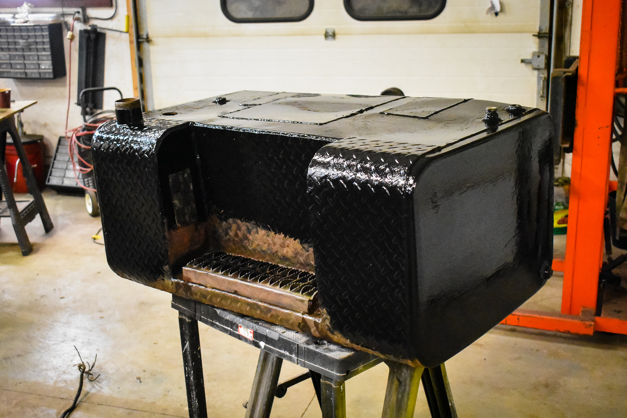

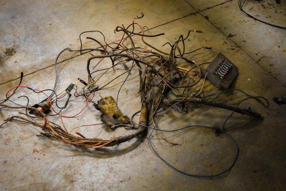

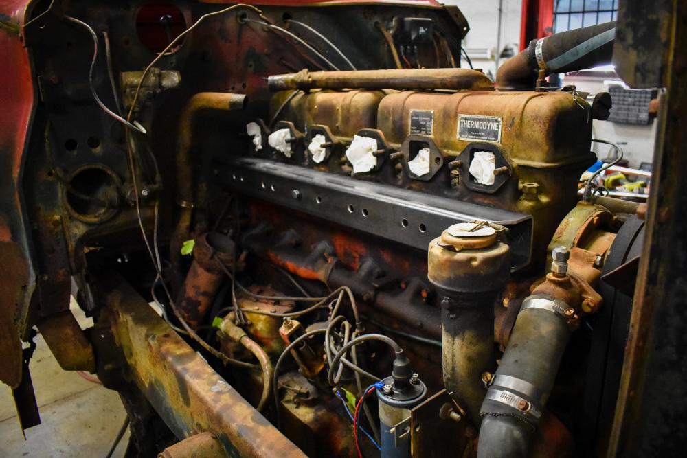

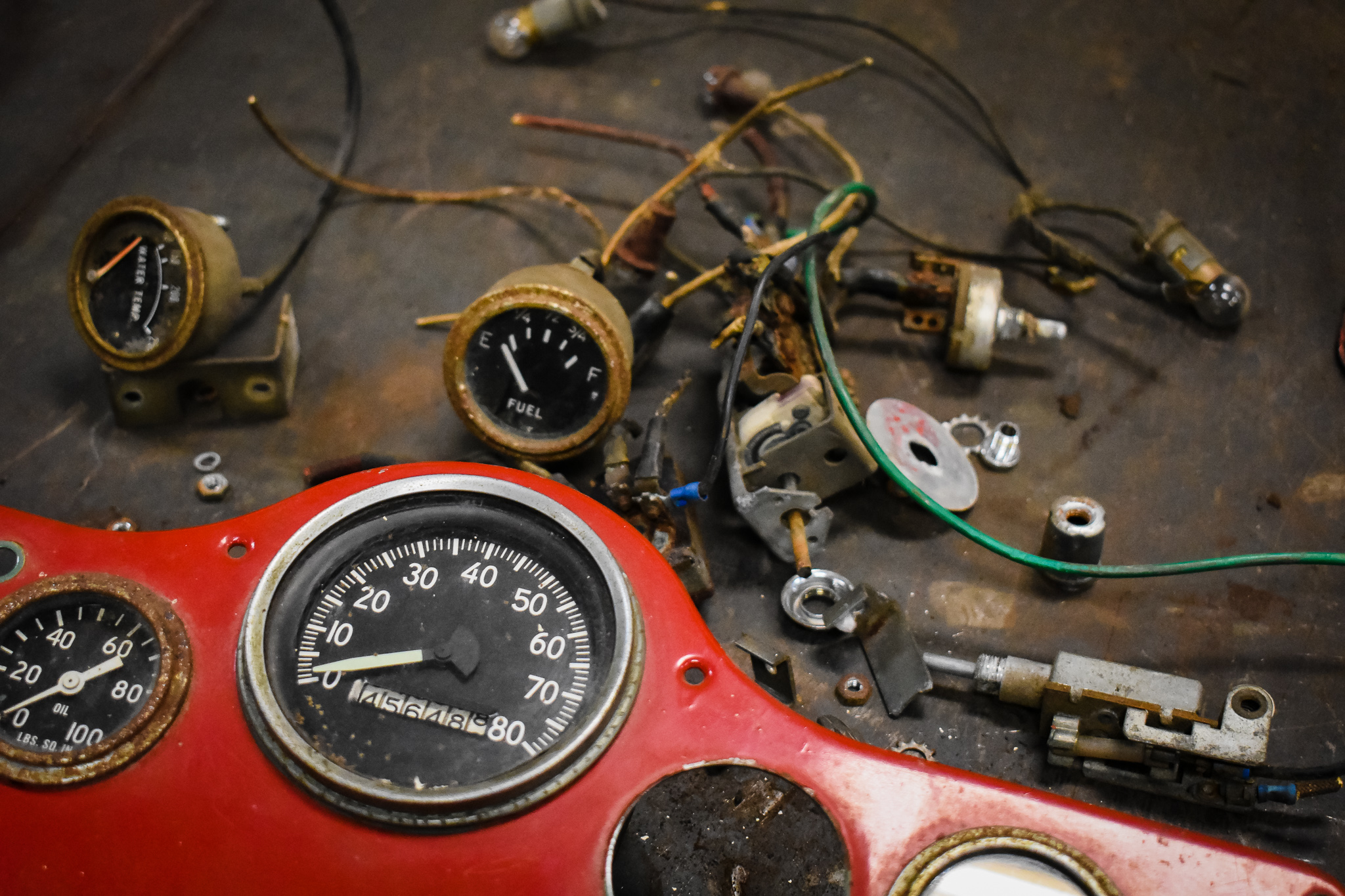

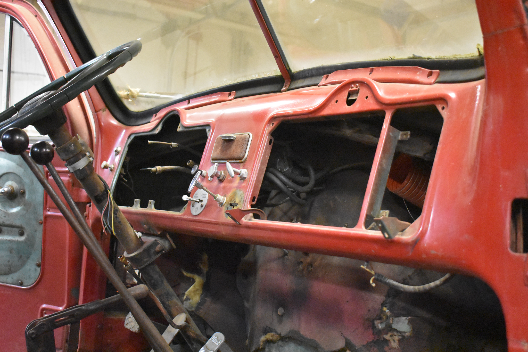

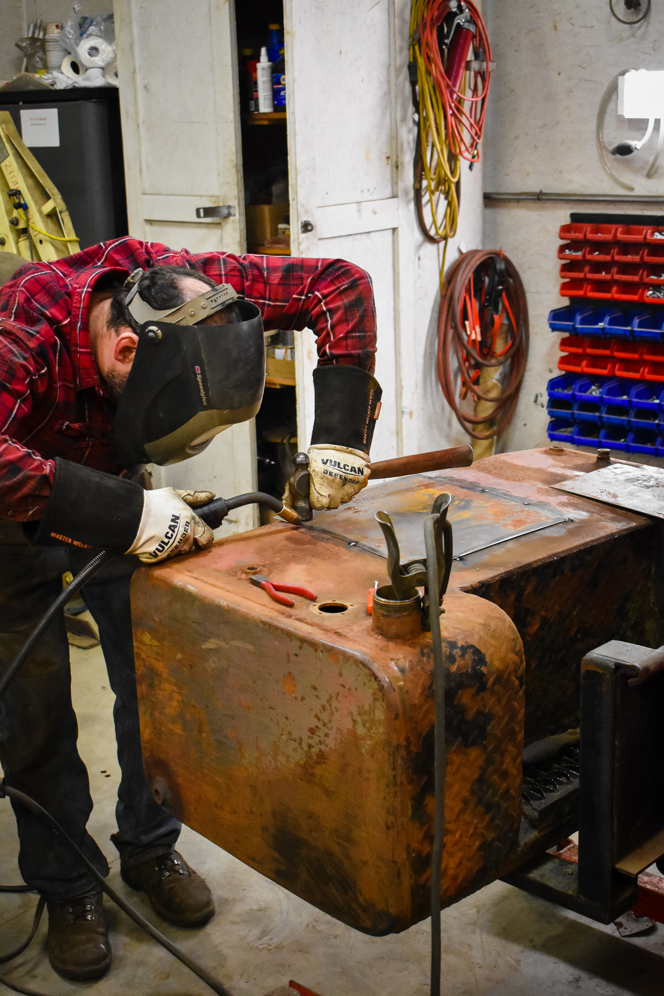

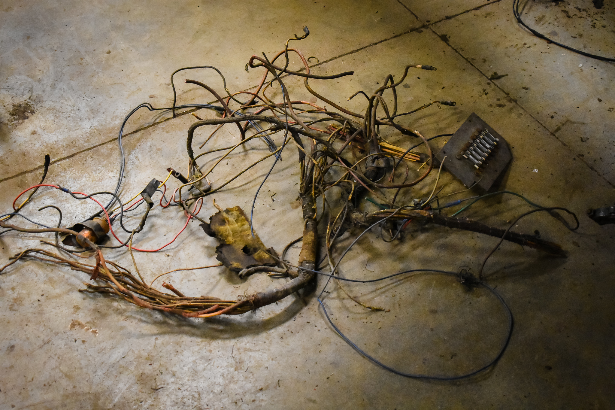

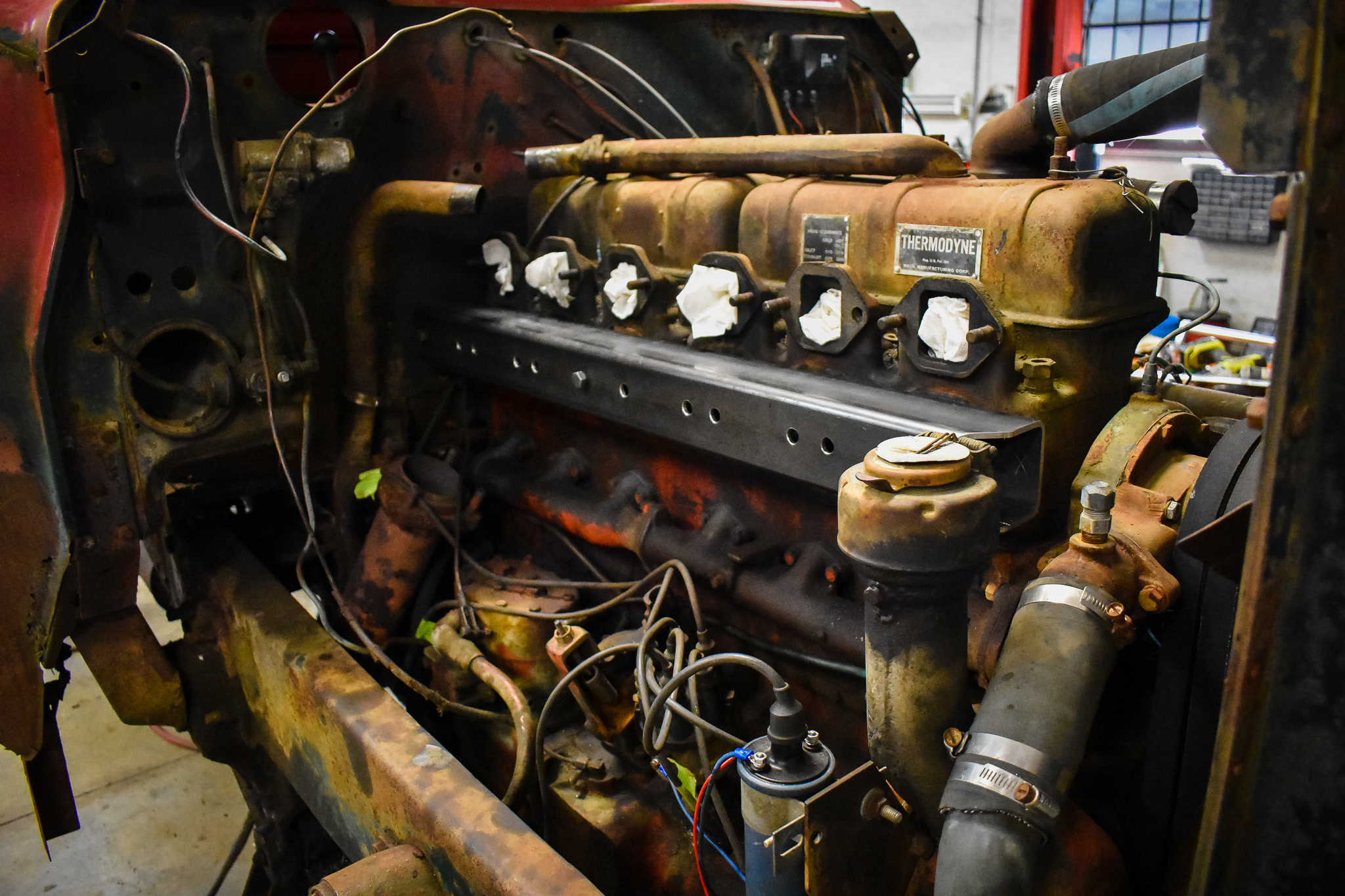

Got the fuel tank prepped and first coat of paint on last night!  We stripped out wiring, took out gauges that need to be replaced, and continued the work to simplify the systems.  We finally have all brakes lines that will no longer be used (since we're not hauling with her) removed and/or capped off.  Piles of old wiring have been eliminated so we can build back as needed with the essentials.  Installing the shut off switch on the battery so we don't have to keep disconnecting it, though the electrical fire hazards should have been largely eliminated last night.  Thinking about painting the interior of the cab something that closely resembles the original green.  What do ya'll think?  I've seen some suggestions of comparable colors somewhere online.
If you have a half decent piece of paint from the interior left you could just get it colour matched
No one (including the so call experts) will know if it isnt spot on as it cant ever be put exactly bedside another cab interior
Paul
Paul
Both interior door panels have original green paint on them (everything else has been painted over).  Good suggestion, Paul.  Thanks!
 Omni (PPG) Acrylic Enamel #MAE45735 (Profit Reading Number 1335) for interior panel restorations. I had it scanned from under an ''over speed'' warning tag on a dash panel. Seems to be a good match.
Original Kirker Paints number was 812 (812A) A good body Supply shop can cross reference to DuPont, PPG or other paint brand.     Paul
