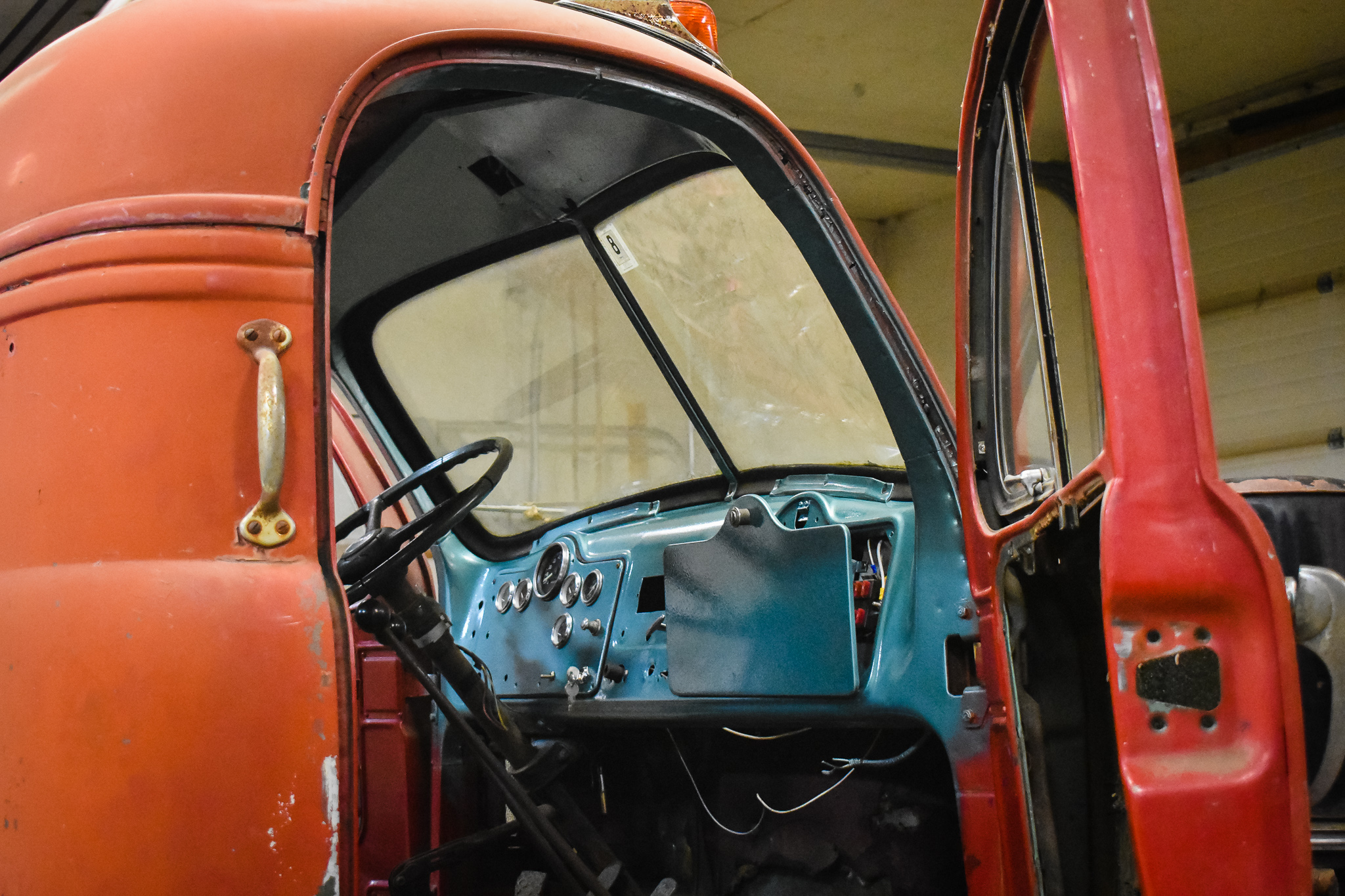

I'm back!  The shop has been set up for paint as my husband has also been working on his Freightliner.  The Mack has been patiently waiting under her parachute cover - and I spent last week recovering from some bug (negative COVID test, yay!) Tonight I removed the instrument panel and got the back painted (flat black).  Tomorrow I'll spray the Verde Green!  New instruments are ready to install.  Fuel sending unit arrived over the weekend so that will get installed tomorrow and we'll put some 100 low lead in the tank!  (Parachutes for covering up and Av gas courtesy of my pilot/A&P mechanic husband).  One more week of school (I'm a teacher) and we're on holiday break.  I foresee some momentum coming!  When I was digging out Christmas decorations from storage, I discovered plenty of leftover marine grade vinyl from a boat we built about ten years ago.  There is enough to recover the seats - in the right colors, to boot!  WIN!

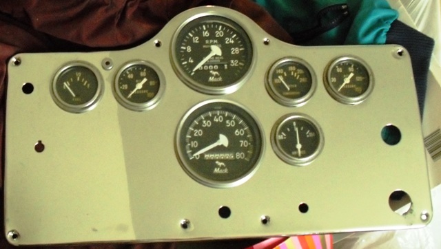

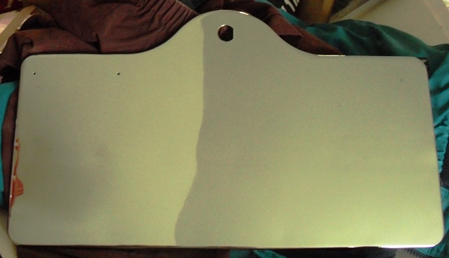

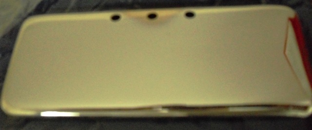

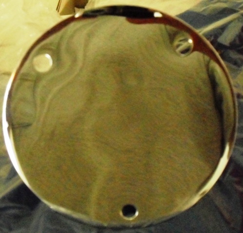

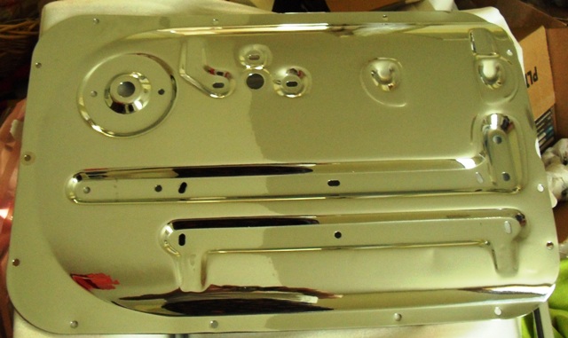

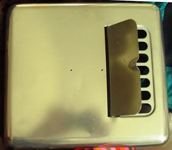

After my divorce the only thing that I wish had turned out different was that I could have kept my B and finished it.  I had chromed the door panels, dash panel, ash tray front, the glove box front & powder coated the front panel of the heater box. Yes that is a NOS just out of the box, no miles, speedo and a NOS just out of the box, no hours tach.
Thats a lotta bling, small price to pay for ones freedom😏
Paul

Viruses be damned, I'm plugging away!  Last night I put the dash panel back together.  I took apart the speedometer which was full of paint chips.  Upon disassembly it became obvious that the interior canister had been painted and the paint didn't stick!  I got it all cleaned up and reassembled.  Kept it along with the air pressure gauge and replaced the others (which weren't working).  I'm happy with the result!  More frame painting this week.  The fuel tank and all components are up and functioning and there's fuel in the tank!  She's getting really close to a test drive.

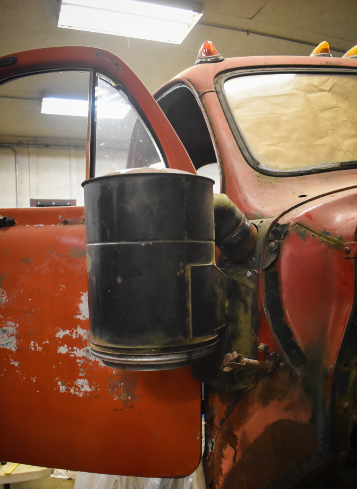

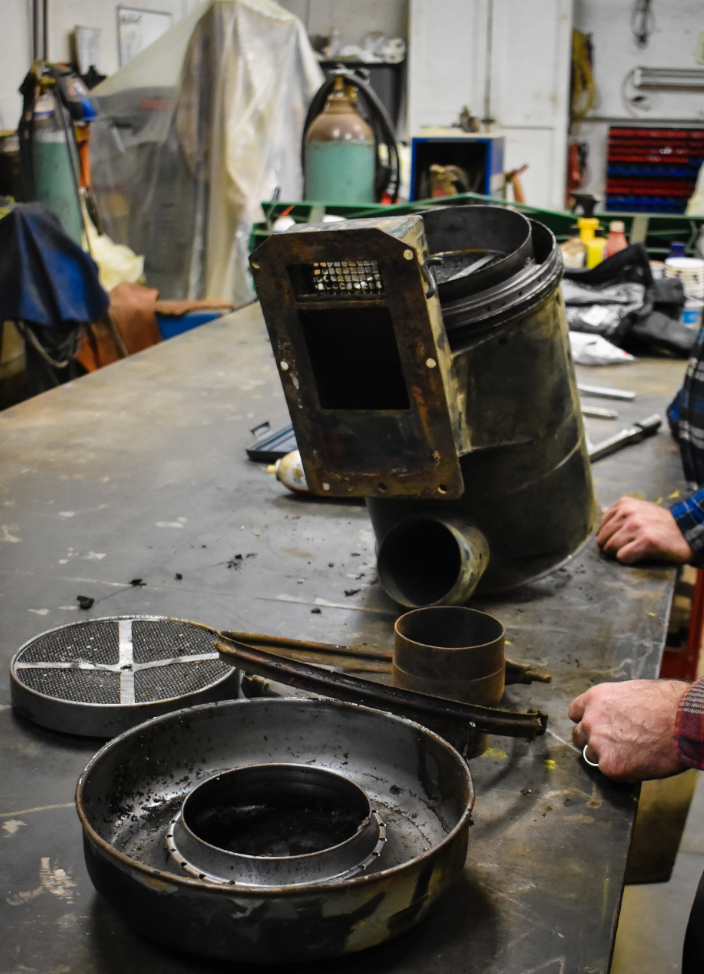

Friends,
Talk to me about taking apart the air cleaner!  How do we disassemble it?  It needs a good cleaning and it's not appearing intuitive.  The rubber fittings were all shot, but we got it retrofitted up and ready for scat tube, etc...but it's got to come apart for a good clean.  The attached picture is as far as we got.
Edited by SkippyMack
At a guess thats as far as you go
Scrape all the dirt out of the oil can on the bottom
Do not steam clean any of it as it will cook the dirt on the wire,  just wash with petrol or as you lot call it gas
Dont use water as it might then rust
Anyway thats my thoughts
Paul
Paul
Thanks, Paul.  So the inner portion doesn't come out?  Does anyone know the specs on oil for this cleaner?  (Type/amount/procedure)
