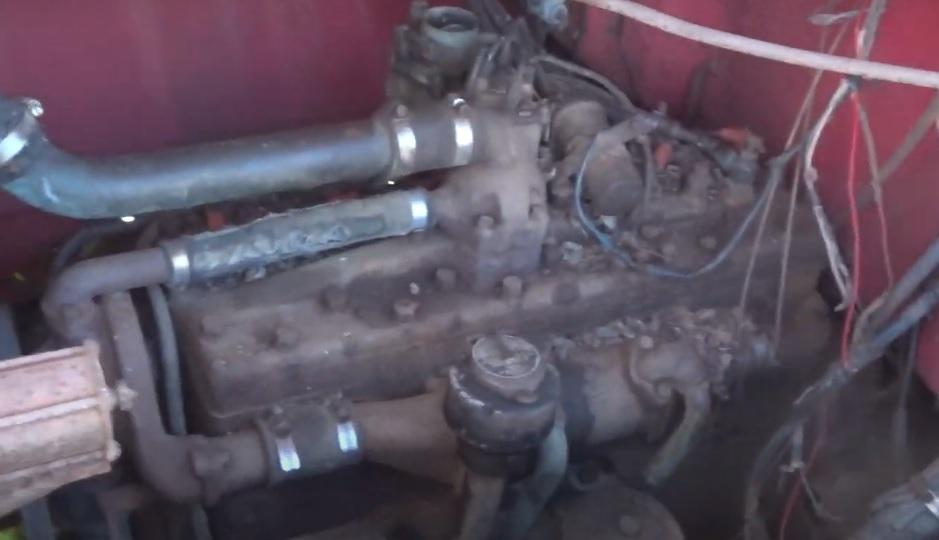

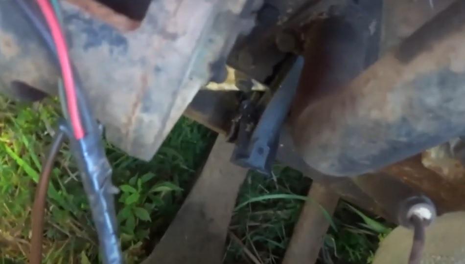

I found the hole...

429 Ford and a c6 not that hard to replace with updated drive train good luck... bob
Kind of had that thought, but I think I want diesel.  My father had a 1974 International Fleetstar with a 6-71 Detroit.  The best sounding engine IMO.  I know they arent power houses and they leak oil,  but they are tough and would be cool.
Oh absolutely you need to do what you want to do that was just a suggestion easiest way to cure the problem plenty of parts around just a matter of changing a couple of motormounts driveline shopIf I were you I would start asking around especially on here p.m. Chevy 41 is usually the best source.... good luck... bob

all depends what you wanna do with it. 401 is great to drive around empty or haulin a load of potato chips. otherwise they were underpowered and overworked. motor swap or chassis swap. few things come to mind if you just want a driver is an 80s or 90s ford F600 or bigger, usually had a 8.2 diesel or a 3208 cat or a B cummins if your lucky
The 5.9 Cummins would also be a good choice..  Here is a link to Tom Millard's conversion in his 1955 Brockway 154. :: http://www.brockwaytrucks.org/messageboard/viewtopic.php?f=1&t=4952
He also told me he got 13 MPG bobtailing from Scranton PA to the ATHS Lexington KY show and back.

What do you guys think about DT466?  They seam to be plentiful and relatively cheap. I would like to keep my original 5 and 2 speed.  Will I need to use the bell housing from the DT or will the EN401 bell?
You can check out this thread.  The builder used a DT466/Allison combination.  I don't have an answer on the bell.  DT466 are definitely plentiful.
The thread has some good info but is "bombed" because of Photobucket changing their rules.
Could I run an 8.2 against the little duplex?  I have a silly idea...What if I put a 300 6 in it.  125hp and 250ft/lbs, about the same as the 401.
