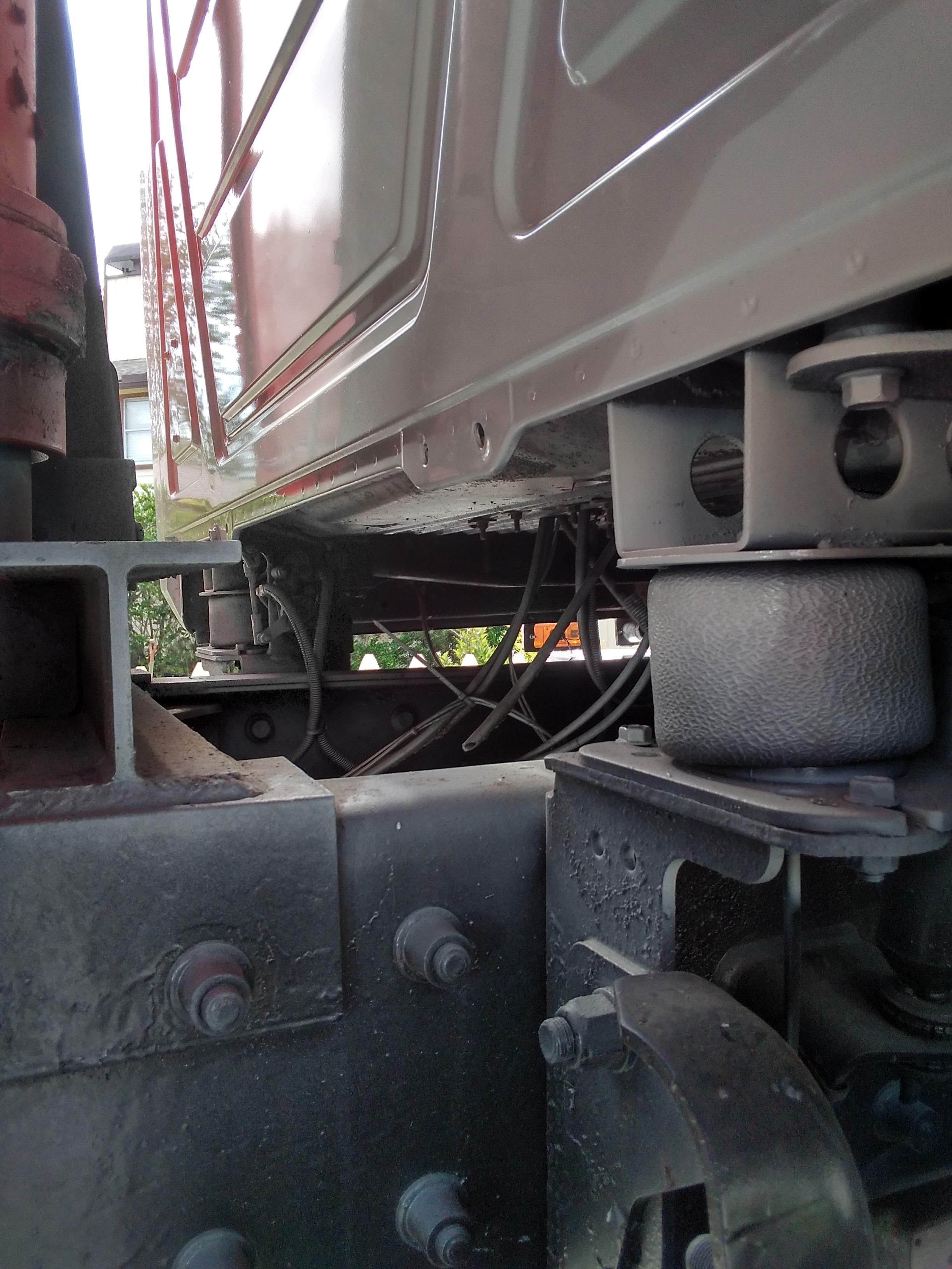

Sounds like the cab has air ride and the air bag for the cab isnt inflating
Maybe a linkage has dropped off valve or the valve is fault
Hop under the truck and look at the cab for a deflated air bag or bits missing or hanging

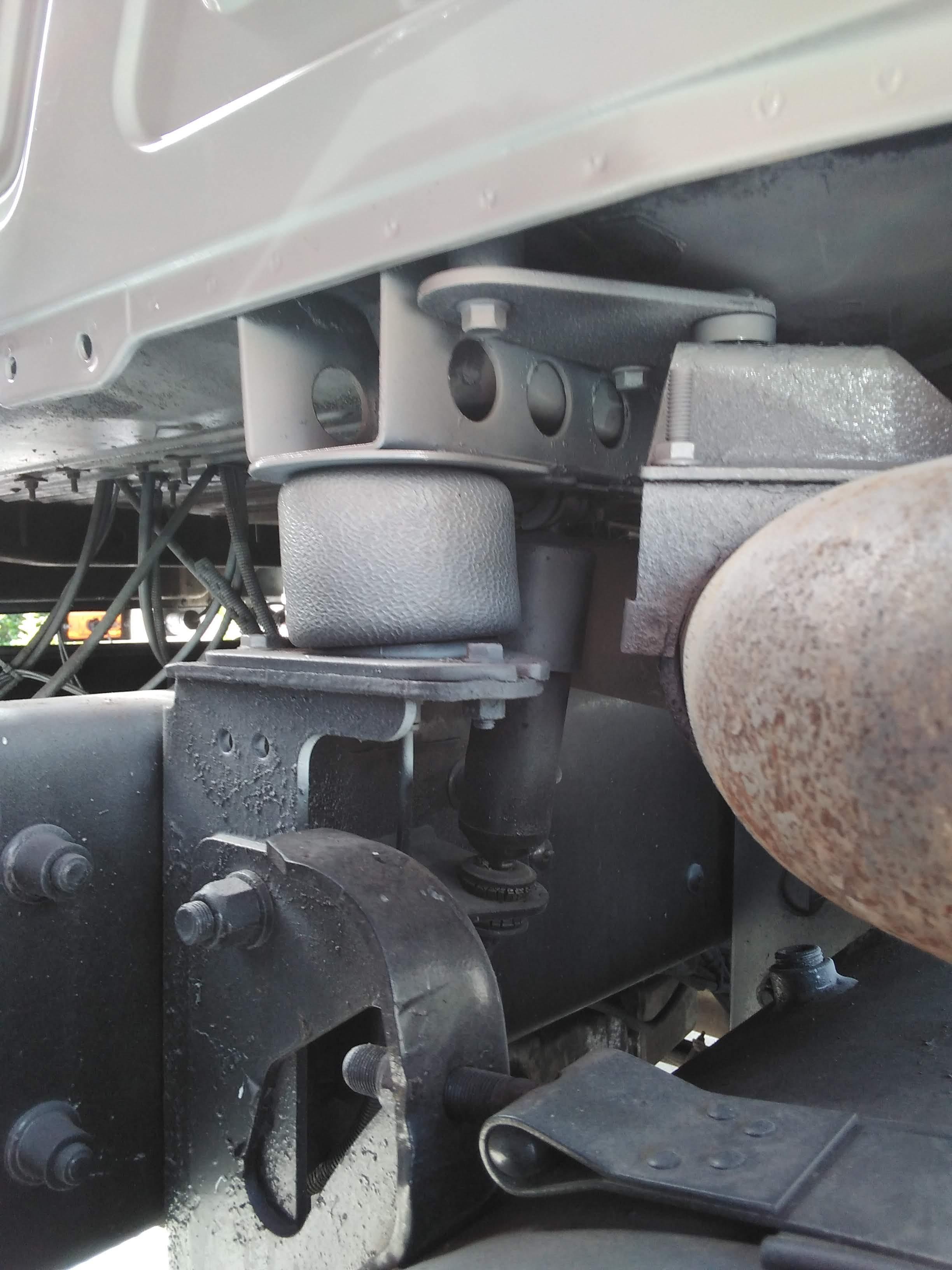

It should have air ride similar to this photo
And it should ride pretty good when working
The way describe that your truck is looking like its broken in half when parked would lead me to think the cab air ride isnt working at all1996-Mack-CH613-Cab-Mounts-o-TM18-Hn-B3q
So I would check the air bag shown in the middle of the picture to see that its inflated

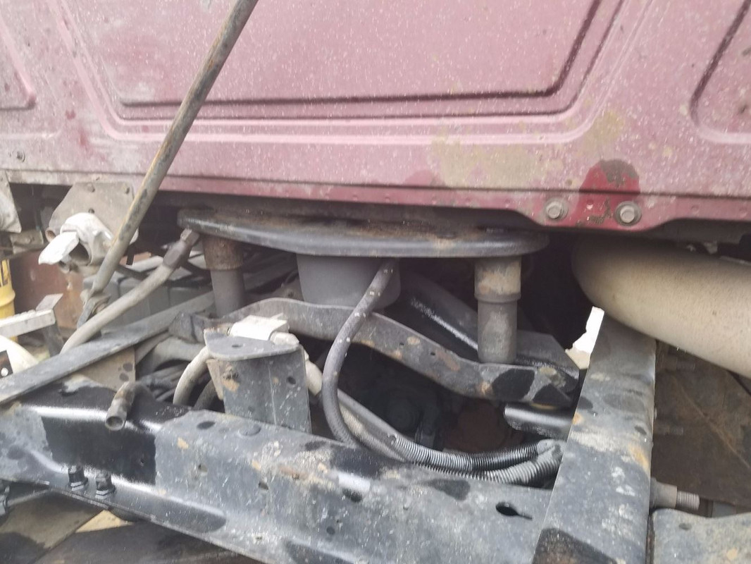

Those pictures are of air ride cab air bags.....with NO air in them (lol)  It looks like the link is still hooked to the valve, so why there's no air in them ???   could be the valve or a leak or air supply is restricted for some reason. Get bags that hold air and replace those shocks. The bushings suggest they're old and shot which means there's a  really good chance the cab mounts are wiped out too. Correct those issues and you'll see instant improvement in the ride.
https://www.bigmacktrucks.com/topic/63810-better-ride/#findComment-459314
if the bags deflate with engine shut off, you have a leak somewhere. if they stay deflated with engine running and air at 120lbs, there is a problem with the valve or link to the valve.
https://www.bigmacktrucks.com/topic/63810-better-ride/#findComment-459317
Is air still getting to the bags at all or is there a crook valve, if air is getting there and a bag is blown or a hose is damaged, fix that
As Mark T says "fix them and you'll  see a instant improvement i  ride"

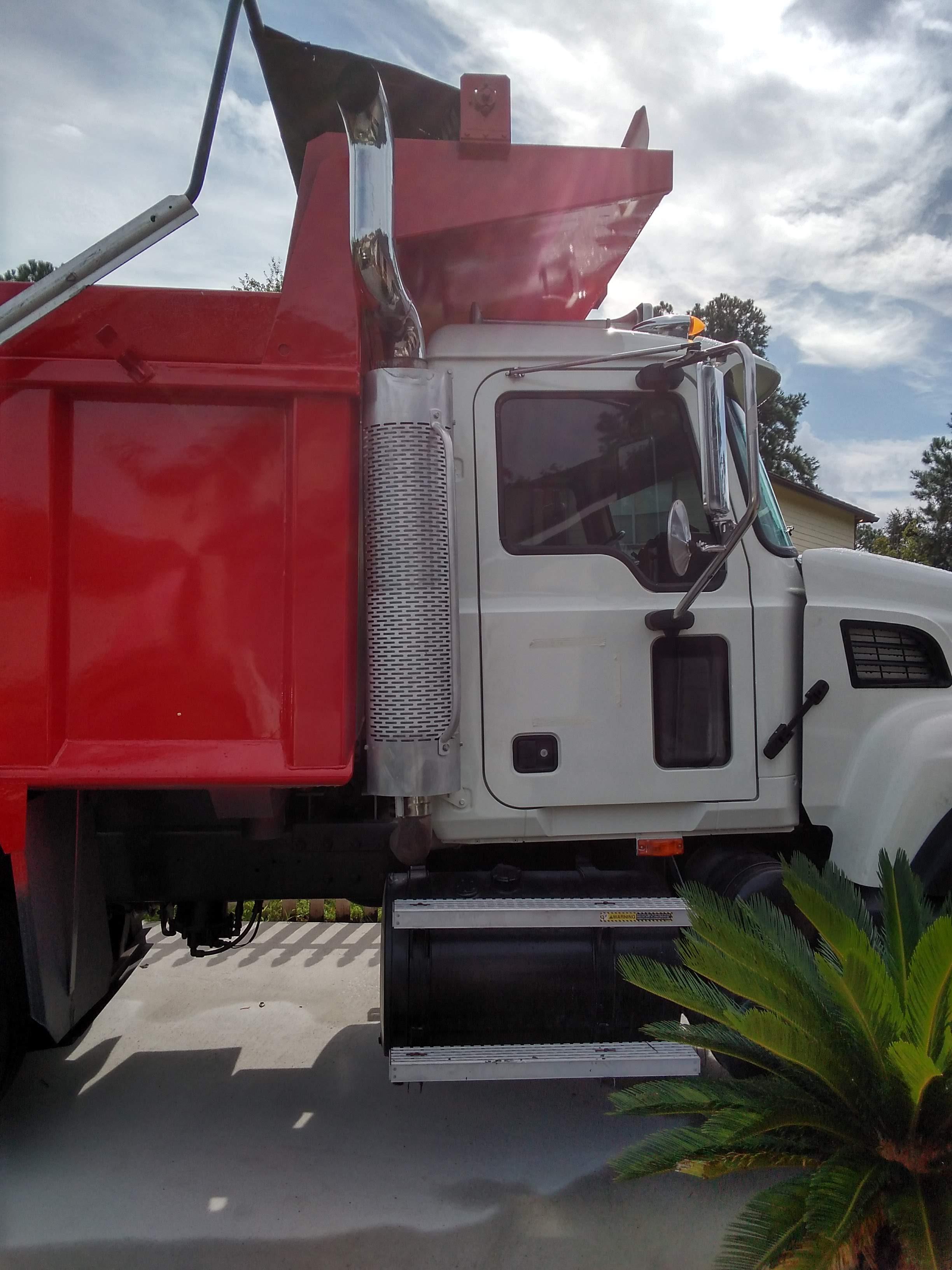

The bags deflating overnight is nothing to worry about.  What suspension does the truck have, are there flat spots on the tires, how long is it?  We have 2 trucks with 44s and the 1 that is about 18" longer rides great, the other shorter truck empty feels like a bucking bronco.

22 hours ago, danny123 said:
I'm guessing changing the shocks maybe improve the ride, they look bad..
It certainly won't hurt; describe what's "rough" about how the granite rides. Knowing how it feels tells us a lot.
