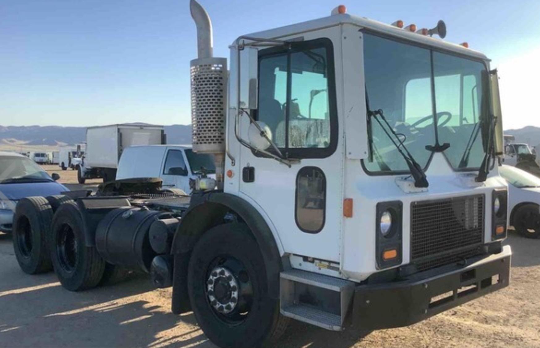

Hi All,
I have a new to me MR688S Postal 4x6 COE Tractor 2006/7 that they can't get the cab up to tilt, etc...
I'm looking for instructions and or a design diagram or how the system works, like, is it a manual pump or electric/hydraulic, spring lift,
is there a lock switch/lever hidden somewhere, etc...?  Also, any troubleshooting info, any common problems with this system, etc...
I'm picking up the truck on Monday and I'd like to be armed with info to get the cab tilted and be able to check the oil, coolant, belts, etc... basic walk around inspection, etc...

In the pics of the MR, it looks like mine has an electric pump lifting the cab and a manual pump for emergencies.  The batteries were dead from sitting and they jumped it.  I wonder if they just didn't try the lift pump with the engine on.  I'll get into it when I get there - probably something stupid simple.  Bringing a couple gallons of Delvac to get her back to the shop, if needed.

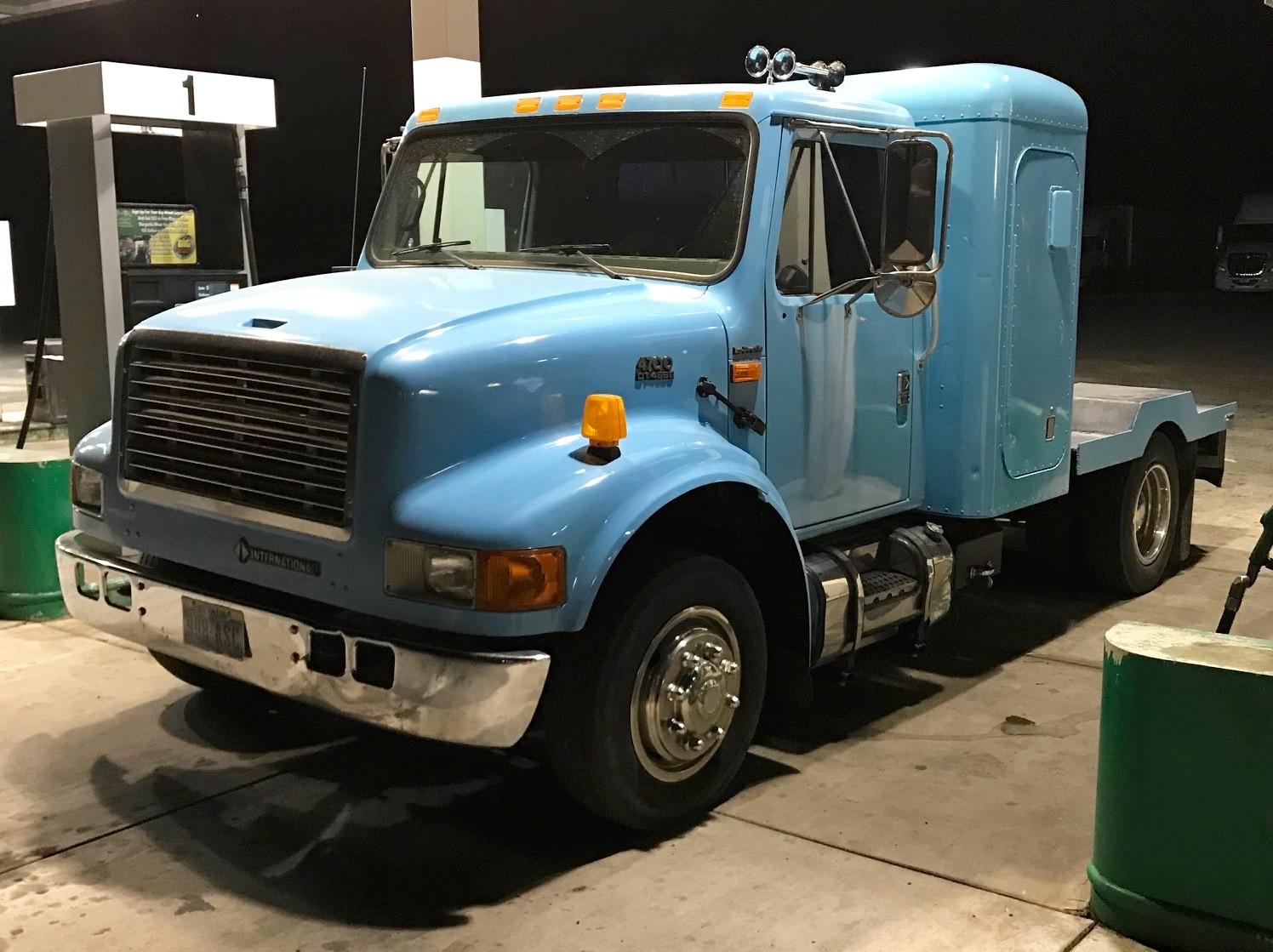

Then, we'll change out all the fluids and go from there.  I'm a driveline first guy, then, we make it pretty.  Here's a pic of my little '97 International 4700 LP.  Just basic stuff, DT466, Allison 3060.  It was T-Boned and pushed into a ditch by a big rig.  I brought it back to a normal working truck and put the sleeper on it so I can stop when I want to.  Been driving it for 5 years.  Intl4700LPwSleeper.thumb.jpg.cafa2a25192f3666651e576ea3906b46.jpgMore later.
