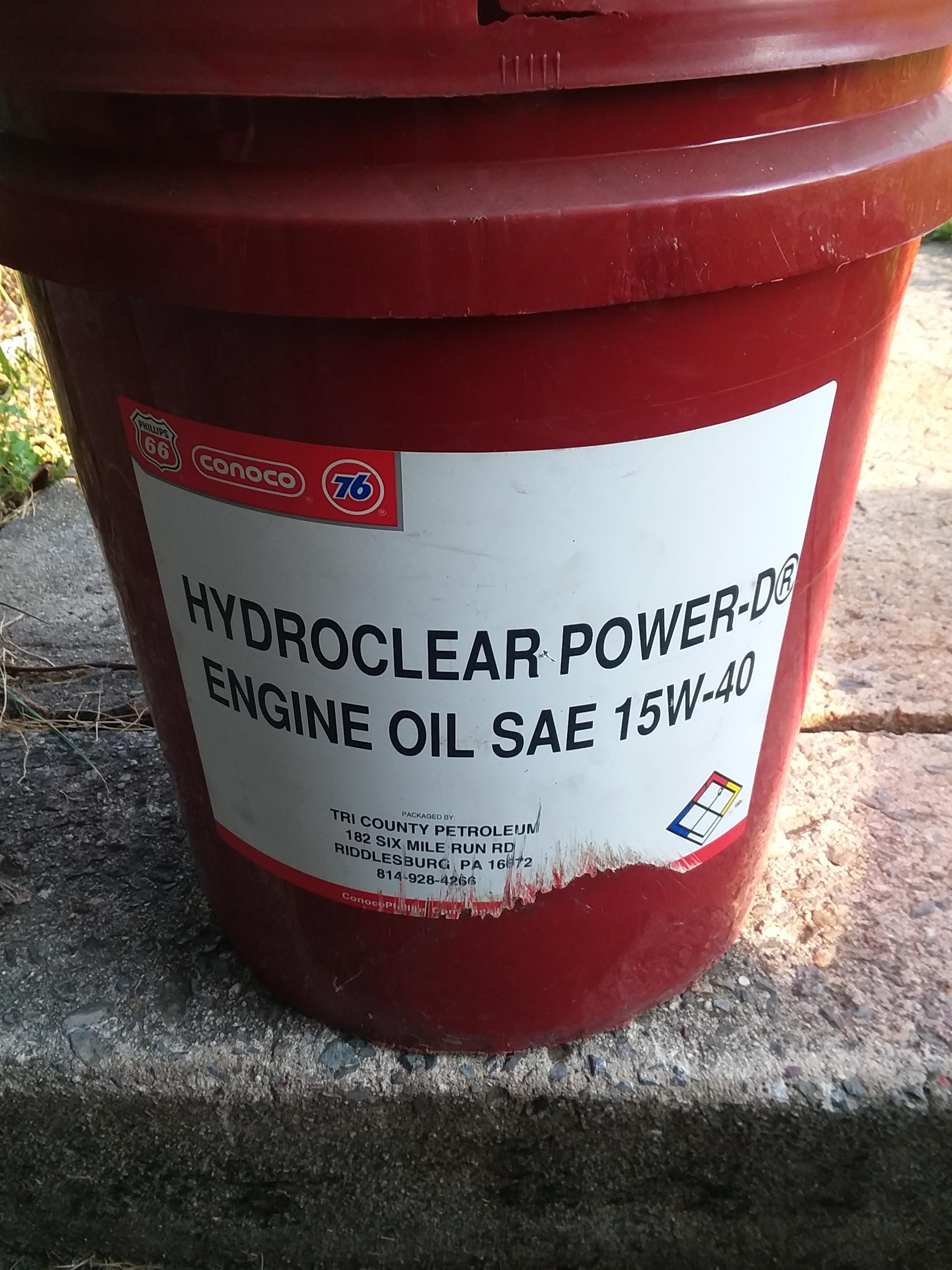

A friend stopped in today and dropped this new bucket of oil off that he's had since he sold his R600. He doesn't remember why he didnt use it. I'm going to do some research on it and see the specs compared to pennzoil. Any problems with using it that anyone is aware of?

Hydroclear Power-D meets or exceeds the requirements of:
• API Service CI-4 with CI-4 PLUS, CI-4, CH-4, SL
• Cummins CES 20078
• Detroit Diesel DFS 93K214
• Mack EO-N Premium Plus 03
• Renault VI RLD-2
• Volvo VDS-3
• ACEA E7-04, E5-02, E3-96
• Caterpillar ECF-2, ECF-1-a
• Cummins CES 20077
• Global DHD-1 ˙MAN 271, 3275
• Mercedes-Benz Sheet 228.3
• MTU MTL 5044 Type 2

Don't think any of the oils will hurt. It is pretty much a personal choice. My END 673 P engine used the Delvac 15W40 before the rebuild. Most of us don't pull heavy trailers or other items today, like our trucks once did, new. Just my observance through the years. As I recall, Freight train aka Larry uses Rotella and has had very good results and he uses his Mack, cross country pulling a trailer.
Ok Larry it is your turn to chime in.
Rotella for me too.
