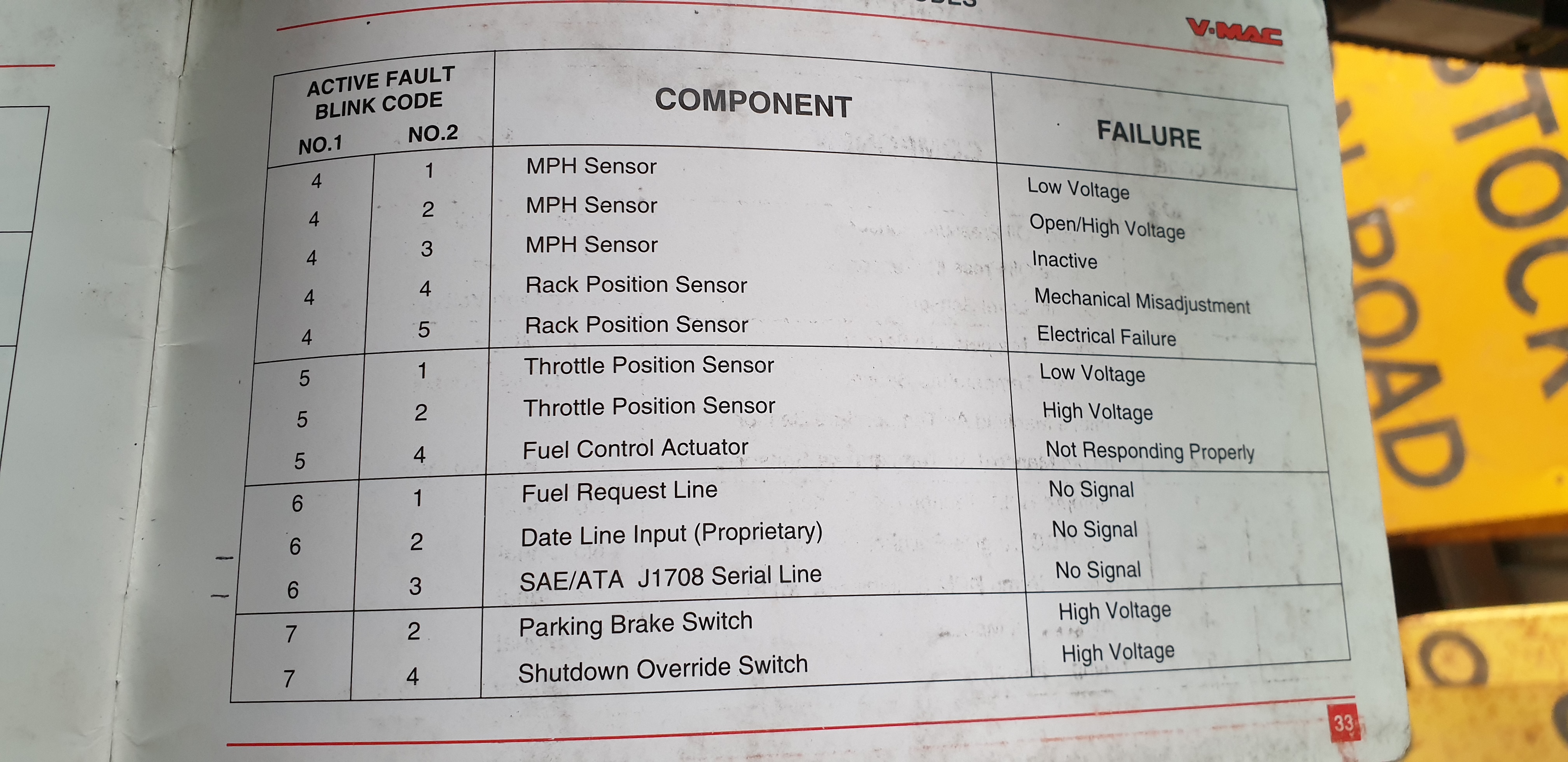

When it happens, I get two fault codes:
6-2 Date Line Input (Proprietary) no signal.
6-3 SAE/ATA J1708 Serial Line No Signal.

I have been given the troubleshooting chart for the two codes from Mack. But the trouble is, that when it is in the workshop, the fault codes are not present, and the tests all show that it is all working properly. If it shuts down in a convenient place in the yard, I can run the tests, but the steps say that you have to turn off the key before unplugging the loom from the ECM, and doing this always resets it and then there is nothing wrong again.
