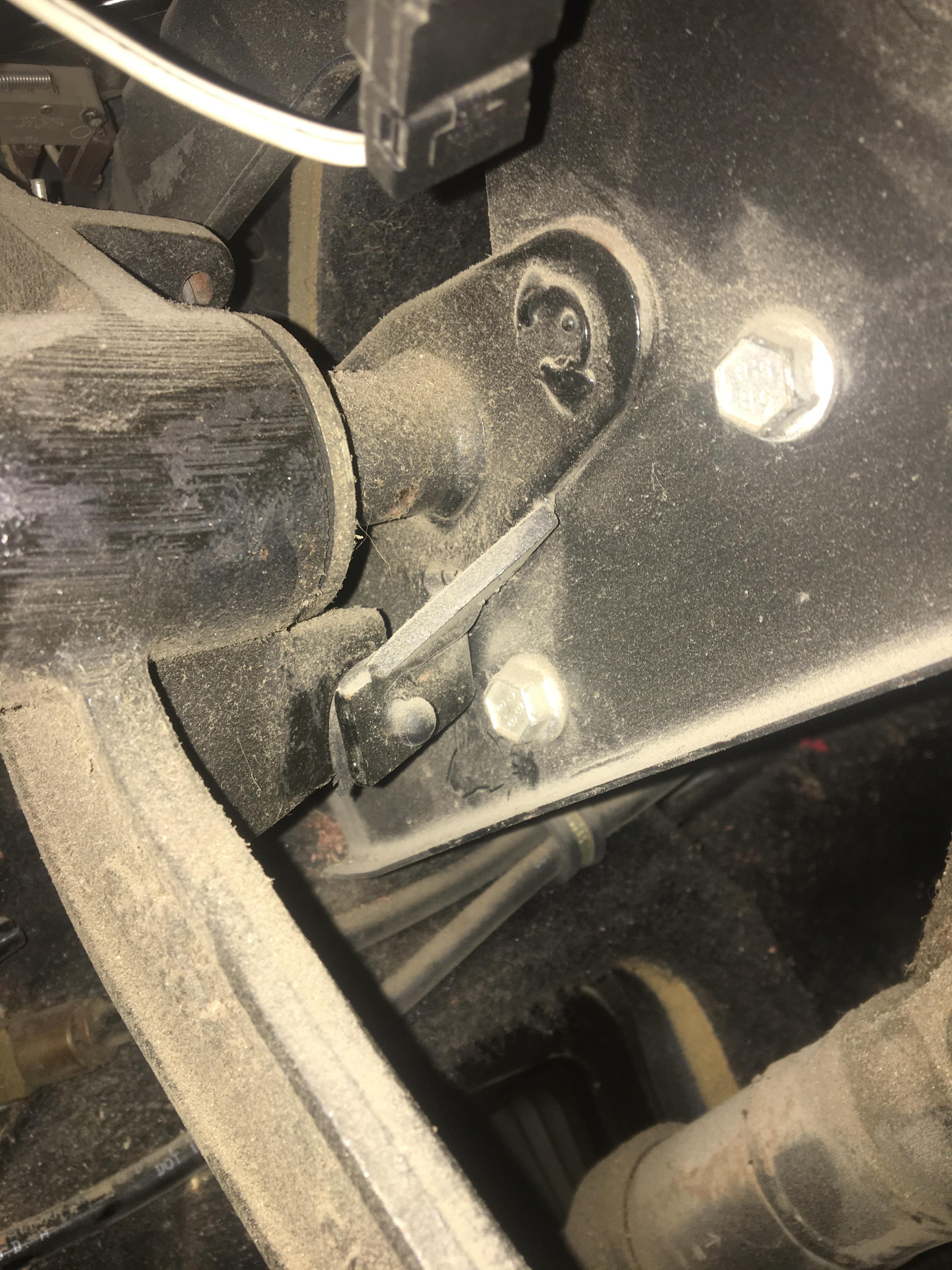

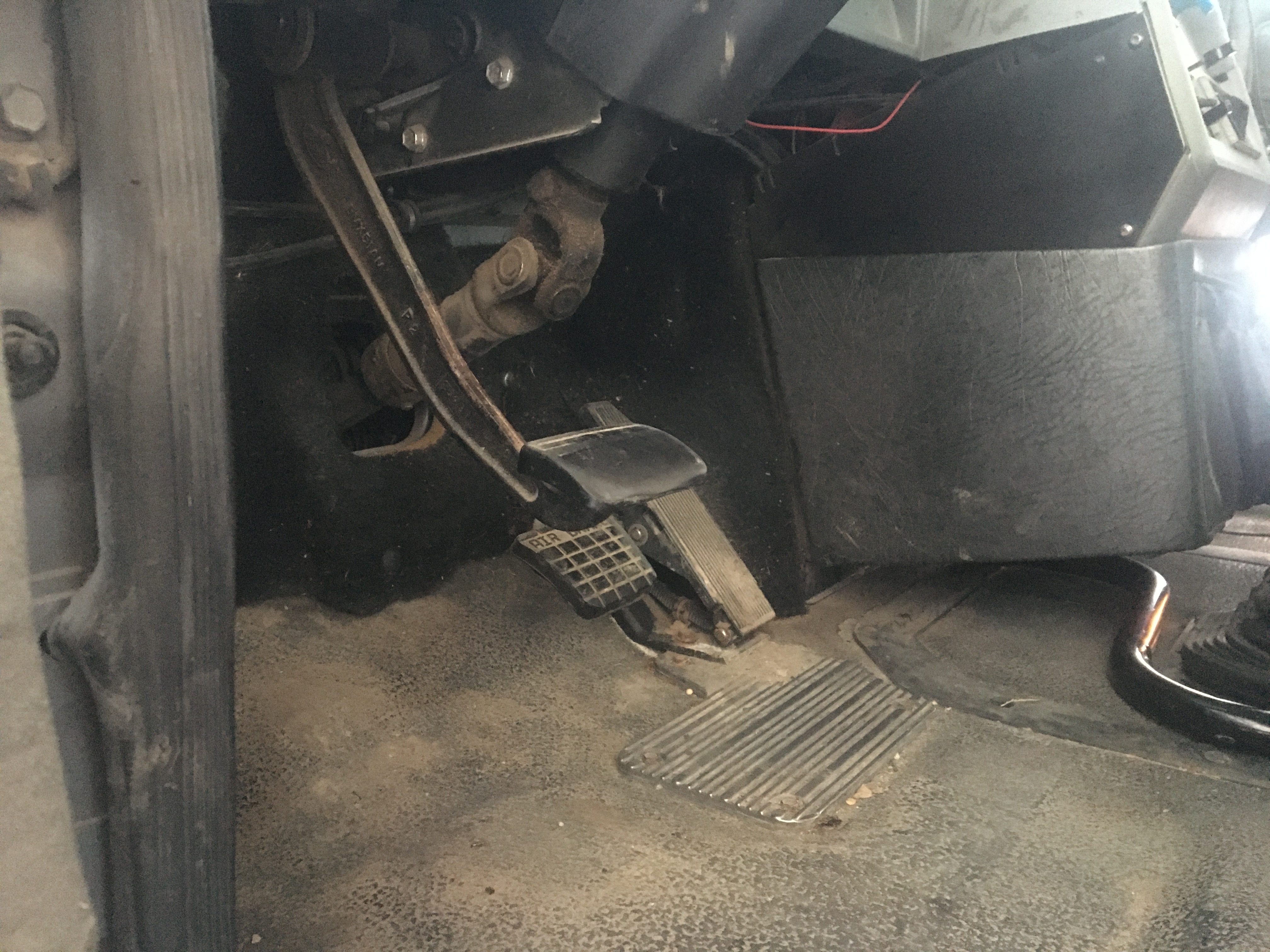

We have a 613 that the clutch pedal comes extremely high to be again it’s stop. Had a 1996 613 that was not like this what is the difference to make the 2000 this way??? About have your knee to your chin to get your foot on it!   It’s not out of adjustment that is just where it returns to the stop it has  couple inches of free travel as it should.
https://www.bigmacktrucks.com/topic/64380-ch613-clutch-pedal/
If im not mistaken there should be a rubber stop on the upper frame work in the cab under the dash that the clutch pedal hits, sounds like it may be missing
