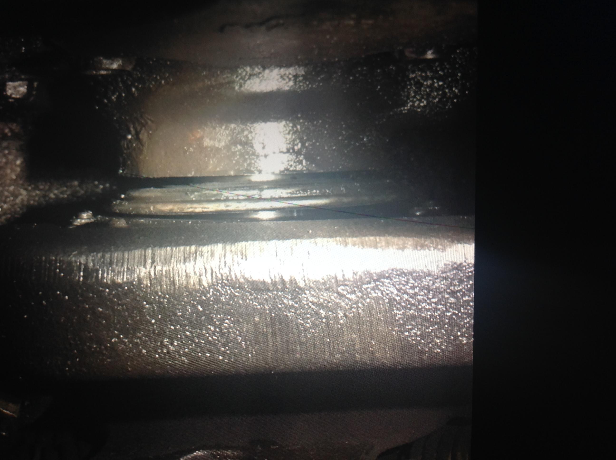

So for some reason my hinged clutch brake fell apart,after getting it out I notice what looks like another disc on the shaft,is this supposed to be there or is  it an brake or a spacer?
Expand
That is the original clutch brake  the other one that fell out was an add on! I hope you have some one holding the clutch part way down you don't have much clutch gap there!
Expand
Yes had the pedal to the floor so I could get a better picture,what should I do take that out or leave it,I had a clutch installed a few years ago,why would they leave that in there?looks pretty flimsy compared to the hinged one that was in there with it..
Well to answer my own question I'm gonna see if I can adjust the clutch to work with the one original brake,having two in there makes no sense and probably why it failed and I should mention this the second one that broke in less than a year..

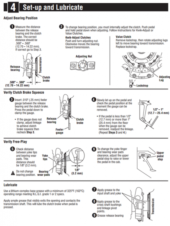

So you need to adjust the linkage sothe brake has contact with the brake aprox one half to one inch off the floor then adjust the clutch ring inside  till you have a half inch gap between the the brake and the throw out bearing!
Edited by fjh
Not sure if this helps, but here is the adjustment page from a 2-disc Spicer clutch instruction brochure.  It talks about setting the brake, exactly as FJH said, and then adjusting the internal clutch clearance.  I had to do this to my old R, after which the clutch and the brake worked perfectly.  Whoever put it in had not done this, and I thought I was in need of a new clutch, and I had no brake.  But, once properly set up, the thing worked like a charm.
Edited by doubleclutchinweasel

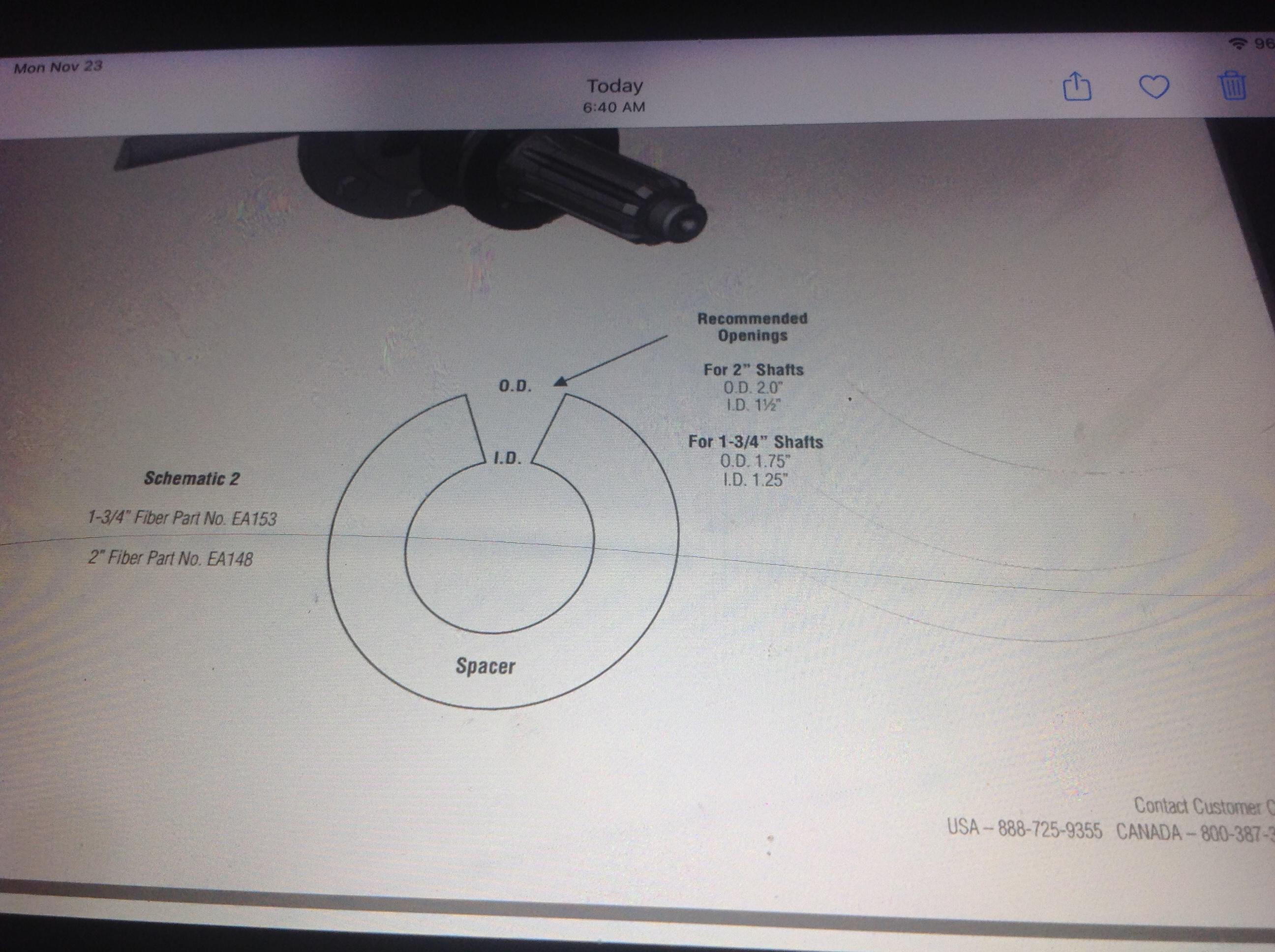

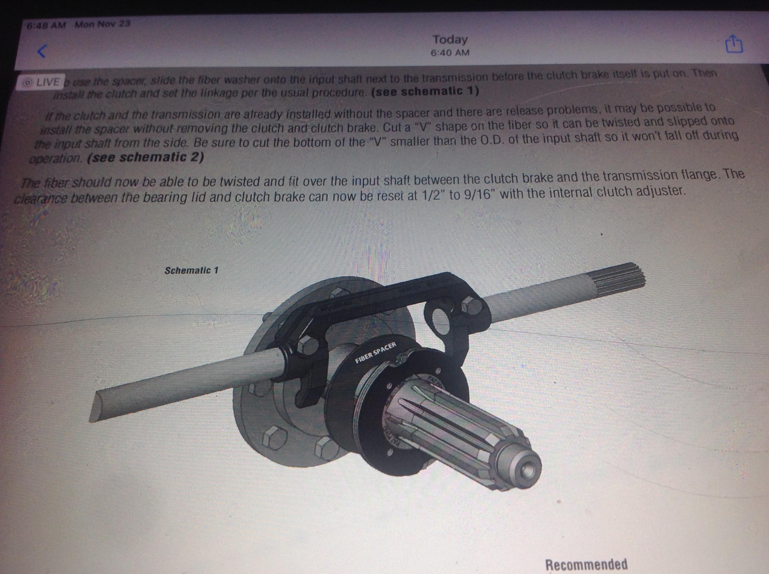

So I'm gonna try this,what do I have to lose,I ordered two spacers one is 1/8 inch and one a little thicker,throwout bearing is barley touching the brake now one of these should do the trick,hopefully it stays on the shaft..
Expand
Hope that does it for you.  Looks like a lot of bang for the buck, as long as it works.  Looks to be fairly simple to install, at least.
Let us know!
Let us know!
Expand
I've seen those used before I have no experience with them though  Let us know how it goes! I would use it on the front side as yours looks quite worn!
