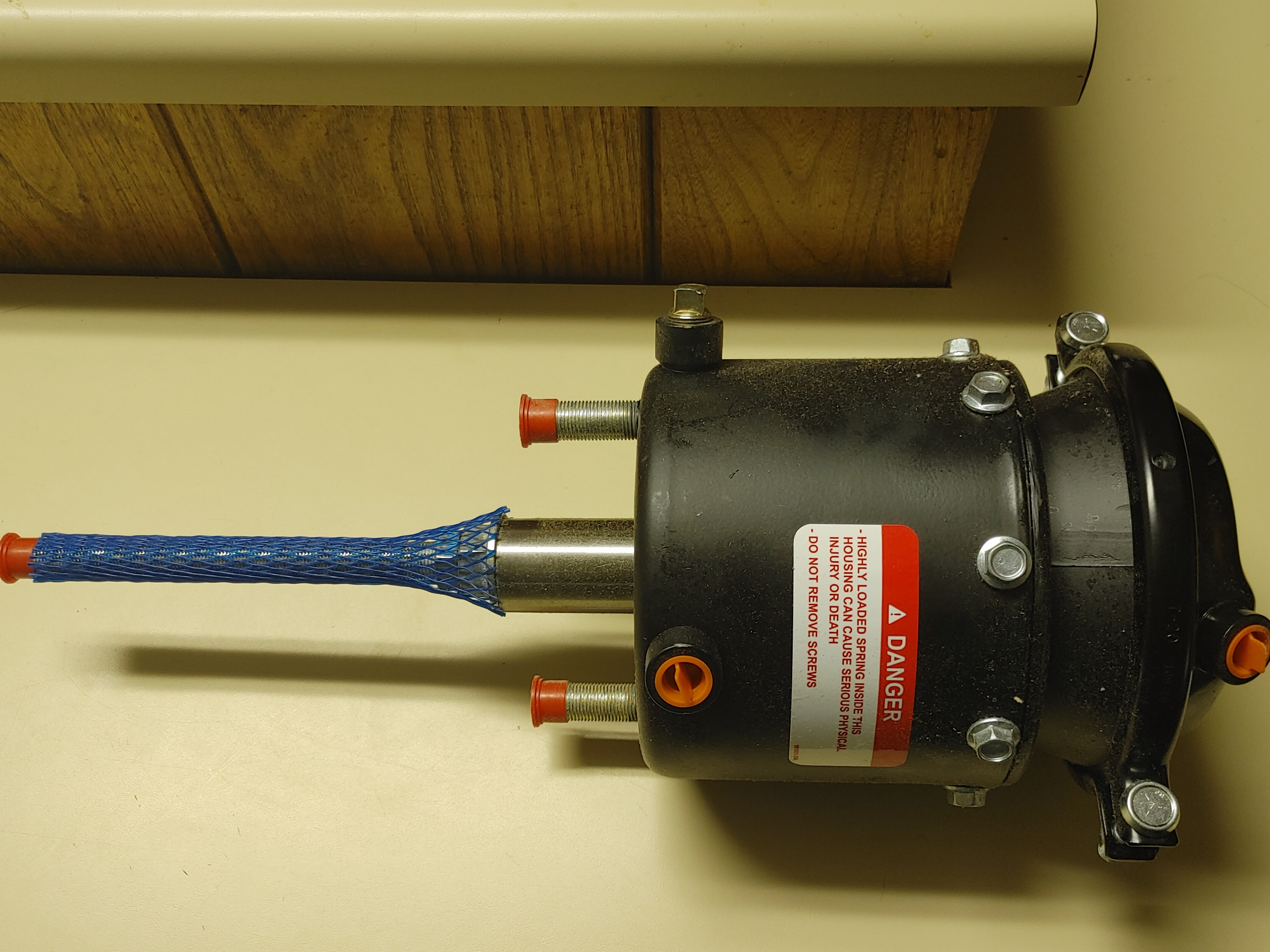

14 minutes ago, AMGeneral said:
The new brake chamber from Haldex arrived today, this truck has Type 20 Maxibrake  chambers on it, It was missing one when it arrived.
These Maxi type chambers aren't cheap, $381 each.
Welcome to the world of antique trucks.
