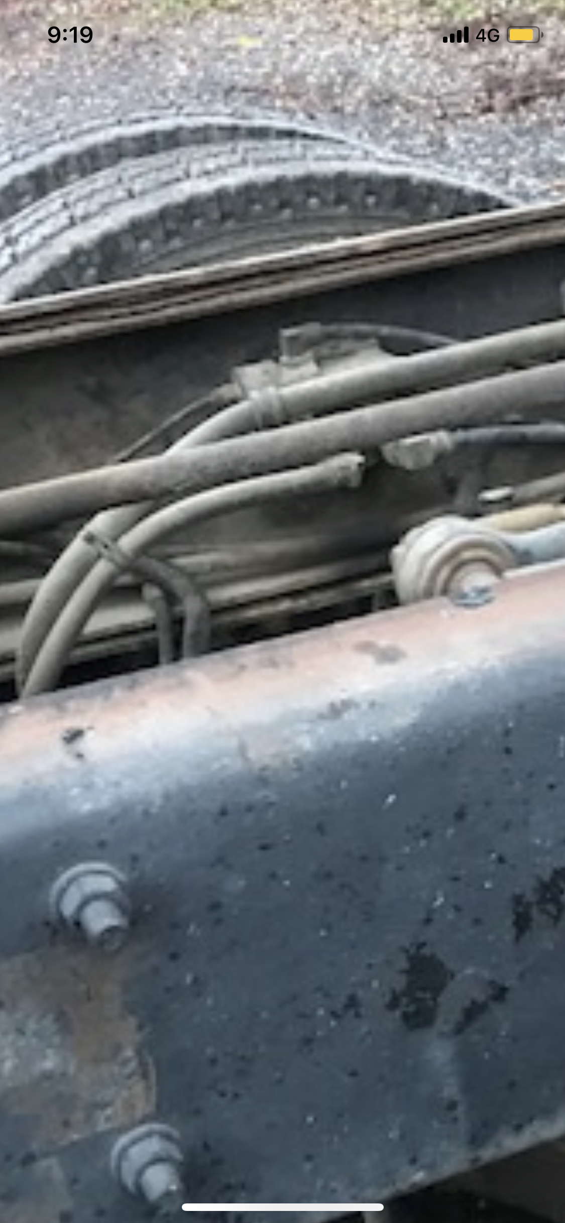

I haven’t went to look at the truck, it’s about 10 hours away from me. I need to gather as much as I can before I go to look at it.
Edited by Offroadingrlife
Yup there's your frame spread I've seen worse but unfortunately it doesn't go away it just gets worse. I'd show that to whoever you plan on getting a safety from and get there opinion. 10 hours is quite a journey any reason why your going that far I'm sure you could find something alot closer
There’s not much local to me that isn’t completely destroyed or asking so much for clapped out junk. I’ll travel if it’s worth it you know, but if it’s not worth it I wont. I guess I should look for a few more trucks to have a backup plan
