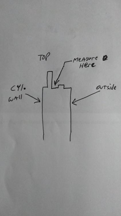

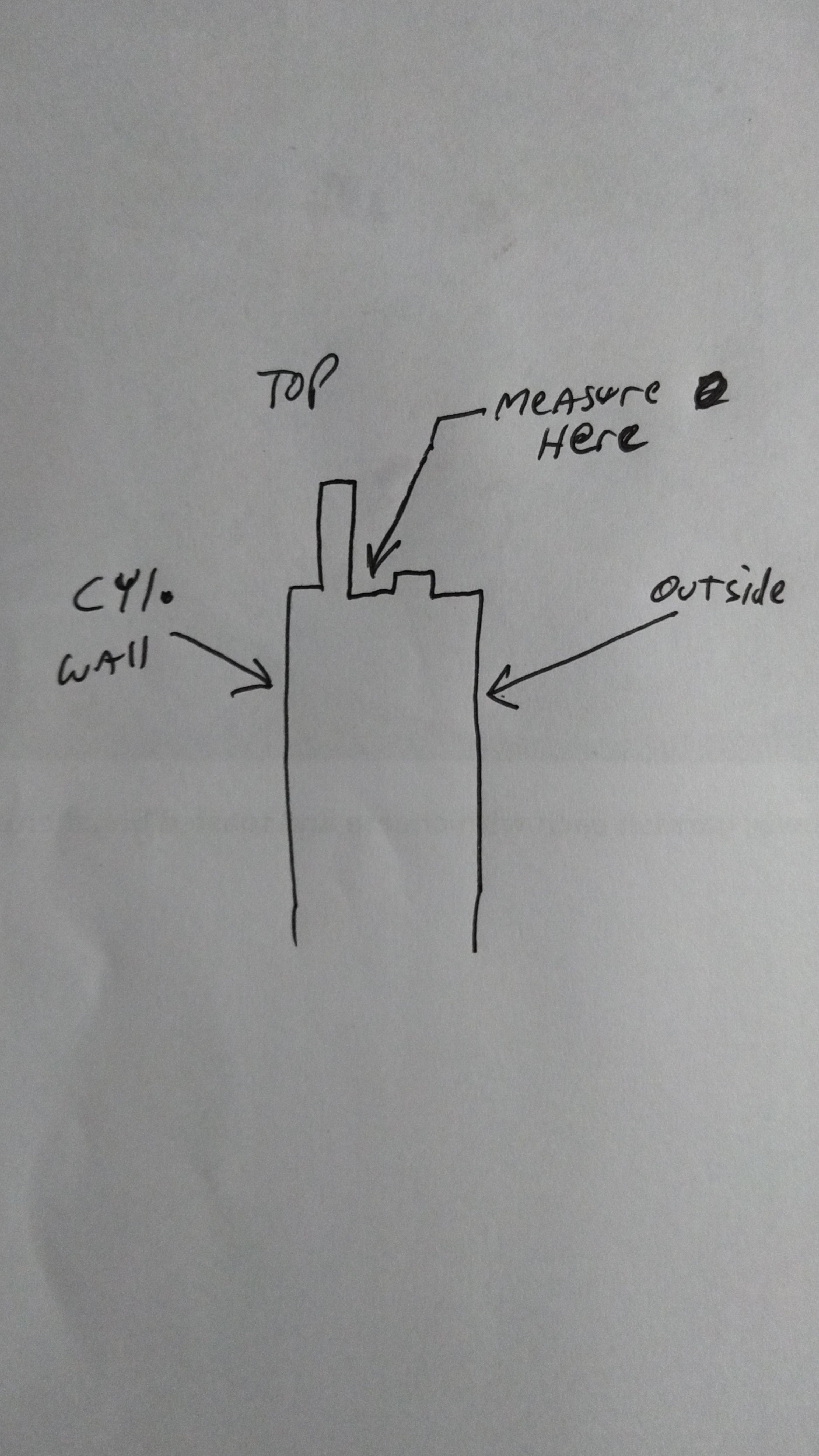

Yeah i noticed the mains are different.  I put the cam n lifters in and put the mains in. I do have a question on the liners. On top of the liners there is about 3 different steps. Where do you measure the height? Also my old liners had oring up towards the top the new liners do not have an oring. Did mack change that? This is a mechanical e7 with back half of pump electronic. Thanks
https://www.bigmacktrucks.com/topic/65463-e7-inframe-questions/#findComment-467138
Mack did away with the o-ring...  On the liner there is the tall ring(step) around the liner, measure the low groove just outside the circumference of the tall step.. you will use a small amt. of Mack Gray sealant on the shelf in the counter bore to seal in the coolant. the head gasket will take care of the top... jojo
