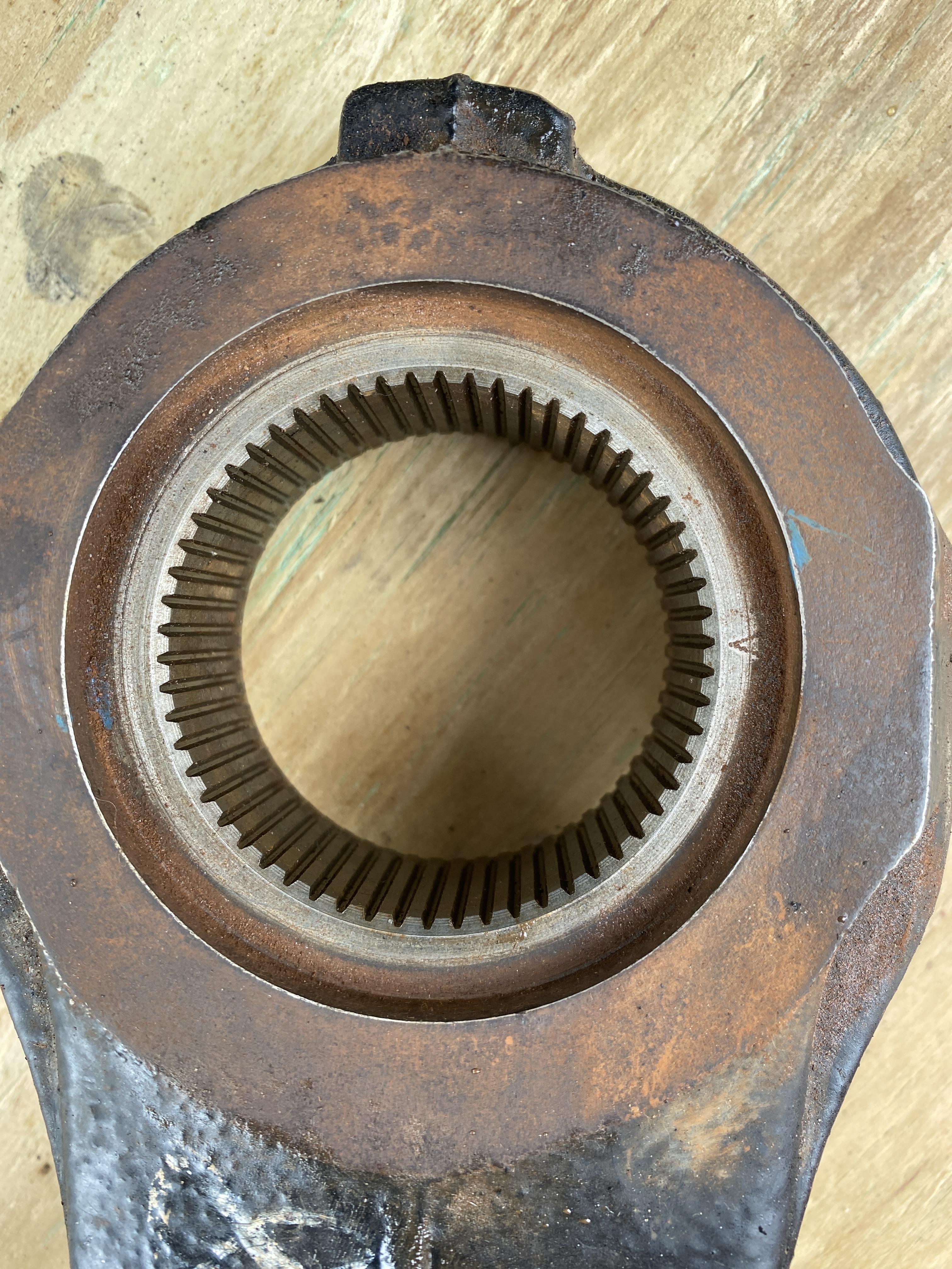

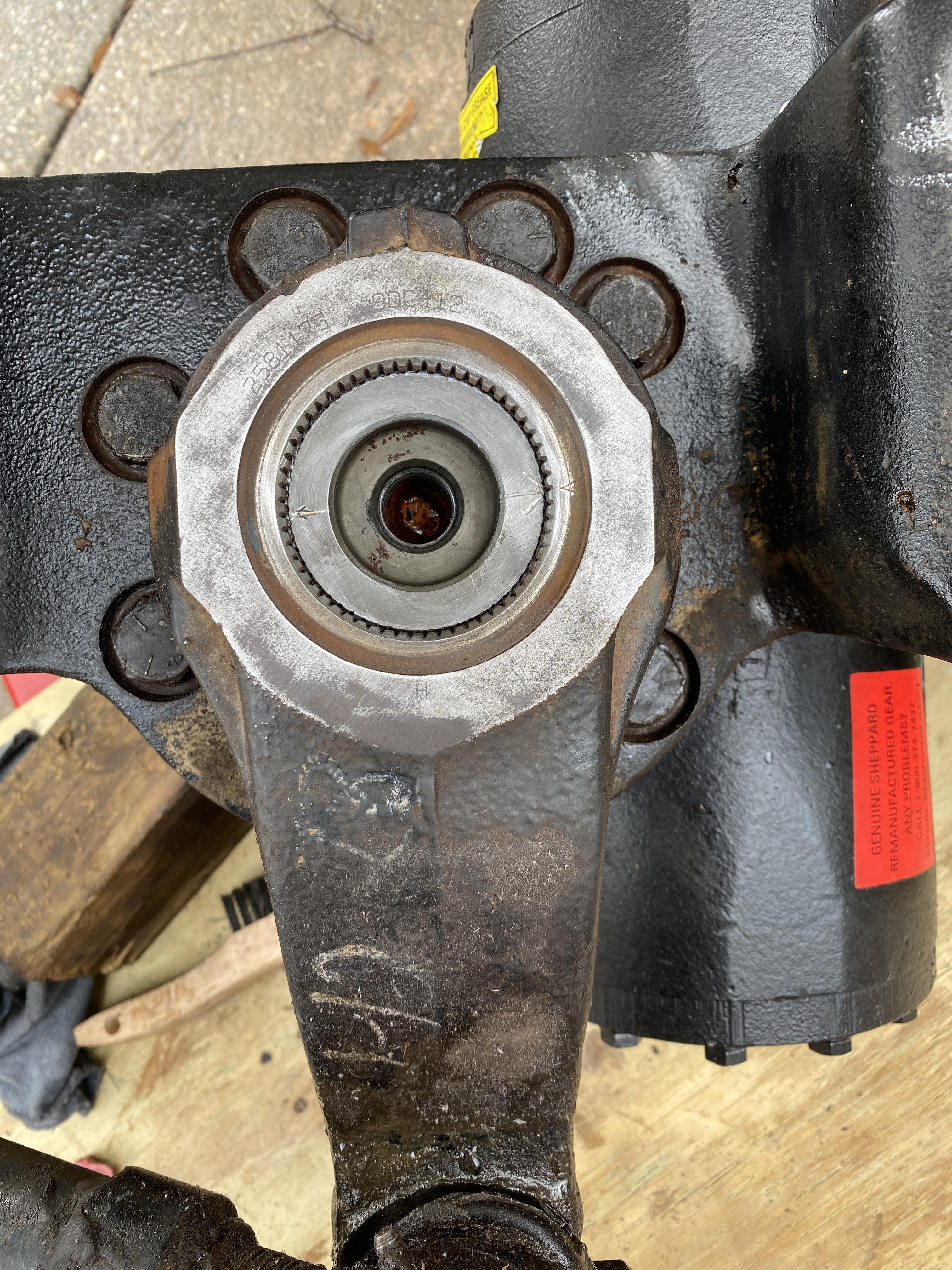

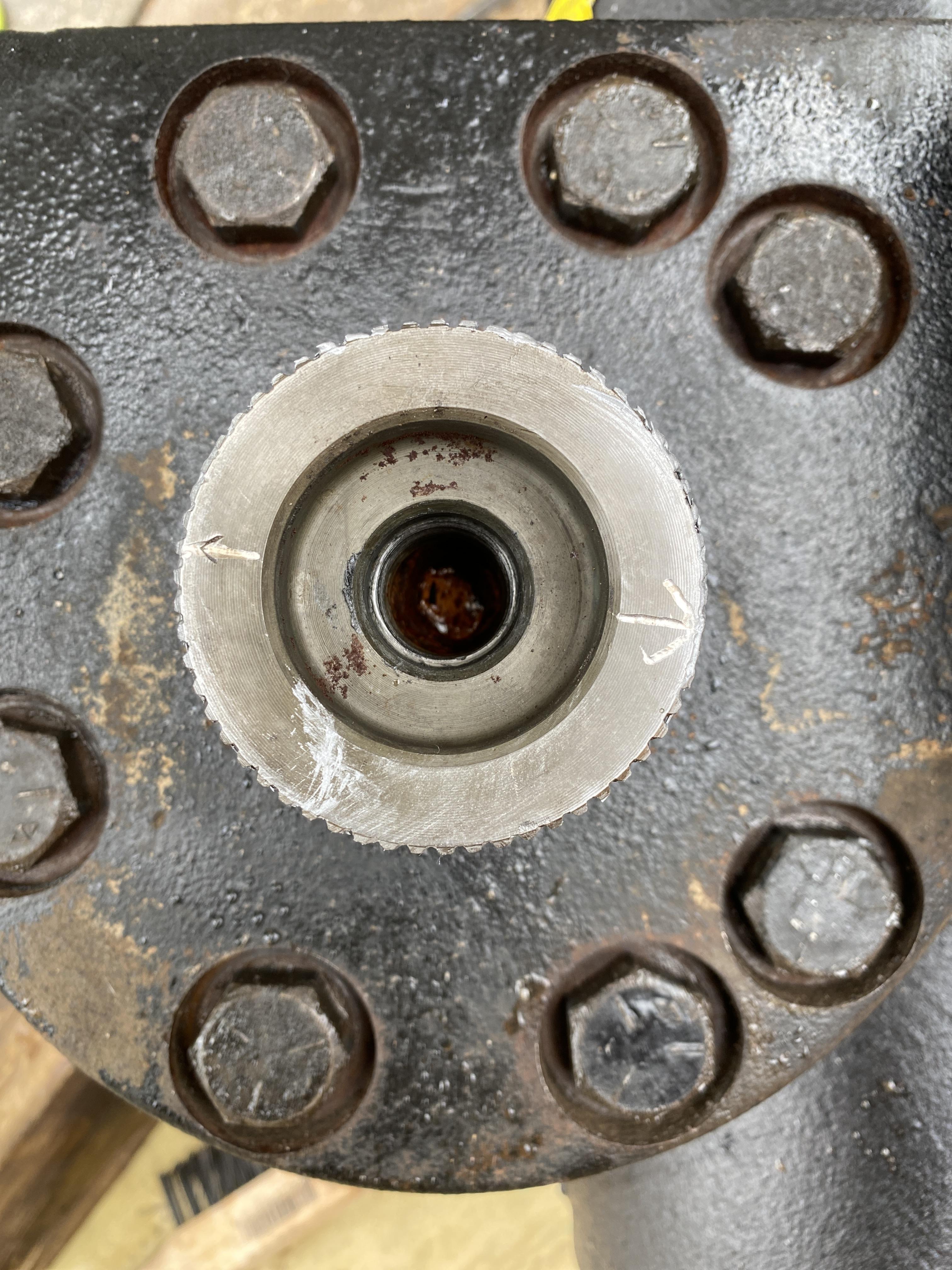

Ok,, this is a new one for me,  when its installed on the truck, align the big arrow to the pitman arm, jack up the front end and turn the wheel all the way both ways and check the range of movement.(engine off)... i'm not sure how it could be off 180 degrees, the sector shaft is only a 1/4 round gear, driven by the input shaft (worm gear)... someone here may have been through this, hopefully they chime in.. When you do get it right, you may have to set the plungers to get the best out of the steering, we will get to that later. Jojo
