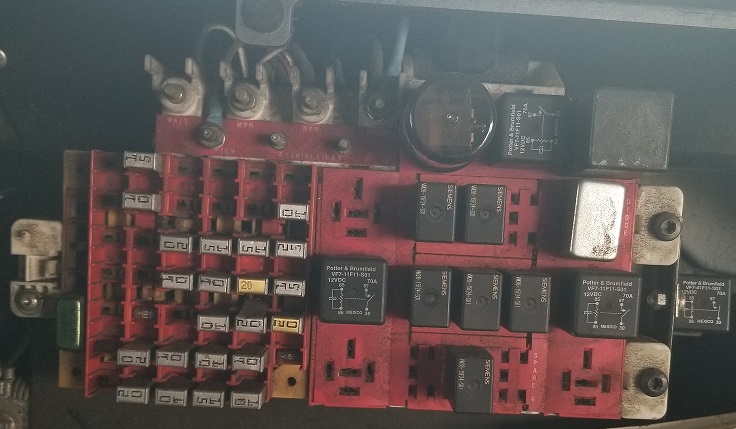

Hello All
I have now found the fuse and relay panel.
There were also several schematics in this location but nothing that gave me any information on the layout of the fuse / relay panel.
Is there anyone here that has something that would tell me if one of these relays is for the headlights?
Thanks
Phil P
