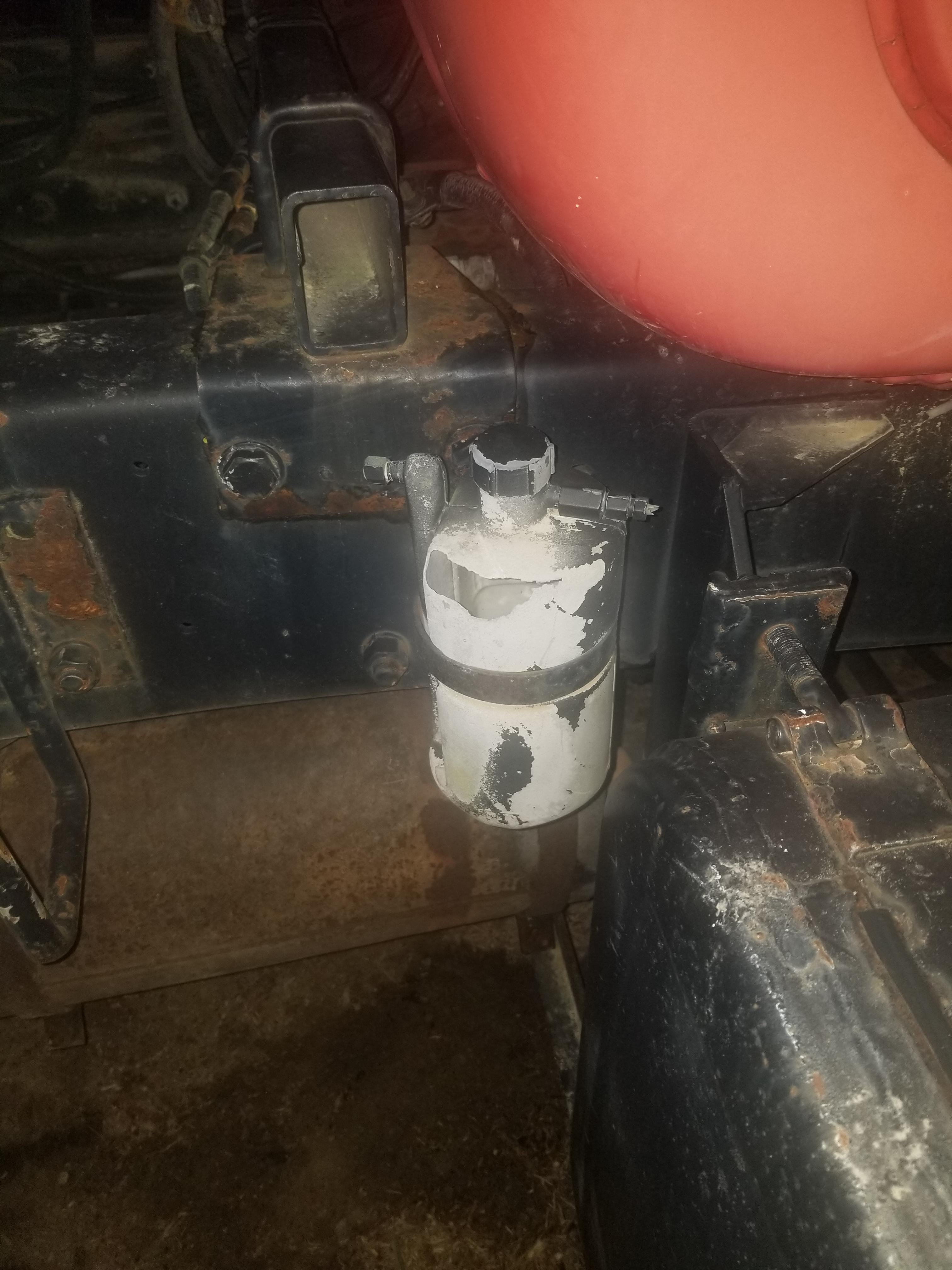

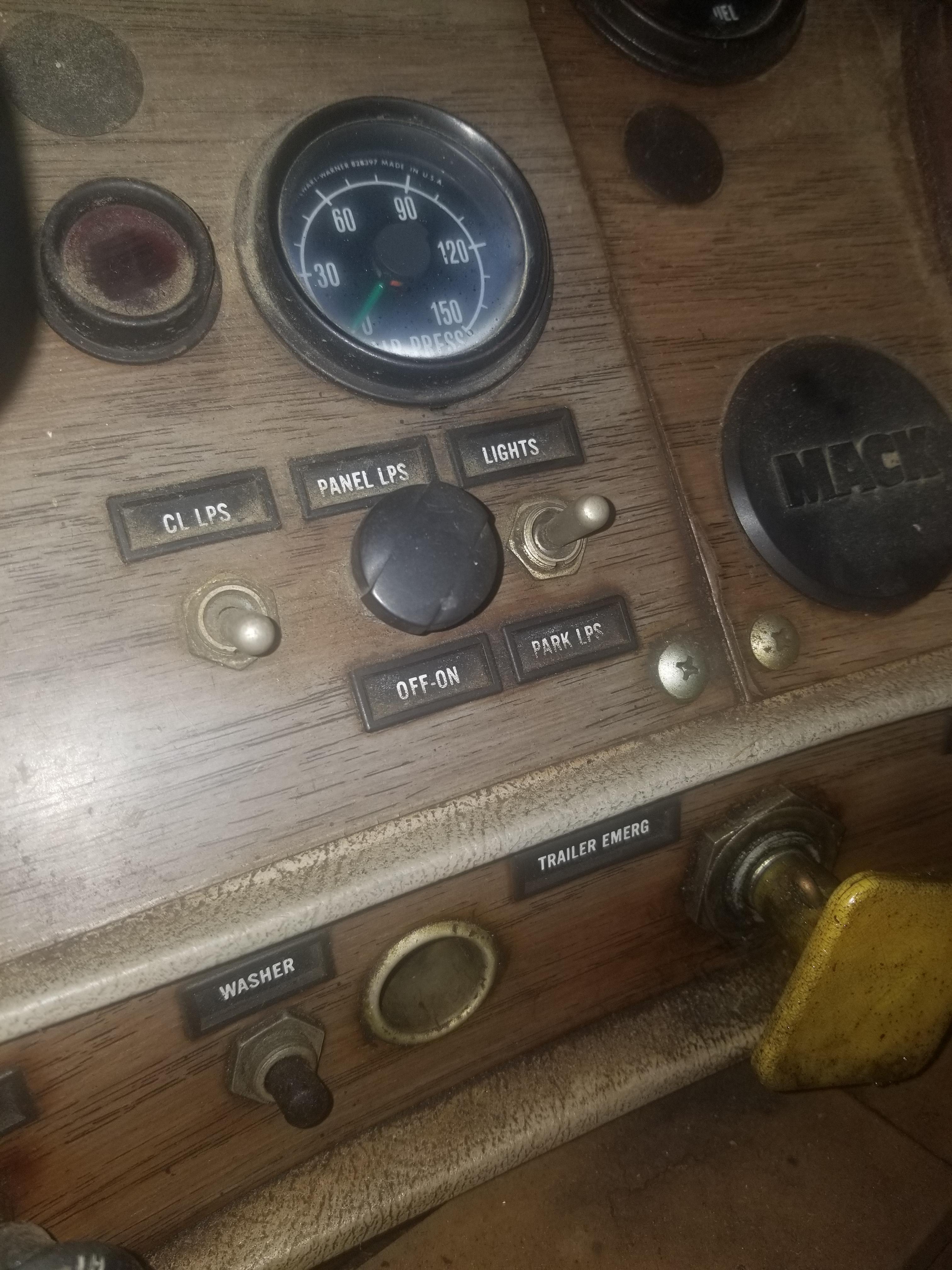

Here are a few questions I have if anyone can assist.
This white canister is plastic, and real brittle at this point. Its directly behind the passenger side fuel tank on outer side of frame rail. No lines going to it that I can find. What is it and do I need it?
Also, on the control panel I have a switch that reads CL LPS. Clearance Lamps? I assume this is for the five lights on top of cab. They dont turn on by the switch, nor do they turn on with any of the other switches. Just need to know so I know where to start with this repair if it is clearance lights.
Thanks guys/girls.

not sure on the white canister, i have never seen one like that.
CL LPS turns on the two outside roof lamps.
Just the two outside ones? What about the middle one? Mine has 5 total.
https://www.bigmacktrucks.com/topic/65648-1980-u685st-restore/#findComment-467752
they should be on the park and headlight, as far as the plastic bottle, may have been part of a alcohol evaporator kit that put alcohol in your air brakes to help prevent freeze ups.    terry :MackLogo:
I agree with Terry, the bottle is for an alcohol  evaporator. I can't see you will need it . Unless you will be using it in the winter.
As for the lights , The left toggle operates only the 2 outside cab lights. the right toggle either up or down will work the 3 middle cab lights.
