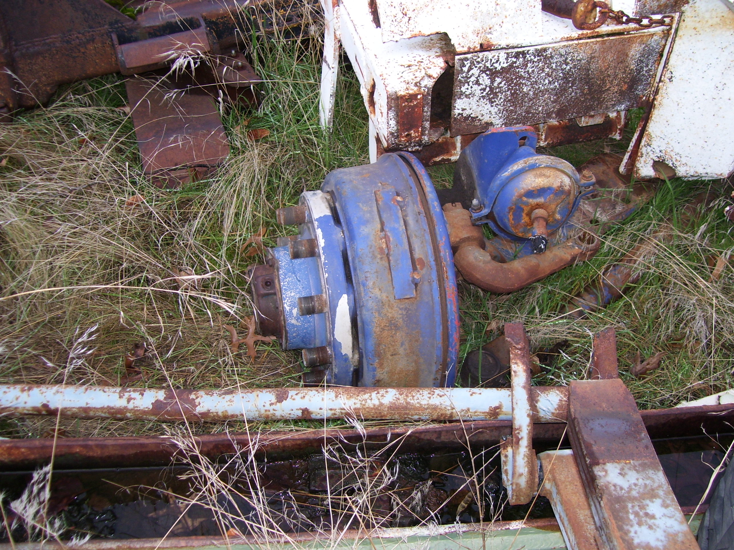

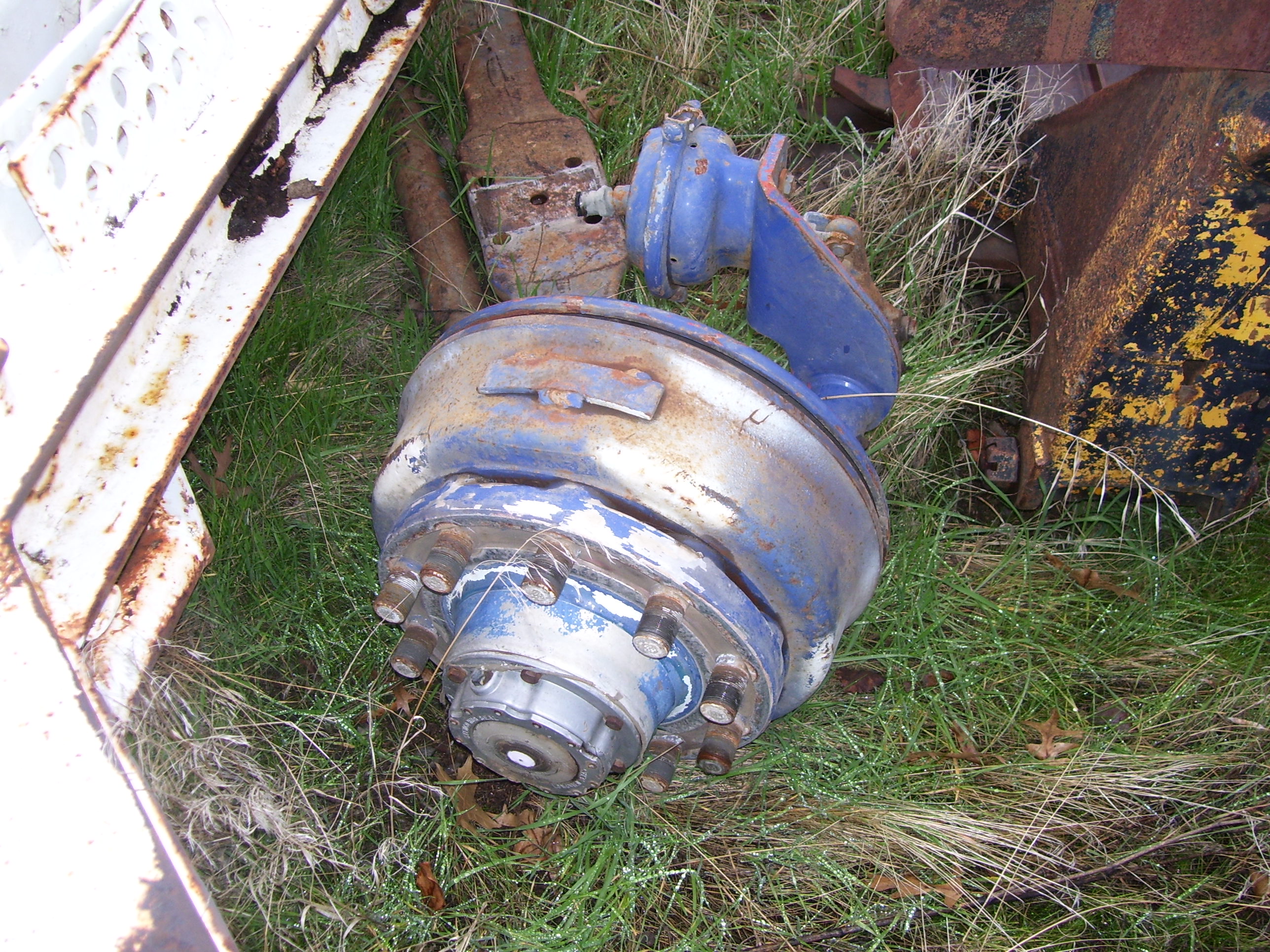

1 hour ago, storkmack said:
Hope this pic helps.   Dailydieseldose has a good write up on the Center Point  steering system.
Thanks for That. That's My new thing learnt Today..
