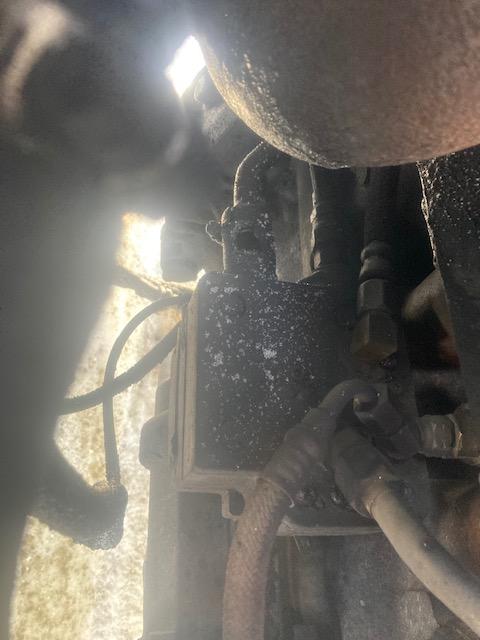

I'm thinking because of the hole in hose it's sucking dirty air through compressor, I just got truck, so I don't know how long it's been doing this. Dealer claims no issues before it made it's journey from PA to Mass, he says turbo went on way here.

UPDATE: So to recap I started out with a blown turbo. Had oil dumping out exhaust pipe fittings, no oil on intake side at all. Bearing was shot in turbo. Ok so new turbo on and also replaced small section of hose with hole you see in picture, no more oil out exhaust, but.... Picture dumping a 5 gallon pail of oil on the compressor in picture. Oil everywhere!  had oil in my tanks and out purge valve. Put on new compressor, duh. Well that fixed oil inside system but now still have massive amounts of oil everwhere in this area. Have completely degreased motor and tried to find leak 6 times. No oil until after I drive it, can sit for an hour idling, no oil. Back head oily so I replaced valve cover gasket, no luck. Intake side of head oily, exhaust side (side with most oil everywhere) dry around head gasket, but is this because close to exhaust and burning off?????  pulling my hair out. no loss of power, smoke, coolant in oil vice versa. I'm at a loss!!!
