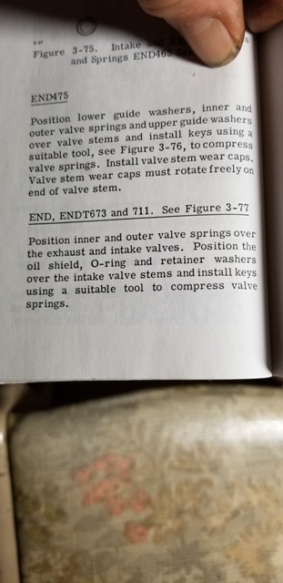

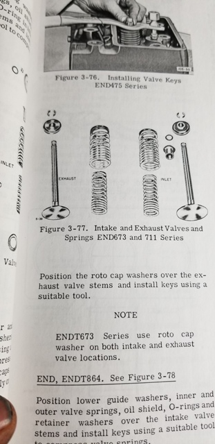

Those are called "oil shields" in the service manual from 1965. I'll check for you tomorrow as it's been a while since they've given me the formal greeting I seemingly command there which is "What the fuck you after asshole"?

There must have been a year these came out?63 711 I'm doing heads on has the tophat collarette s to hold a thick probably 1/2 or 3/8 seal.a bunch are broke...1965 711 I took apart for parts has totally different intake valve spring retainers,  with a liner and a common o ring around top of valves?

I've only seen the type as shown in the book photo myself. Maybe someone has used non standard parts through the years? Machine shop could probably get something functional as a last resort.

I agree.nothin is original anymore and who knows what some one did. Google search for 673 or711 valve seals shows different results to.guess I'm looking for a part number for those oil shield s and the thick square cut seal that goes inside them.seems to me years ago mack sold the whole kit in like a blister pack with the tophat shields and seals?

I have a friend outside of Rochester whom I'll pester to get onto the need. No promises but his brother or some relation was a Mack mechanic for a lot of years when the B series was routinely operated and has a bunch of parts. I'd bet a square cut "O" ring is really all you need to line the inside of the oil shield. With them being shown as separate in the manual, it's usually nothing special molded.
