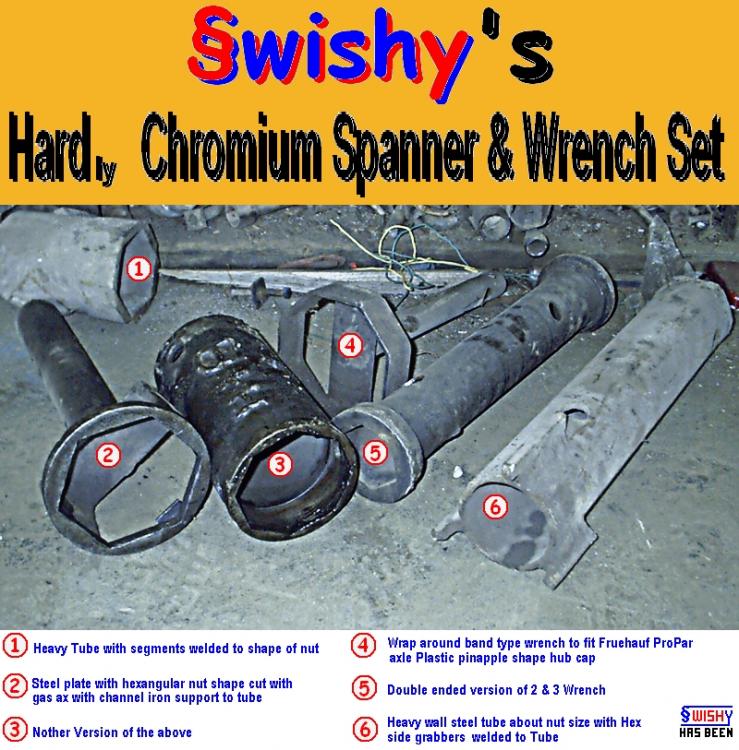

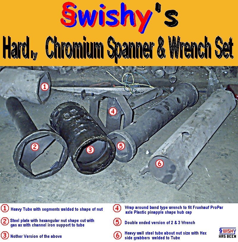

I'll have a go today at spanner building Swishman
You'll be right paul.. I've got a few Homemade Spanners in Stock as well..

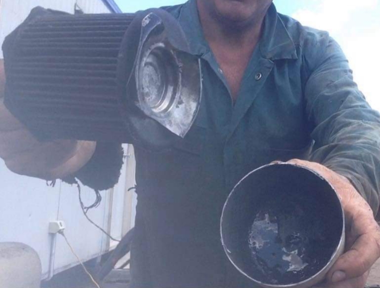

Thought I might as well change that air filter and see if it improves the shifting, had no clunk to it no more, as in it didn't go clunk when sliding it into gear
I had the new filter on hand so it had to be changed anyway
It was black on the inside to look at so I decided to cut it open
Yuck, I  did expect it to be pretty bad as the compressor was pumping oil fairly well
So thru some air in Mrs Mack and worked the high low spliter and it improved quite a bit after a few hundred shifts, I figured I have most of stuff out on the ground to pull the top off the transmission I might as well do it now just to 100% sure the bolt hasnt come loose

All this oil is a concern as it is thru the air system and I probably should of changed the compressor a long time ago
So I guess I will slowly change valves and maxi chambers im the near future
