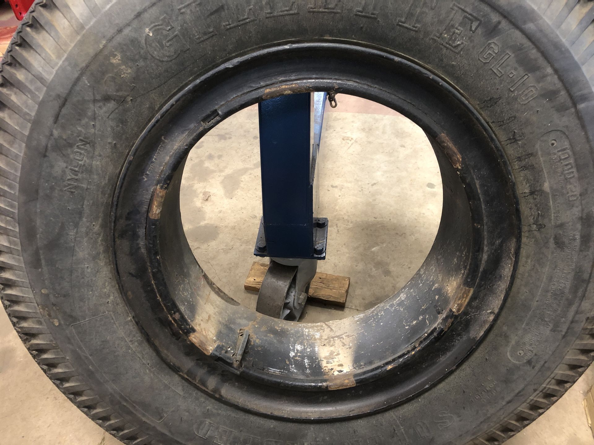

There was a thread about welding the center back into a rim and we were discussing split rims, for some reason I can't find it. This split rim is on my truck--the lock ring is solid, and you pry the rim open to get the lock ring off. I don't know how safe these are, but I won't be using it when I put good tires on my truck.

I have read about a rim thatIm guessing was this style, seem to have recalled  it had some photos with the story
Had a special jacking doodah that pulled the inner in, maybe it's that style of rim
Sure is different than anything I have ever seen
I have seen a couple of Those Rims, Know SFA about them though. I'd be putting Tubeless rims on as well..
