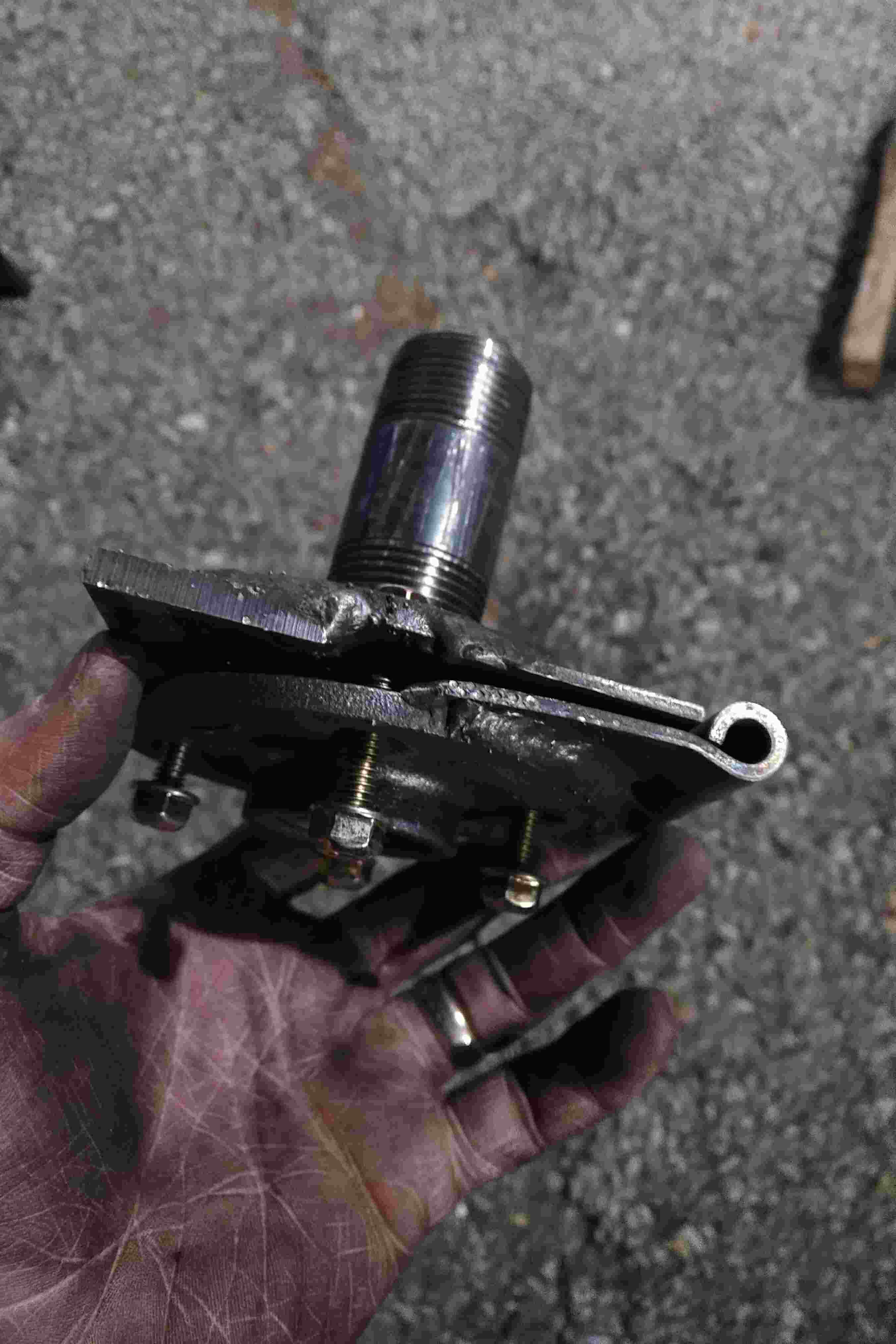

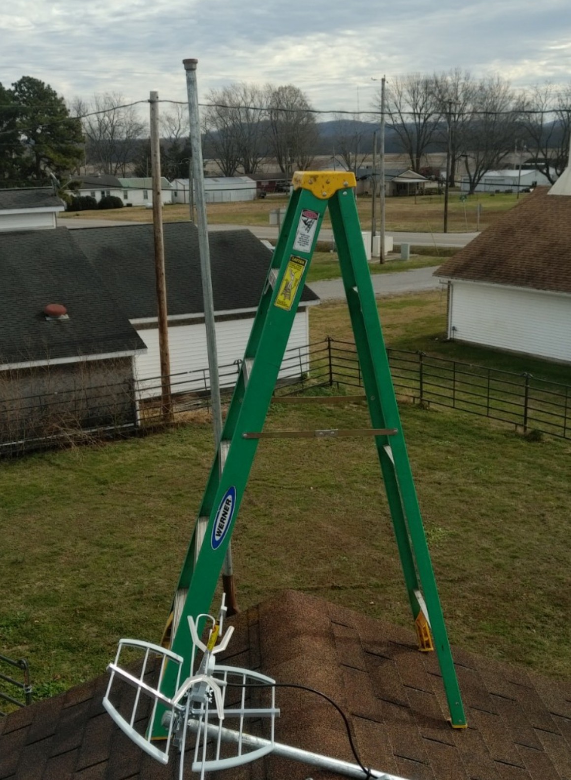

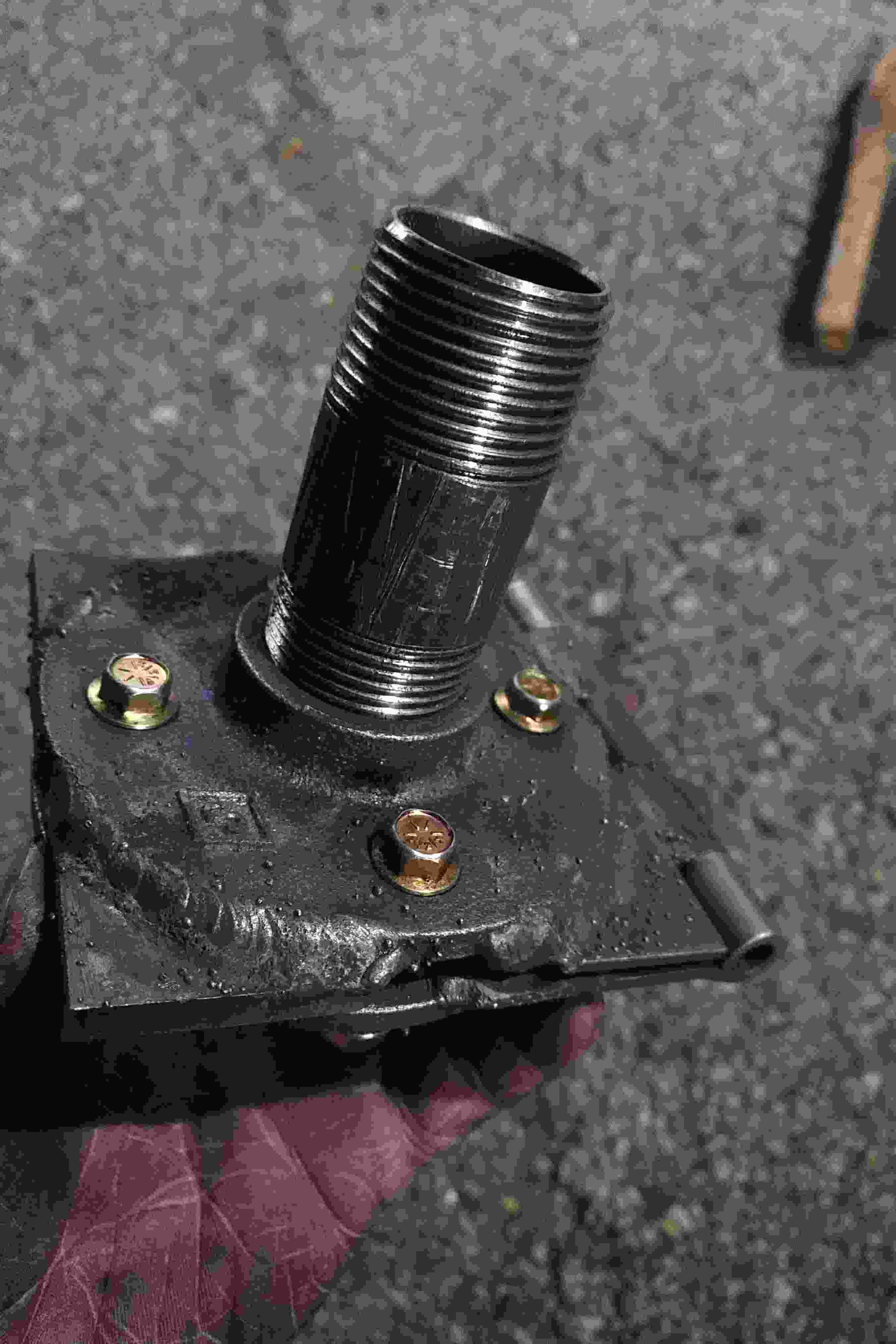

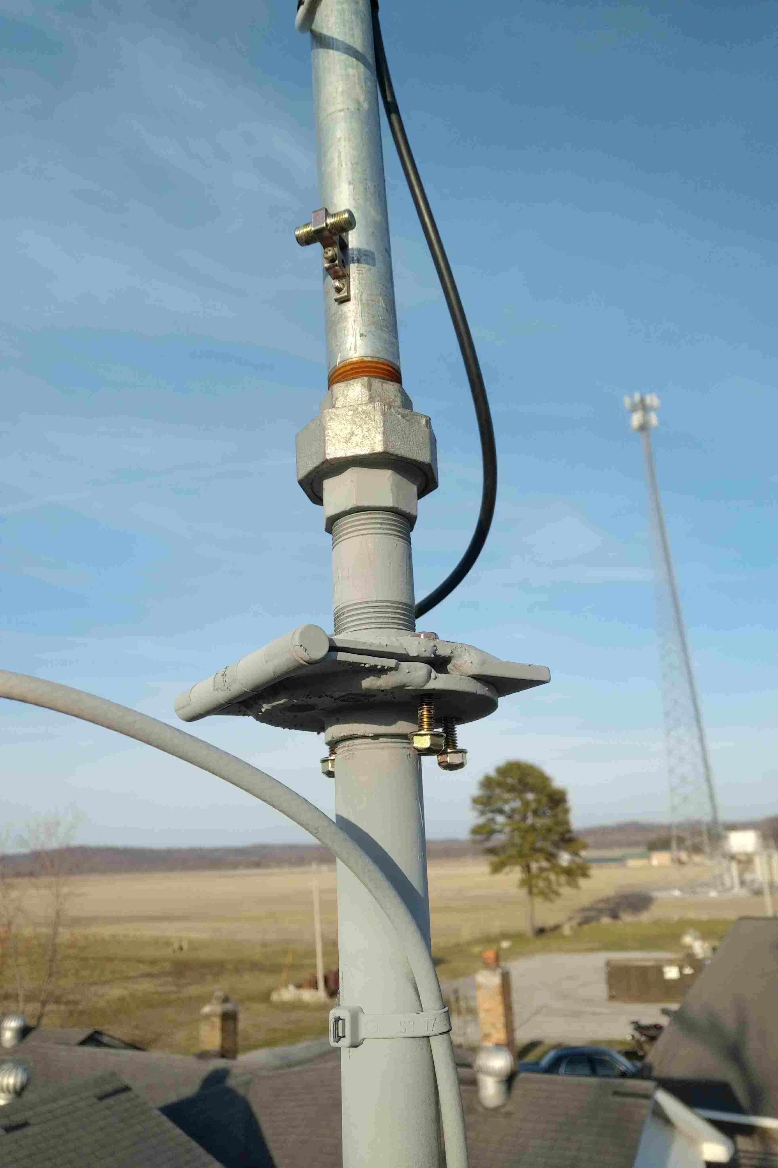

Ok...had to pull the thing down. We've got stations in several different directions, so I tried 3 antennas linked together aimed the 3 main directions to get all of the channels. We get them all now, but every time a train goes by ABC & PBS (40-45 miles N/NE) and NBC (30 miles E/SE) blank out. I tried making the coax to get the lengths I needed, but realized I screwed up AFTER it was up and I was only getting CBS & FOX (12 miles W). So today, I was back up on that ladder pulling the thing down to swap the cables out for some pre-fabbed store-bought ones. Since I wanted to make sure it was THE LAST TIME I'd be on a ladder dangling over the edge of the roof balancing a 10' pole, I fabbed up a little something something to put where the union is. Antenna is about 4-5" taller now, and if I pull 4 bolts, the top 10+' tips down toward the roof.  I raised it back up into place standing on the roof...although my 3' step ladder would make it a little easier.
Worst part is, once it was back up it didn't work any better than it with my home-made cables...so I guess I didn't screw them up TOO bad. I had trimmed the shield rather than folding it back before crimping on the end. Oops. Turns out it didn't matter.
I'm hooked back up to the single antenna in the attic...again...probably replace the 3 small antennas on the pole with a single big one, similar to what I've got in the attic, but NOT in the attic. Needing to put a new roof on the house (original roof...built in '94) because it's old & losing shingles every time the wind blows too hard. Looking at steel overlays, but then that attic antenna won't get any reception...got to get the antenna outside, and hopefully up high enough to get above the interference caused by the trains as they go by.

Your door hinge and floor flange are a great improvement to your existing design. If'n it were me and I was wanting to receive all the stations in the area I would purchase three high gain antennas and mount them 120 degrees apart at the top of the mast. From these antenna output jacks, parallel their received outputs into a single unit. Also purchase an "Impedance Changer" from an online supplier to change the 50 ohm terminations to 75 ohm and run a heavier gauge RG-75 video cable to your distribution network inside the house.
Better yet would be to bring the received signal down into the house through a 50 ohm RF series cable, (RG-214) for a very low loss transmission rate and use the impedance changer near the point of use meaning your video distribution apparatus.
I do not care for the customary "F" series cable terminations commonly used on household video cables but rather "TNC, or BNC" style which are much better quality. TNC is threaded, BNC is bayonet style mounting to the female jack.

I like your fold over design!   A friend is working on something similar, but it is for his 80Ft tower he is replacing for his CB.   Big storm took his last one down a few years ago.  He can't find ANYONE that will climb/build a tower anymore, so only way around it is to build it and swing it up.  We were discussing the effort that it will take to stand it up.  I don't think he realizes how heavy that will be and the power needed to stand it up with a very short prop point for the cable.

I just used a steel 4" hinge, available at pretty much any hardware store for a couple bucks. Pole is galvanized...but I used black pipe for the flanges (welds easier/better in my experience). Piece of flat steel the thickness of the hinge when closed on the opposite side of the flange to support the weight & fill the gap. Hit it all with some cold galvanizing primer & paint so it has a similar color & won't rust so quick. It was still a real chore to get the roughly 10-1/2' section raised up, given the hinge is about 6' above the roof...run out of leverage (my 3' step ladder might help with that, though). For an 80' tower, he's gonna need A LOT of help! Hell, it took 2 guys to raise up the base, and it's not quite 30'. He's also gonna need a bigger hinge. The one I used is only rated for 70 lbs.

My buddy has a very large hinge made up of like 3/4" plate and 1" bar for the hinge.  Nothing store bought.

UHF, VHF used for video and television communications are "Line of Sight" frequencies so vertical height is a must for distant reception. Doesn't matter if the component is digital, or analog, it is still carried by a frequency in the aforementioned "bands" for transmission. This "carrier frequency" is then stripped off and useful intelligence remains. This is then heterodyned into it's component parts and an intermediate frequency is generated for further processing into what you see on your screen.
However if the carrier is not strong, there is no intelligence available which by the way is my personal dilemma.....
Get your 3 sided antenna array up to about 75 feet vertical, use good cables, interconnections, and high quality components and you'll be happy. Be certain to environmentally seal the interconnections for your continued happiness.
