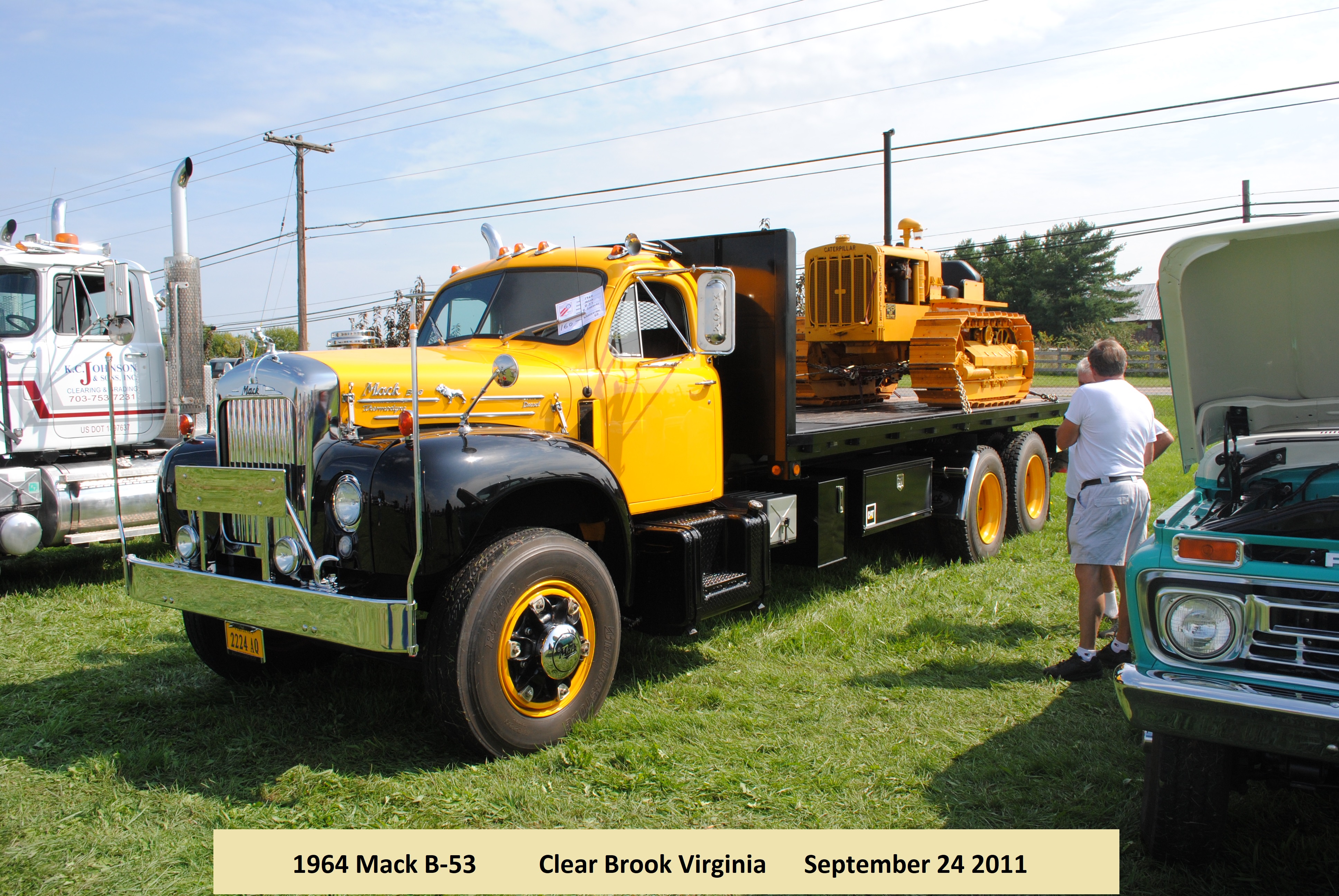

I am a senior citizen that has always been interested in cars and trucks; especially those made in America.  I have photos of what is supposed to be a 1964 Mack B-53 and a 1964 Mack B-63 but  they are photos of the same truck.  It is a flatbed yellow truck with black fenders and the photos were taken at Clear Brook, VA.  Did Mack build both a B-53 and a B-63 in 1964 and is there anyway to tell one from the other?  The image is not sharp enough to read the insignia on the hood.  I am trying to correct my records so I can share the photos with my grandson.

If I recall, originally a B53 would have lips on the front fenders.  A B63 wouldn't.  So that truck may have started as a B53 but the fenders may have been replaced.

I don't know the difference between the two models but do know the truck in your picture. It is a B-53 and belongs to a fellow from Warrenton whose father owned it and operated as a concrete mixer. It is a beautiful truck that went through an extensive restoration and addition of all the creature comforts A/C PS etc.
Harry S., Thank you very much.  For some reason I was showing B-53 on two photos and B-63 on two photo.   They were taken 3 different years.  I will correct the others now.  I do try very hard to get my information correct when I take the photos but I messed up somewhere.
