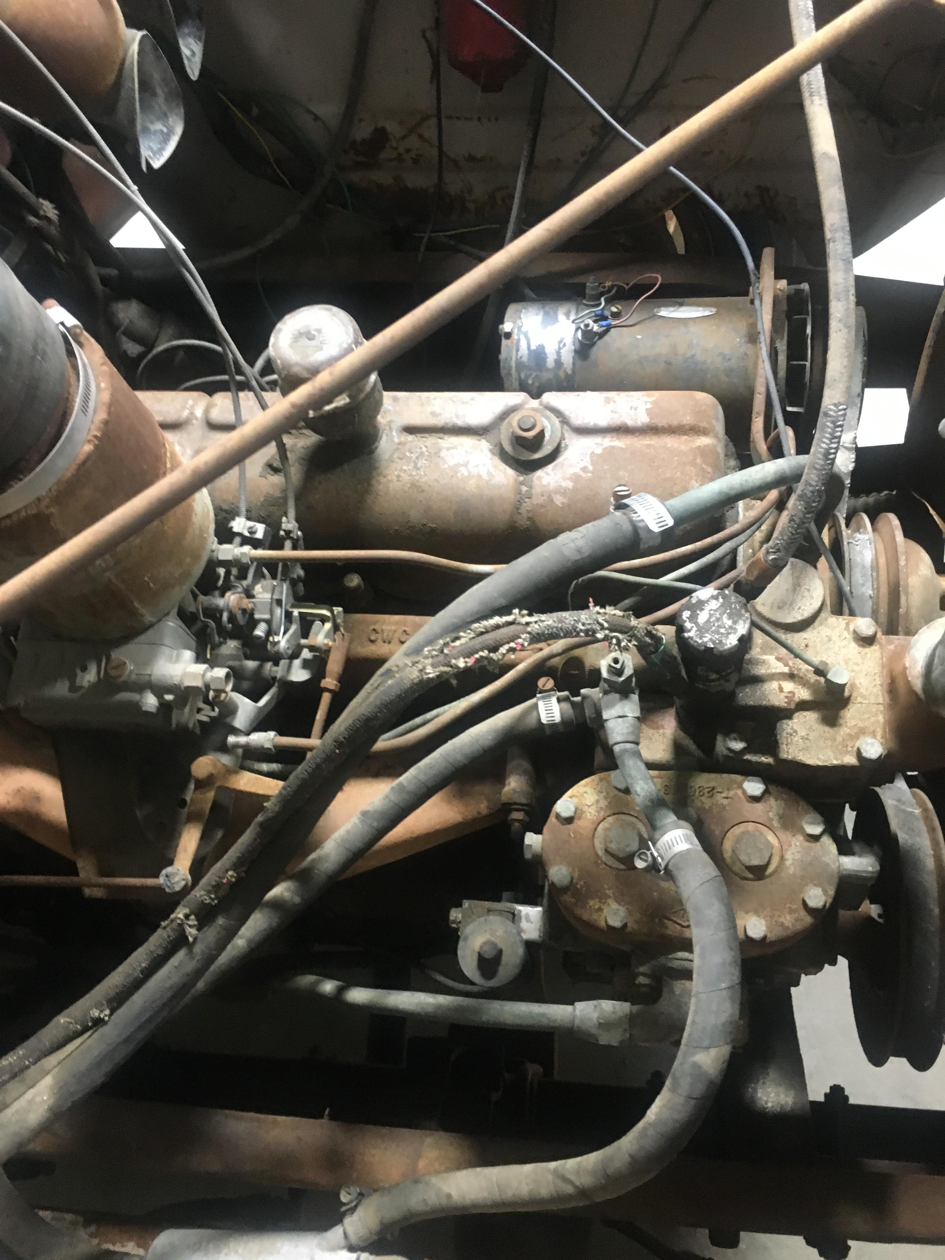

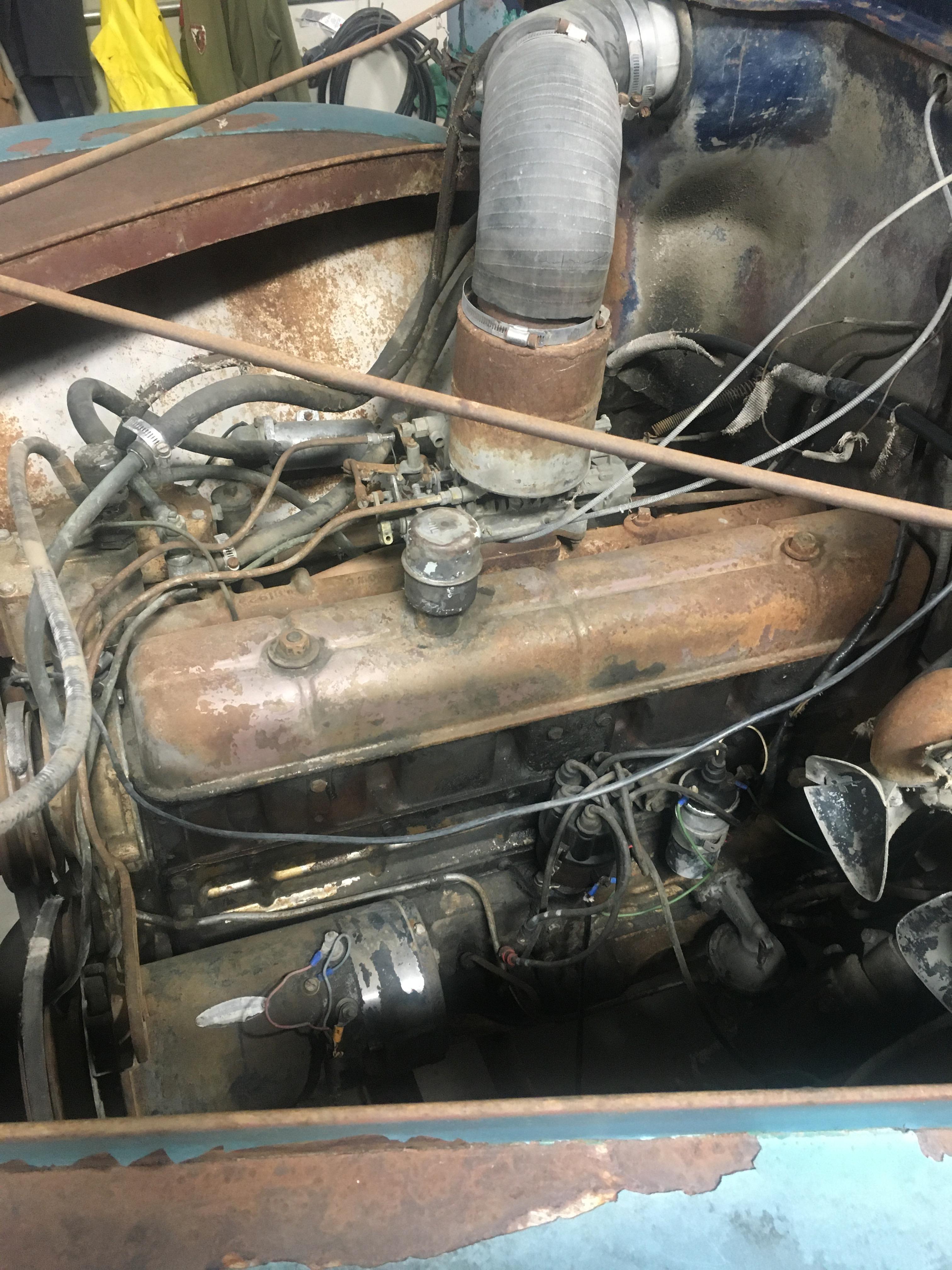

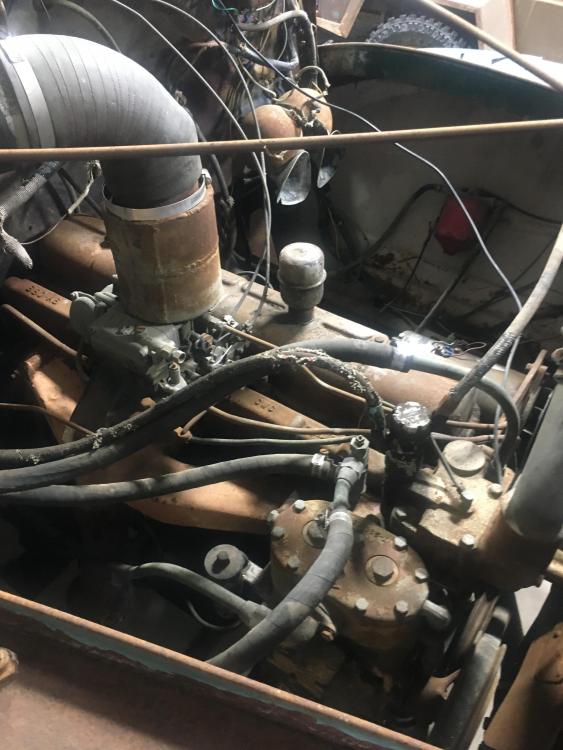

Both the REO Gold Comet, and IH Red Diamond series were popular engine swaps when these trucks routinely operated. Considerably more power than the EN-401/402 Mack flathead gasoline engines.
29 minutes ago, Mark T said:
Weren't they in deuce n a halfs ??
They were in damn near everything back then
The manifolds are on the wrong side for the Reo, IH motors dont appear to have a water manifold at all
Ford are wrong as are Chev, I  reckon it looked a bit like a John Deere Header (combine for you Yanky lot) motor lying in the grass at the farm
Will have a look tomorrow night if I remember
Hmmmmmmm
Paul
The REO engine only had two nuts retaining the rocker arm cover where the Continental OHV engines used four IIRC.

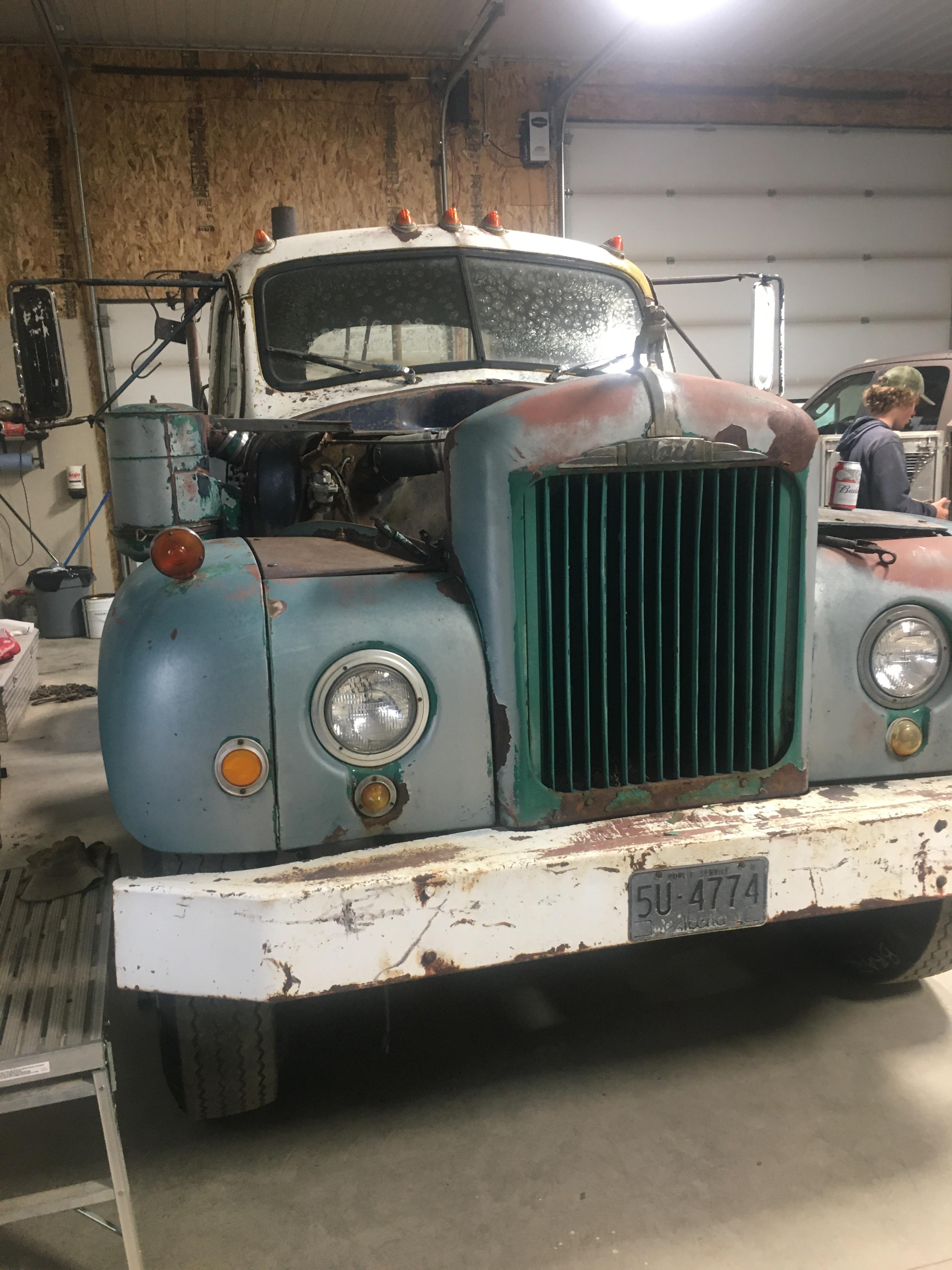

I love this site, thanks very much for the input. Would this Be a fairly rare engine these days?  The motor is seized and we were considering a 6 by Cummins swap. Maybe we should be putting our efforts into this motor. Would like to hear thoughts from u guys
If you are considering either a 5.9 or 6.7 Cummins replacement please search both the Brockway and Just Old Trucks websites for an excellent 20 some page topic by Oldspwr on his replacing the original flathead Continental with a 5.9 Cummins in his 1955 Brockway 154.
