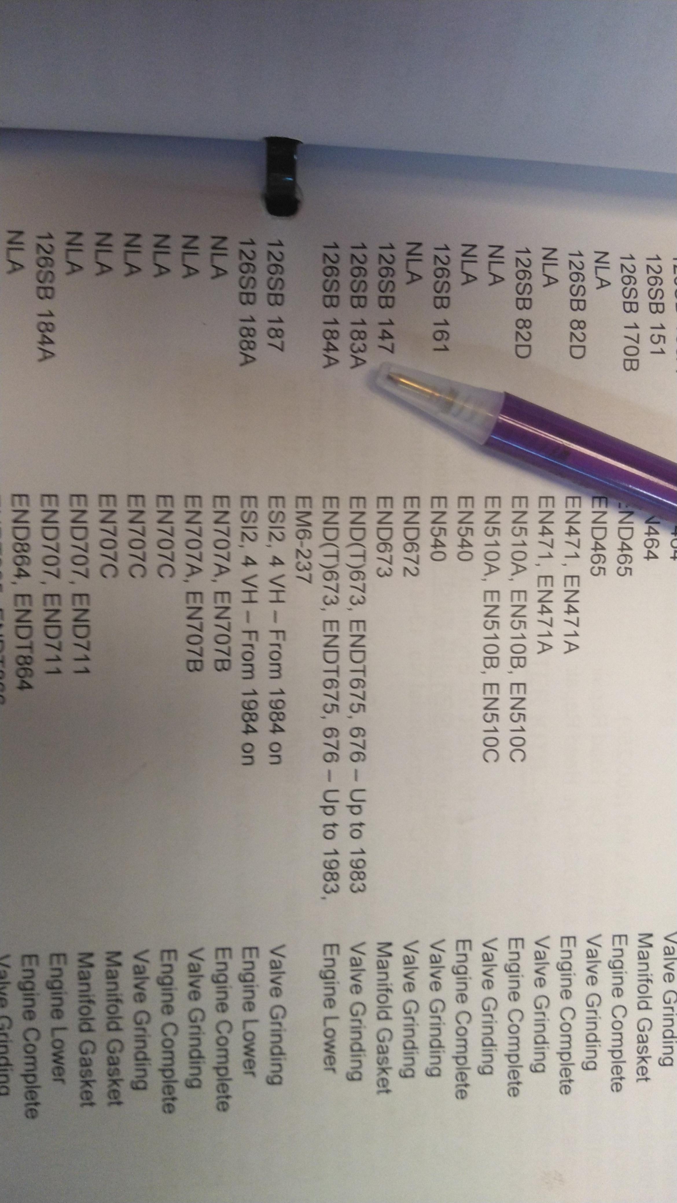

P.A.I. makes parts for the 673.  I have one in my shop now. I also buy from "AGKits.com". the book i posted was a printout that one of my favorite Mack parts guys printed for me. It's 125 pages..  It is loaded with part numbers, for almost all points on a truck...   Joey Mack
