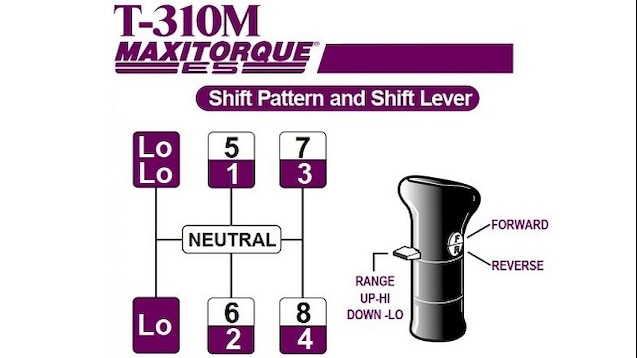

you can tell that trans rite away. instead of shifting low to deep reduction, the side knob is forward reverse.
here is the Mack T310:
https://www.bigmacktrucks.com/topic/66922-shifting-help/#findComment-474828
Yep, that's it.  Those have really close ratios to an 8LL but a different approach to the lower gears.
