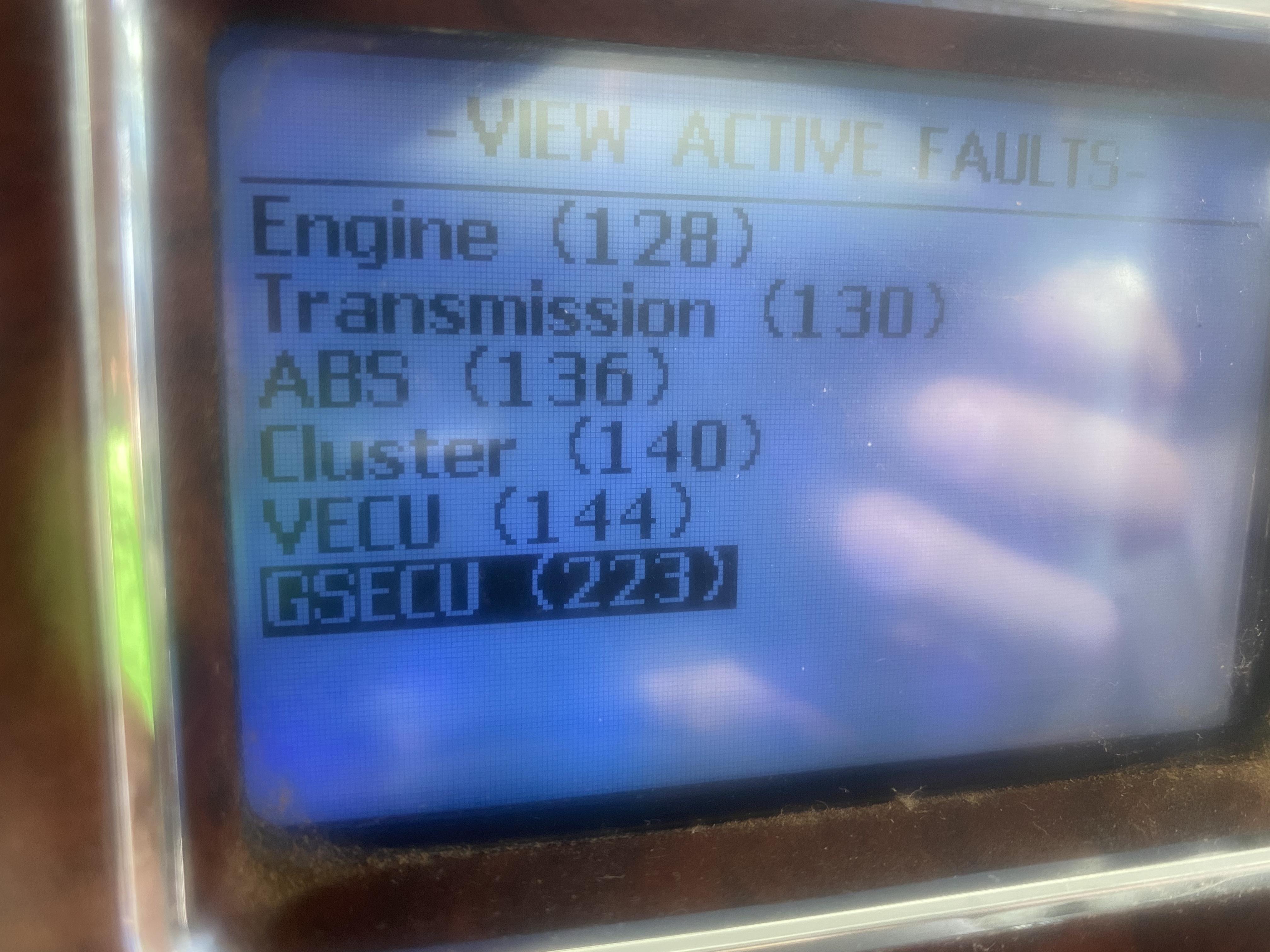

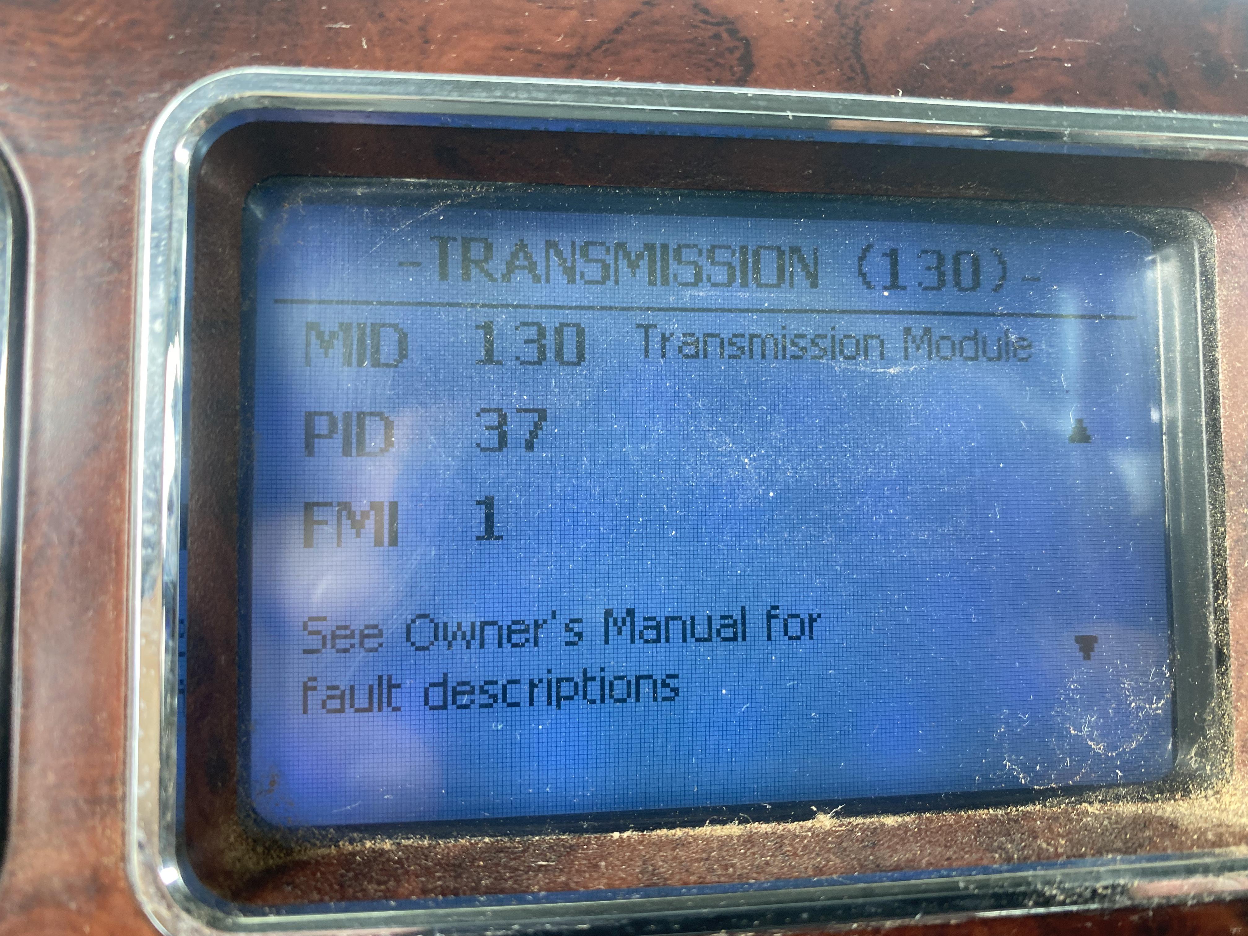

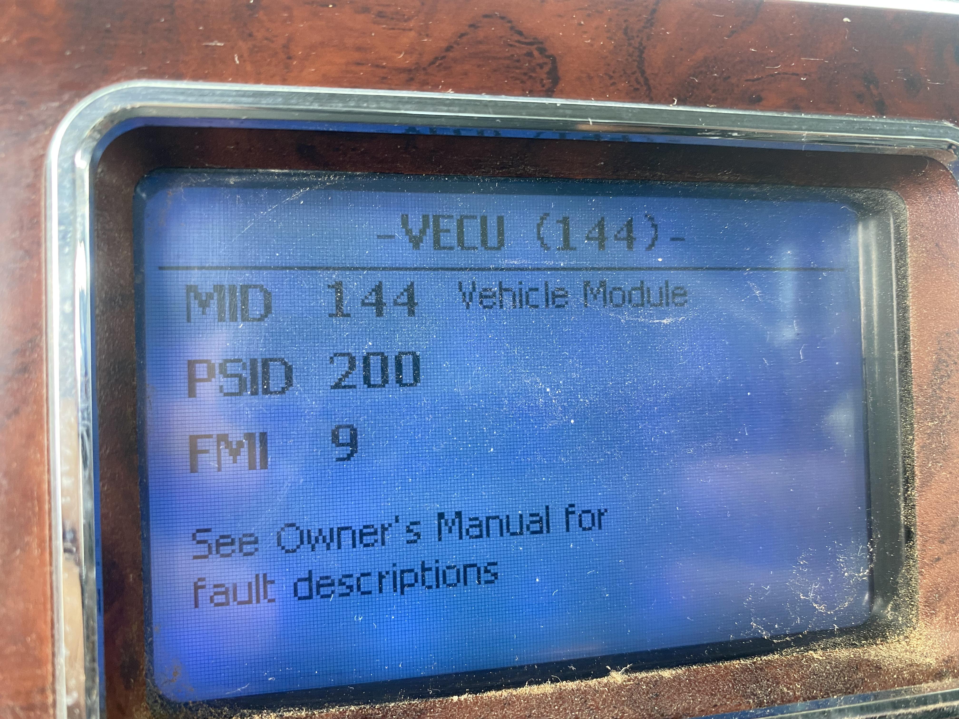

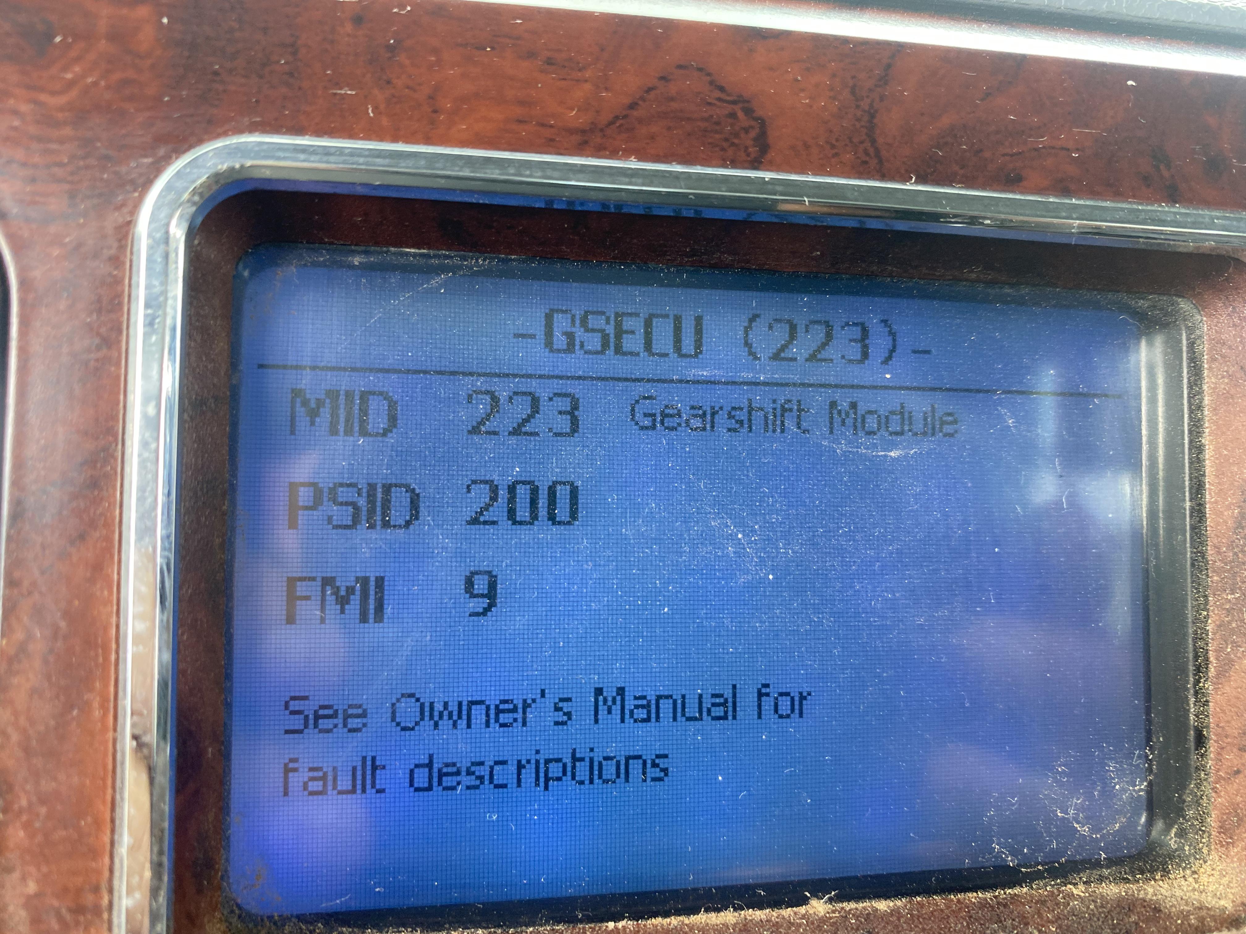

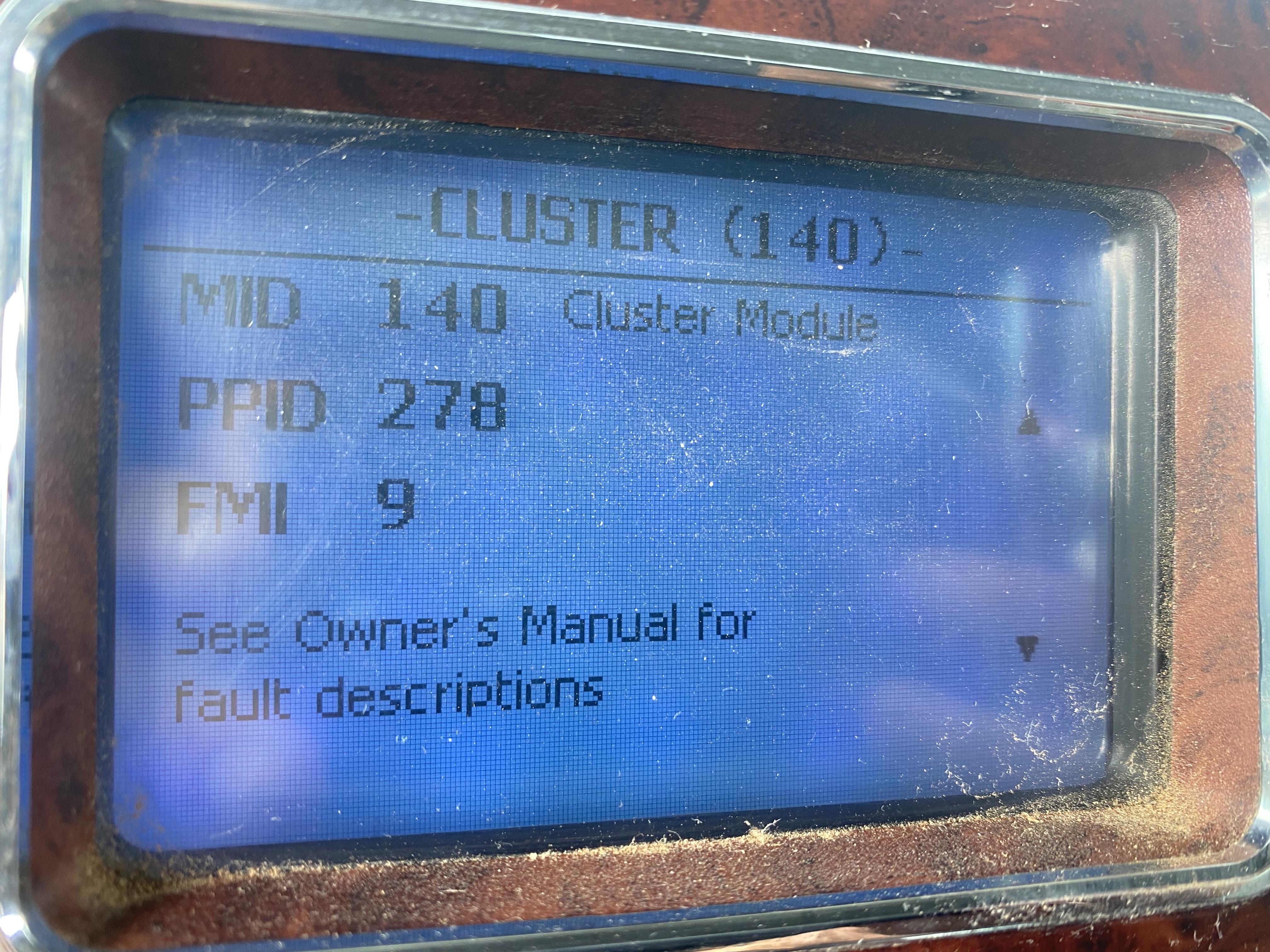

Starter not engaging. Doesn’t turn over. Doesn’t even try to.  Only hear the relay click in the upper dash fuse panel.  It threw several codes. Called Mack dealer and said it has zero communication with one of the ECMs. I attached pics of the codes. They said the FMI 9 code means zero communication.
Since you haven’t had any recent repairs and don’t have PTT. I would suggest starting to look at modules connectors, pins, and harness’s for a start. Also the VECU is programmed to perform several functions including starter control and ignition key switch. Hopefully some more guys that have a lot more knowledge on this will have some input for you. Joey is one of them.

Mack guy came out. Turns out it is the engine ecm. Had little oil at plug from a leak that got in the harness they said. Called wicking effect. Apparently it’s so common they have a term for it!  Put a test ecm on it, cranked up, drove it to dealer to get a reman installed and fix leak.  Thanks for all the help!  I’ll be back at some point im sure!
