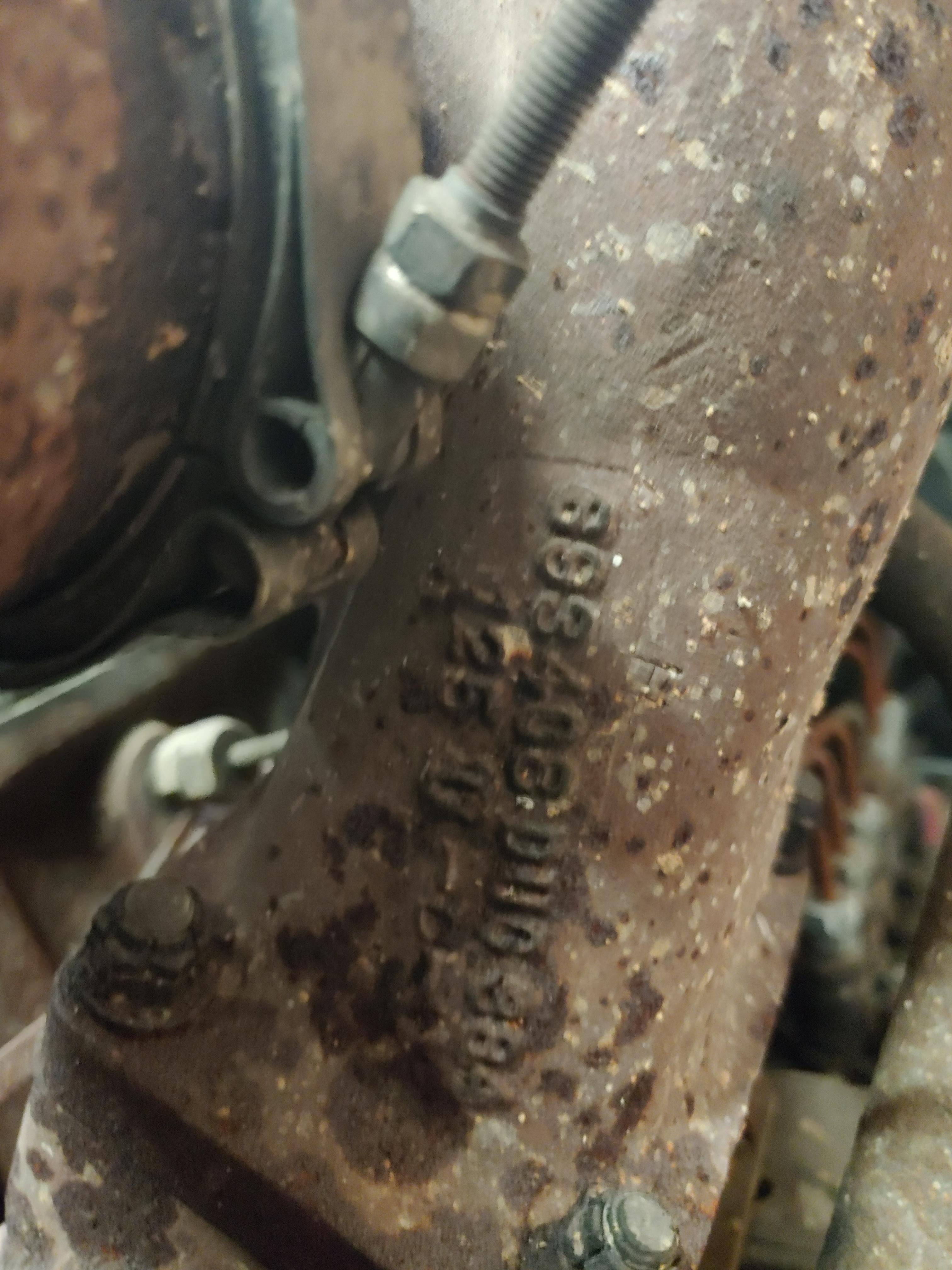

Sorry my Mackites! I've been terrible busy. I haven't had much luck finding a SX300 with the correct exhaust port measurements. I have a reman E6350 1994 birthday, manifold is 2.75 x 4.50. That's center to center on the studs. Coming up with blanks. Anyone with a part number would be awesome. Thanks!
