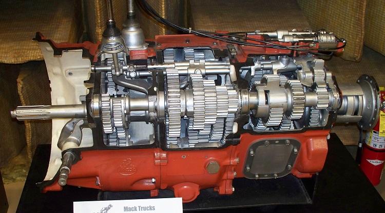

From what you tell it's some sliding clutch and a gear wheel the clutch mates to. Having either no forward and reverse my suggestion is it's not the compound gearbox where the tranny shifts into Lo OR Reverse. If so it means that's the splitter which is assembled in the front portion of the tranny and provides torque to the rest of the gears. The cost of the fix is a gear ($400?) and a sliding clutch ($150?) plus removing the tranny and taking it apart. Personally I never got into a 12 speed and my suggestions are based on the theory. Too probably someone else will give you more exact advices and correct my statements if I'm wrong.
Pull the rear shift cover with the air line's, and inspect the fork and rail for a loose set screw and of course any other damage. It sounds to me that, the truck was low on air pressure,  and when it came up, the range clutch tried to engage, and ground itself a bit....  mabey it's just stuck between ranges, not saying it's not 'hurt'...  jojo
In the rear section of the box you have high split, low split and reverse
The high-low split and reverse are mechanically interlocked, it sounds to me that these have bound up for some reason and I would do as Joey suggests
Pull the lid and have a look
This is a fare bit of stuffing about to do this but it can be done with out dropping the box out
If its a air ride cab stick a jack under the cab between the  chassis rail and the cab floor and jack it up as high is it will go without damaging anything
With the floor out and the cab up you can get it out okay, getting it back in and lined up right is the hard part
But before you do all of this, can you hear the shifters going clunk etc as you rotate the knob  ?
The mechanical interlock is situated in the blue circled area, theres a nolt doo hicky were the arrow points were the mechanical interlock comes outfor working
Paul
