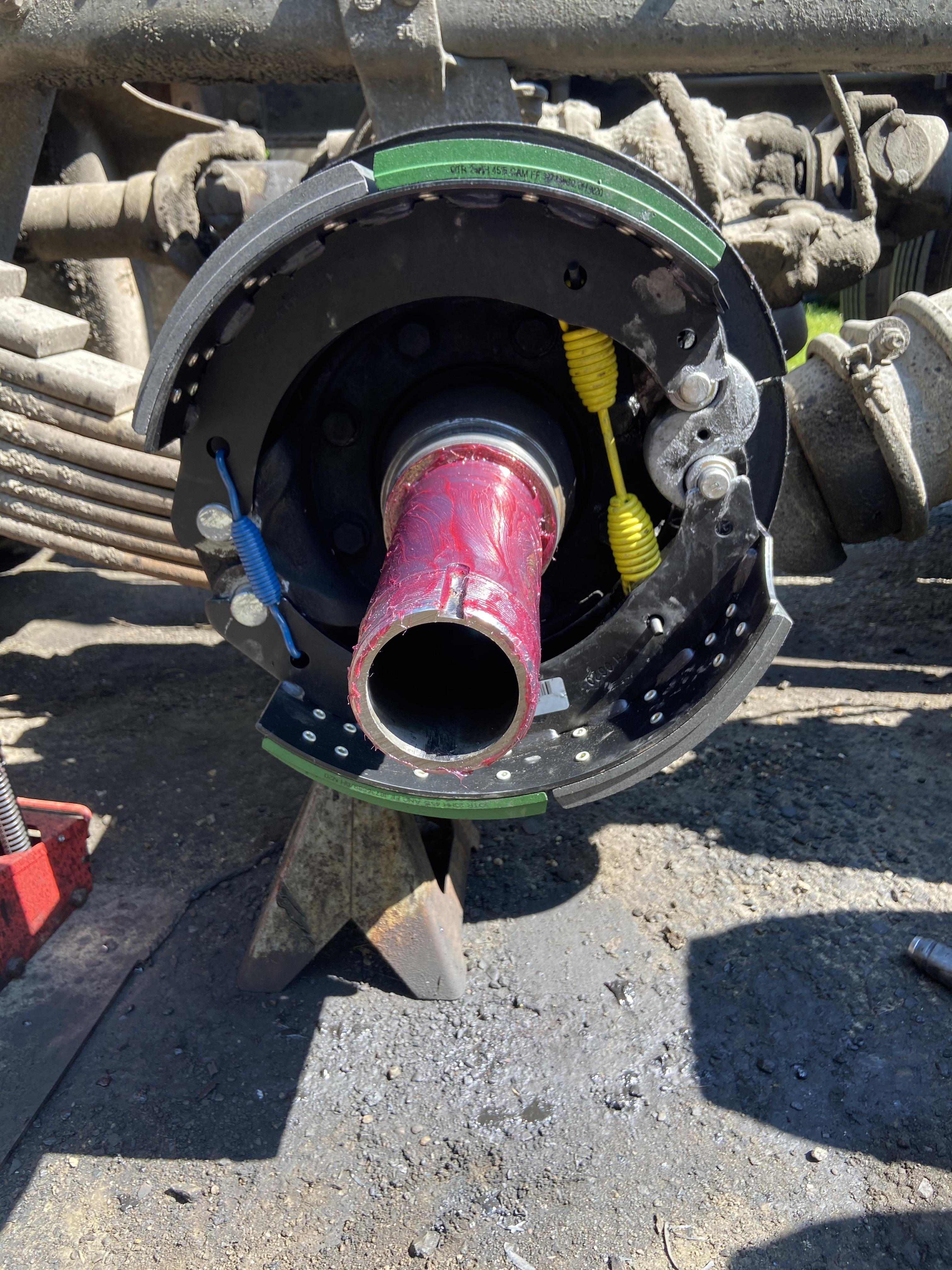

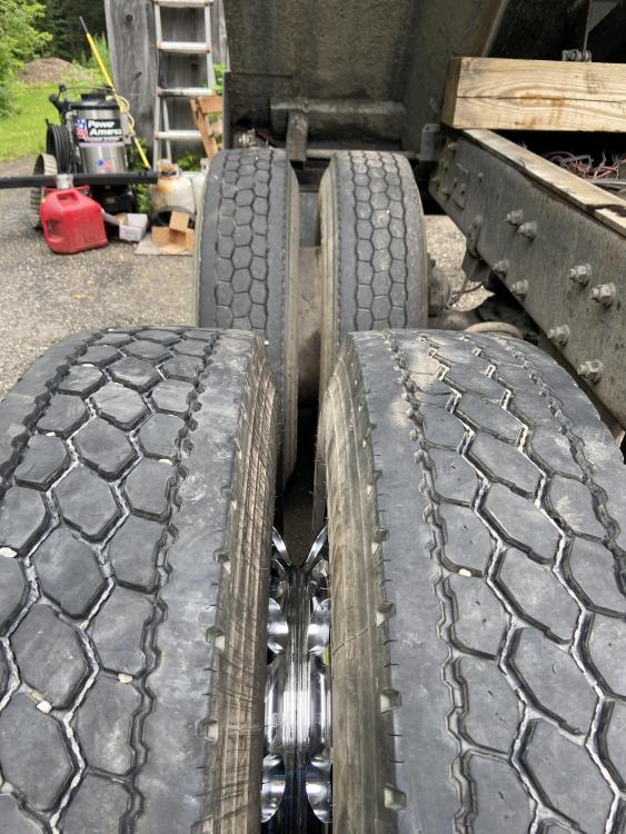

I finally started my hub pilot conversion, kind of had to as you will see in the pics lol... Anyway a few questions for anyone who has done it as I cant seem to  get a concrete answer around here... My spoke hubs had the bearing spacers or washers that slide over the spindle and rest between the spindle shoulder and inner bearing, I was told both to use the spacer and not to use it UGH ! Here are my concerns, check out the pic there is clearly a huge difference in the offset of the bogeys, but will obviously equal out when I'm done, second, I wasn't overly thrilled with the short distance my Voyager seal slid onto the spindle shoulder but that said I've run the piss out of her for 2 days now and no leaking seal... Anyone who's been here please chime in ! I'll post the pics....

I would use the brake shoe as a guid, if it's still sitting in the drum in the correct position I would call it good

I also like the idea of checking the hub position by observing relation of the drum to the shoes. The spacers/washers were definitely used to make correct hub fit. Too probably there were different styles of hubs used with that axle housing and there was a need of spacers in some wariations.
I once also met something like your situation when changed bearings on a MH-model. The axles were Mack on airride so I supposed they were 38000lbs. The hubs were spokes to fit 24.5 rims with Mack script cast on them. The bearings were 582/572 with 563/567 as it supposed to be for Mack axle of the spoken axle rating. But the seal was NOT 4-1/2 x 5-3/4 as it typically is (and should be) but 4-5/8x6. There were spacer sleeves pressed onto the spindle shoulder to increase the OD from 4-1/2 and I would expect that as a home made conversion. But the hubs were bored to 6 inch not 5-3/4. I too doubt someone machined the hubs for larger OD seals but who knows.

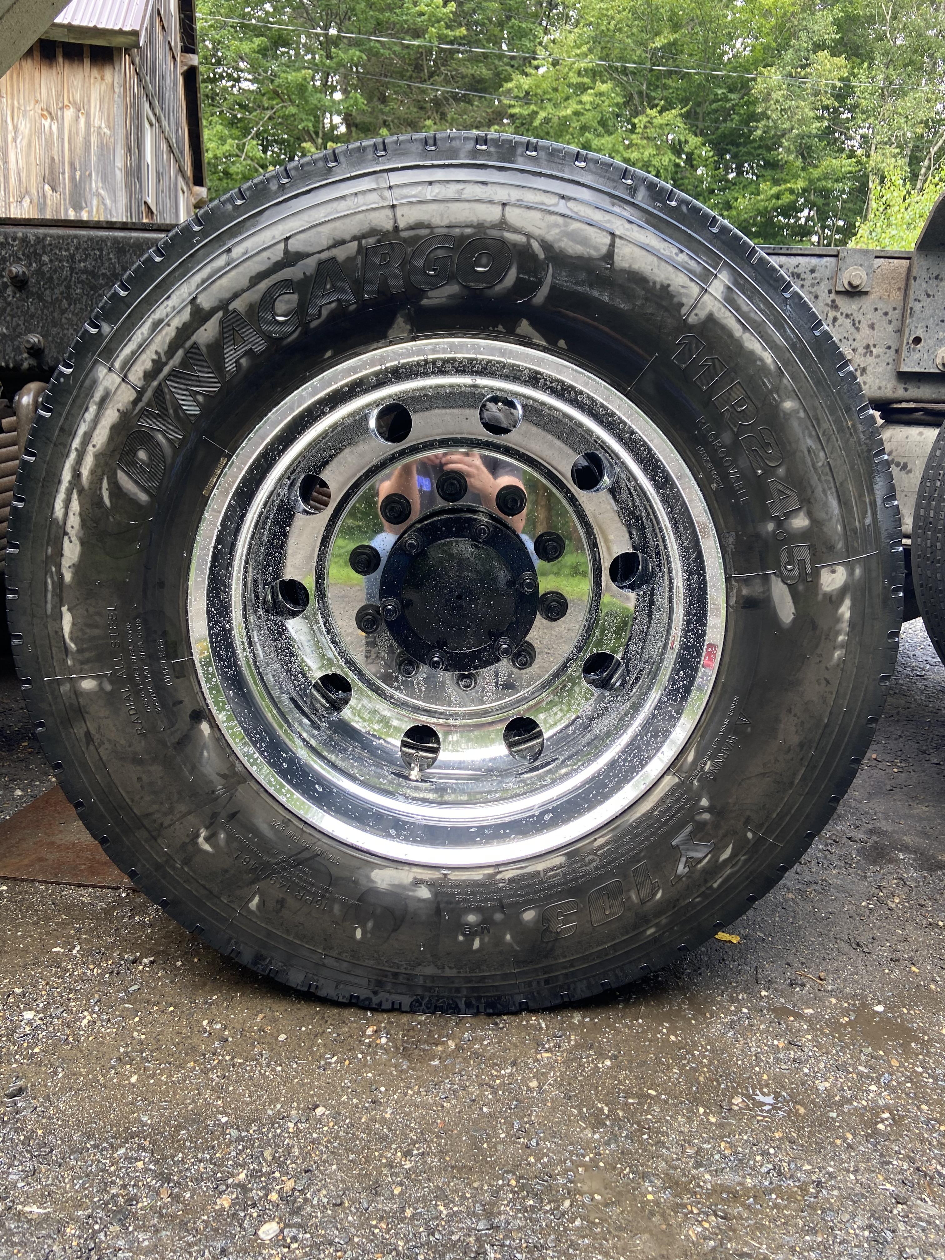

Well 3 years in and I must say hub pilot conversion is the best thing I've ever done to the old girl bar none... 2 things to say, first the truck should have been ordered hub pilot, second I should have converted it 20 years ago when I bought the old girl... Now I just need someone's recipe on building a 600HP E7 !
