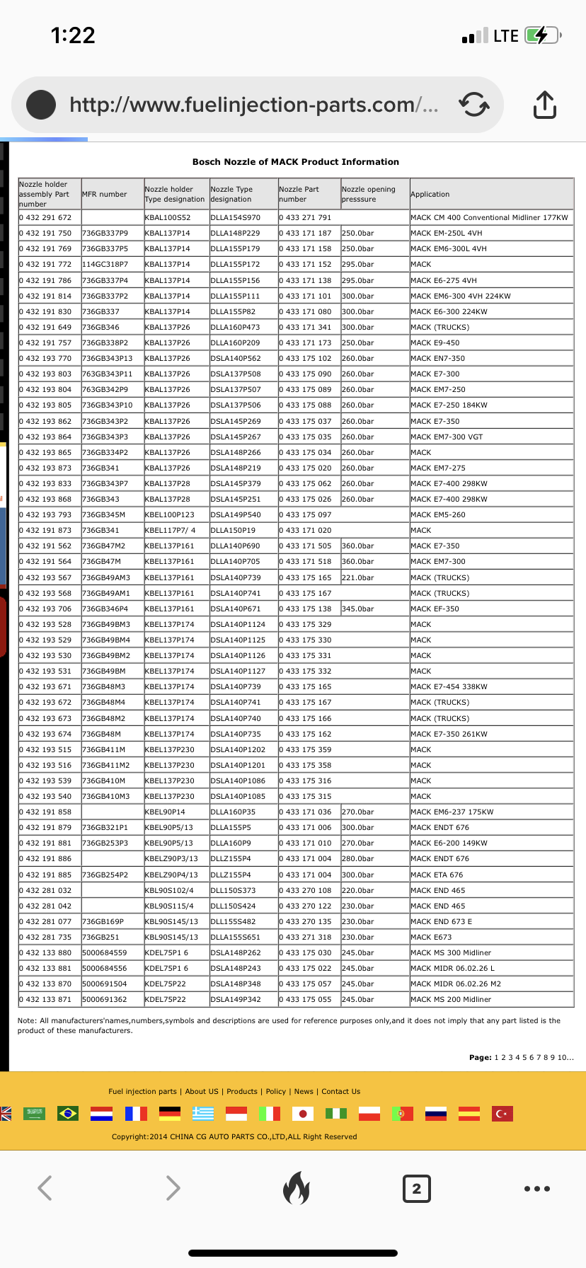

Thank you. I probably saw this chat before. Or its clone. Unfortunately it doesn't look trusty enough.
First of all I don't see my engine there although it's pretty common E6-350 4V. The table conteins EF-350 which is the most probably a missprint since I too doubt EF engine model by Mack ever existed. Another smoky point is there're plenty of strange Mack engines showed in the table. Such as EN7-350, EM5-250, E6-200. And at the same time you don't see such typical engine like E9-500 there.
