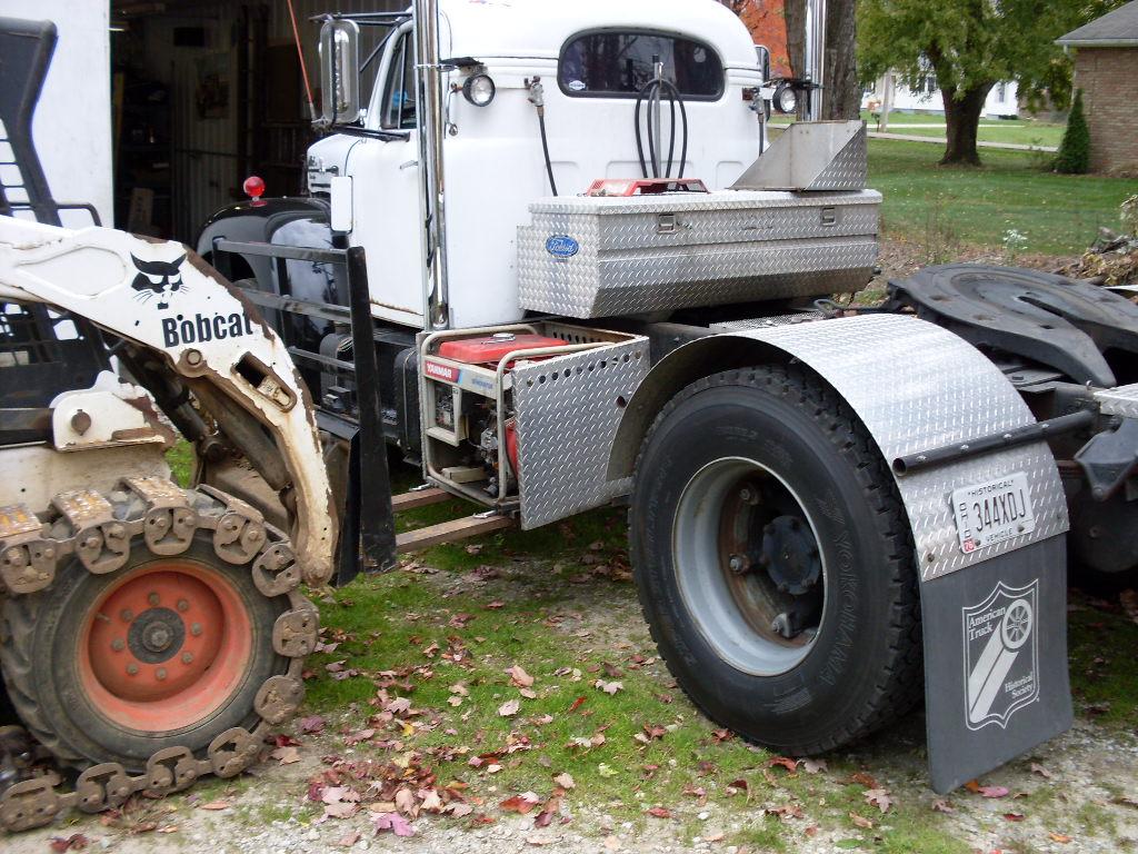

Way back I did the same thing, mounted a truck toolbox across the rear of the cab for holding stuff because in a B model there is no storage room!!  The truck had come with a ~24" side box but that was too little.
Here I am dismantling the truck to stretch it.  I had a yanmar diesel genset on it then, I have an Onan 4K on it now.  Something you might consider is having a box made and hang your genset on the frame.
