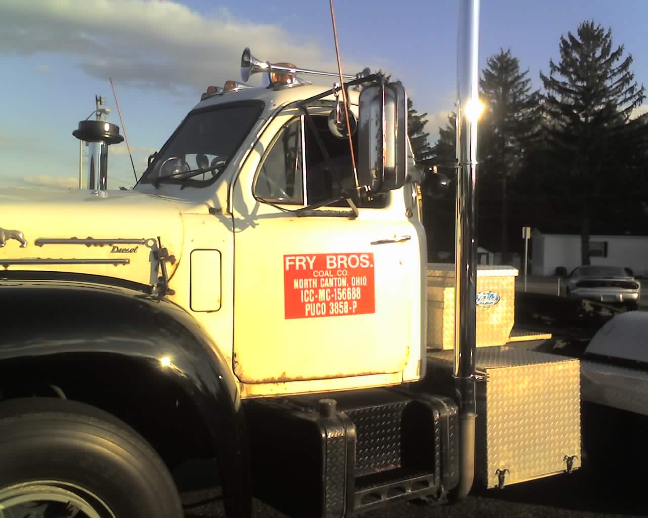

I'm going g with dual stacks on my B-61 but I see that the last fuel tank is bigger than the right, presumably the right is smaller to allow room for the stack. Had anyone added a left stack while still issuing the bigger 50 gallon tank and if so, got any pics??. I could use another right side 40 gallon tank the left but then would have to relocate the saddles but would rather not if I don;t have to. Suggestions?

I've seen a few variations of putting a left stack on a B model.  I went with using another 40 gal tank and just duplicate/mirror the right hand top and bottom brackets.  I didn't have to move the fuel tank brackets, as the tank is just longer on the one end(the end that would cover the left stack area) and using the right tank will just slide right in with no fuss and clear the stack.
