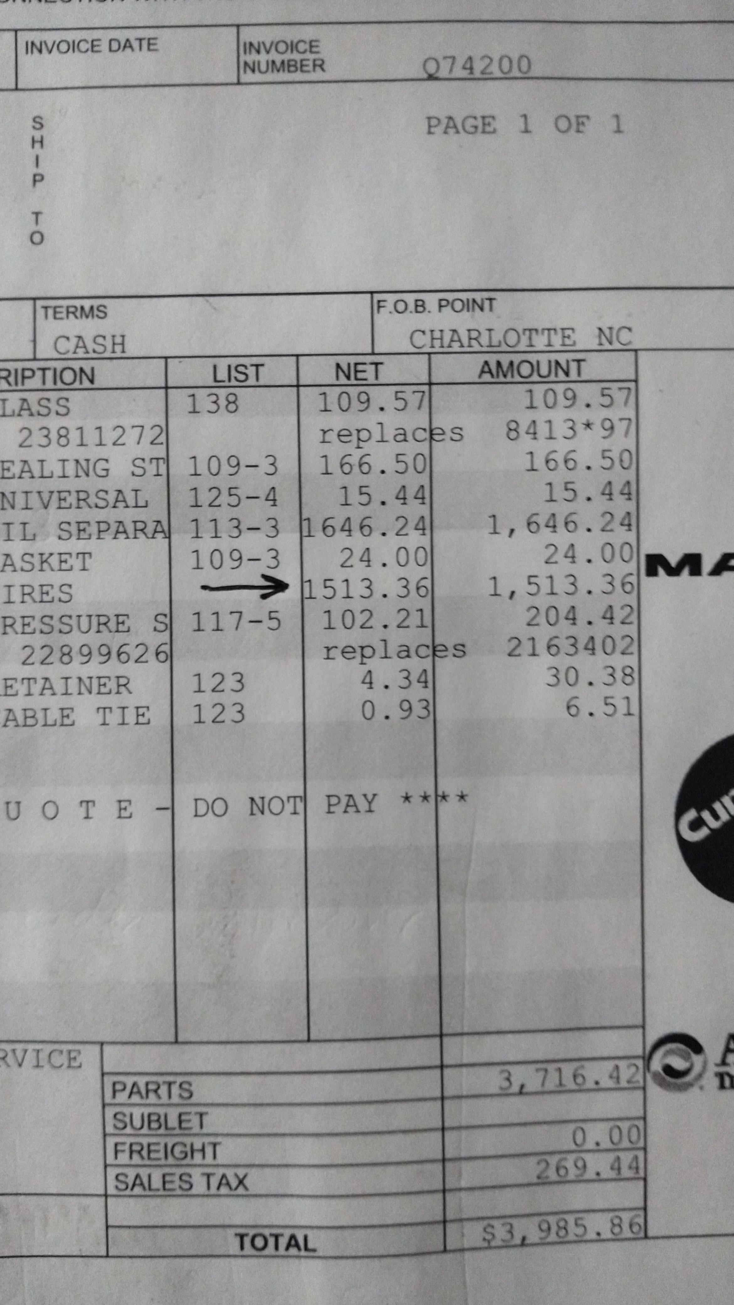

Well looks like we figured it out, engine harness! Changed the main on engine harness, not only cured the intermittent lag/low power, but also what everyone thought was a weak cylinder when cold, missed erratically until warmed up(we were prepping for a inframe OR a Etech swap, harness cured it. Im liking her a lot more!
Curious, how much did the harness set you back? We just bought a 2003 AI350. Harness seems ok... For now....
I'd love to know as well,  I've had the same issue since we bought this truck.
I'm curious too.. I just put a harness on an MP-8, and it was over 1500.00..  I did 1 Etech and 2 ASET's last year and I think they were around $1300.00...  jojo
  • 1 month later...
one of my current customers sent me and older E-Tech wire harness for me to inspect for re-use, because he said a new at Mack was $1400.00..  He is a smart man with a lot of knowledge, so I assume he is right..   Jojo
It may well have been around there, i just remember my mechanic saying he had changed one previously that was like $3500 ish, so i was mentally preparing for that, and it was well less than half, so i was happy!
