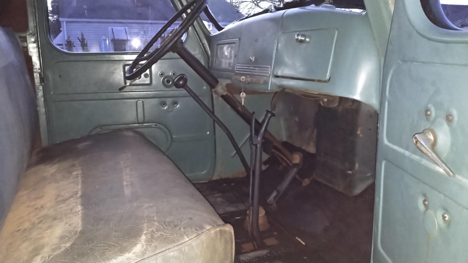

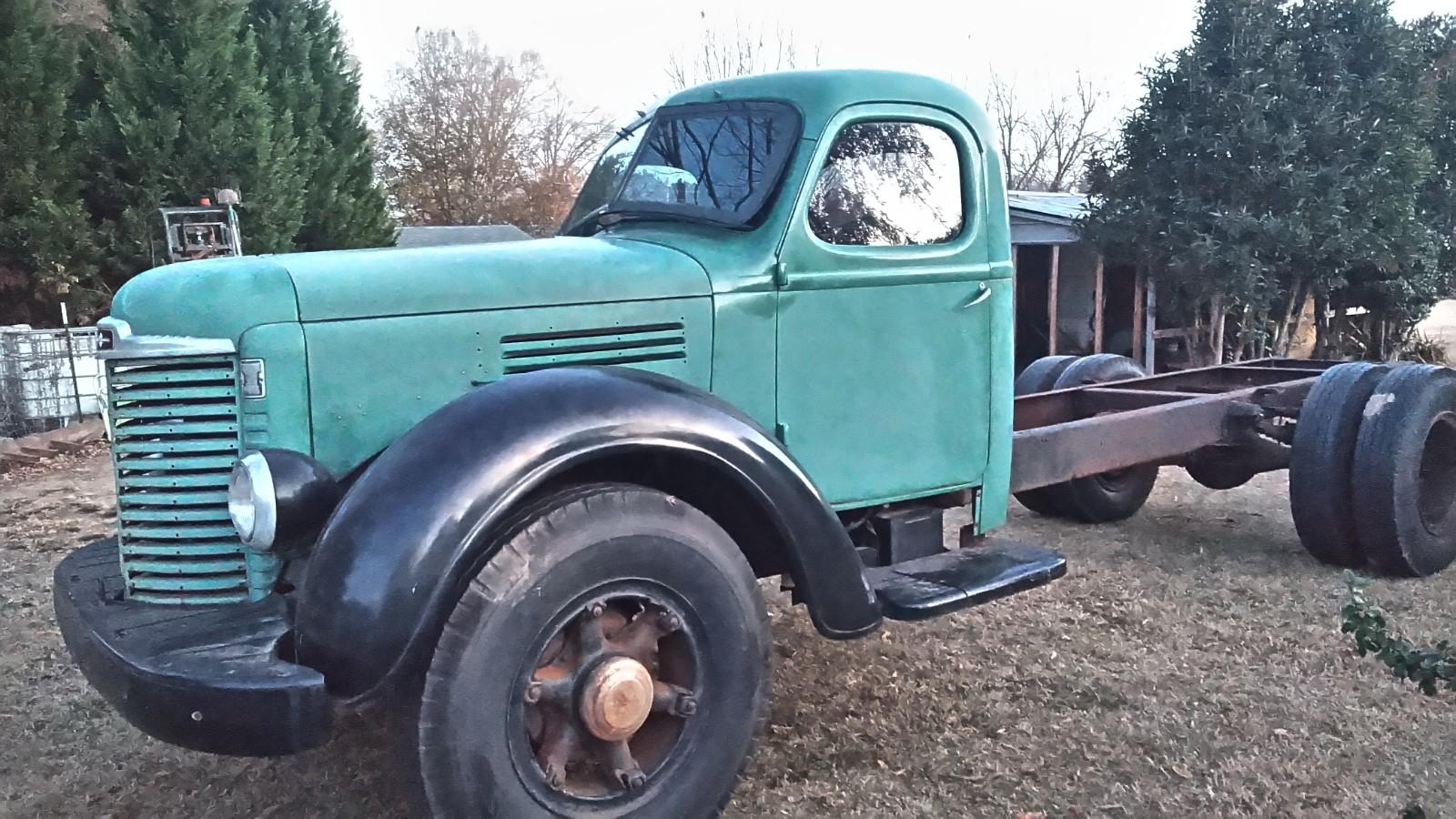

Thank you very much! I guess I will put a rack body on it and drive it to the grocery store and run errands around town.  We have a few truck shows close by, I hope to be in them, and maybe Parades. I have to get the brakes working, and replace all of the wiring. (I will leave all of the original wiring in place so when I do go to shows, folks can see how it was made back in 1948). I also need to find some mirrors. I just put the glass in it last week.  It runs good, I have driven it in my neighborhood, I used the hand brake to stop it :) .. jojo
