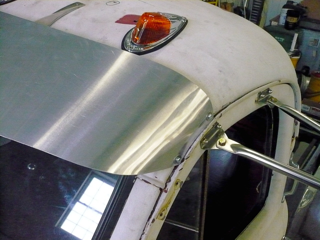

We built a sunvisor.
I'm pretty happy with the way it looks but it was more work than I expected. There was a lot of trial and error involved with getting it to fit properly.

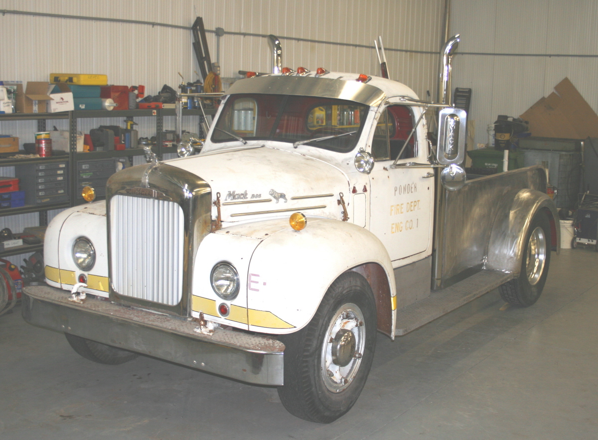

We've got the new exhaust pipes standing in place but we're waiting for the shields to come in before we actually mount them.
We're almost finished with all the mock up, pretty soon we'll be pulling the cab off.

Mike, We thought seriously about doing that. We've got a set of side pipes for the race car and since we're going to paint the Mack to match the car the side pipes would have looked good. But the truck already had running boards and I think the International diesel might smoke a little once we get through adjusting the fuel pump. I think the vertical stacks will look good when the truck is hooked to the trailer.
We actually welded the hose holder trays that came with the truck into the front corners of the box so there would be room for the exhaust.

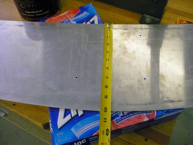

Paul, I don't think we'll be making any more sunvisors. I'd like to say it's really simple to build one but it's actually pretty time consuming. The design is simple enough but here's a lot of trial and error involved trying to get it to fit and look right.
My first plan was to make a more peaked, Peterbilt style, visor but when we mocked one up we just couldn't get it to look right so we ended up just going with a curved visor. We would have preferred to make it out of stainless steel but settled for aluminum because it was a lot cheaper and easier to work with.
I think anyone could make one, it's just time consuming. I'm happy with the way it looks but I also think one of the Lund style visors would have looked good.
I'll try to attach a larger picture, as you can see it's really a pretty simple design.

LOVE the visor. I've had visions of something similiar to that also. It comes to mind the version they have in Austrailia and I think Barry was trying to work on getting some over here. Been some time and not sure it will happen. The Lund version is just too late model and takes away from the roundness of a B model(in my eyes).
I figure some thick cardboard and sissors and lots of mock up I could come up with something close. Polished stainless would be the catseyes, but be very difficult to get curved properly.

We pretty much did what you described, cardboard and sissors.
It's a lot easier if you've got a second person to help.
I made the brackets that hold it onto the roof a little too low so I used some strips of teflon as spacers. You don't really notice it unless you look carefully.

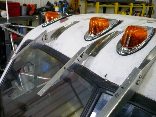

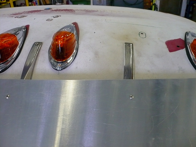

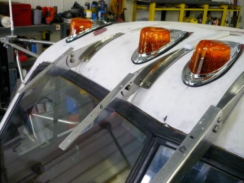

I took some close up pictures of the sunvisor and brackets. We just used small screws to attach everything to the roof for now but we will use different fasteners when we actually install it.
I'd love to make the Gasser show, maybe this year?
Since you're still taking things apart........I bet it really looks intimidating. I know how that goes!
Awesome job on the visor and the mounts. The roof pieces look premade from something else(stainless steel?)? The adjustable part looks like aluminum and likely you made? You did the exact thing I've had floating in my head for years now. I wondered about supporting the visor in the middle, but with the roof brackets that is eliminated.
Does the visor screw directly into the cab roof on the ends? Or is there a bracket under there?
Larry
Larry, I didn't see your last post. Yes the visor is screwed directly to the roof at the ends. The screws are just temporary, I've ordered some steel threaded inserts that sort of rivet into the roof. That will allow us to use 1/4" bolts. We've got some of those inserts made out of aluminum but they're not very strong.
We made the part of the bracket that mounts to the roof out of stainless steel. I find stainless kind of hard to work with but I find it even harder to weld aluminum, so it's kind of the lessor of the two evils. We'll polish up the aluminum and stainless before we do the final installation.
