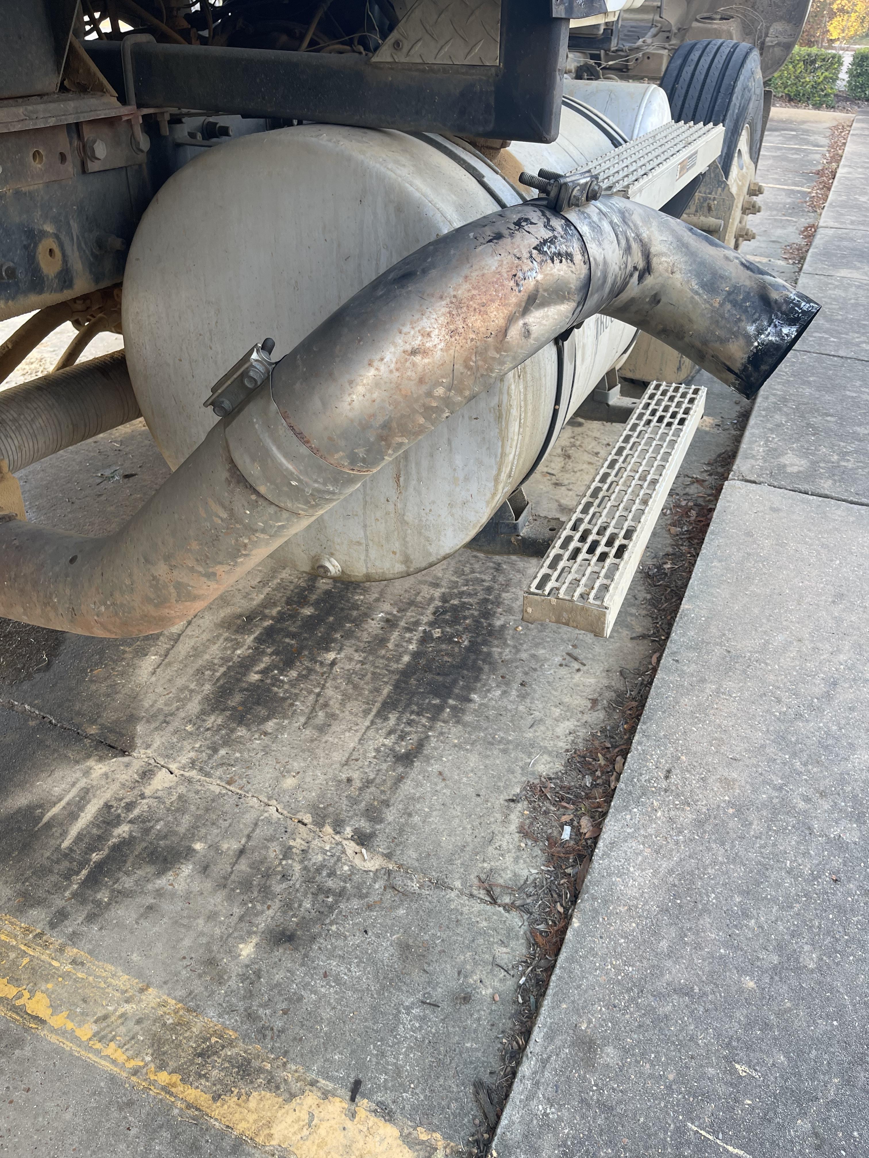

Hello Everyone

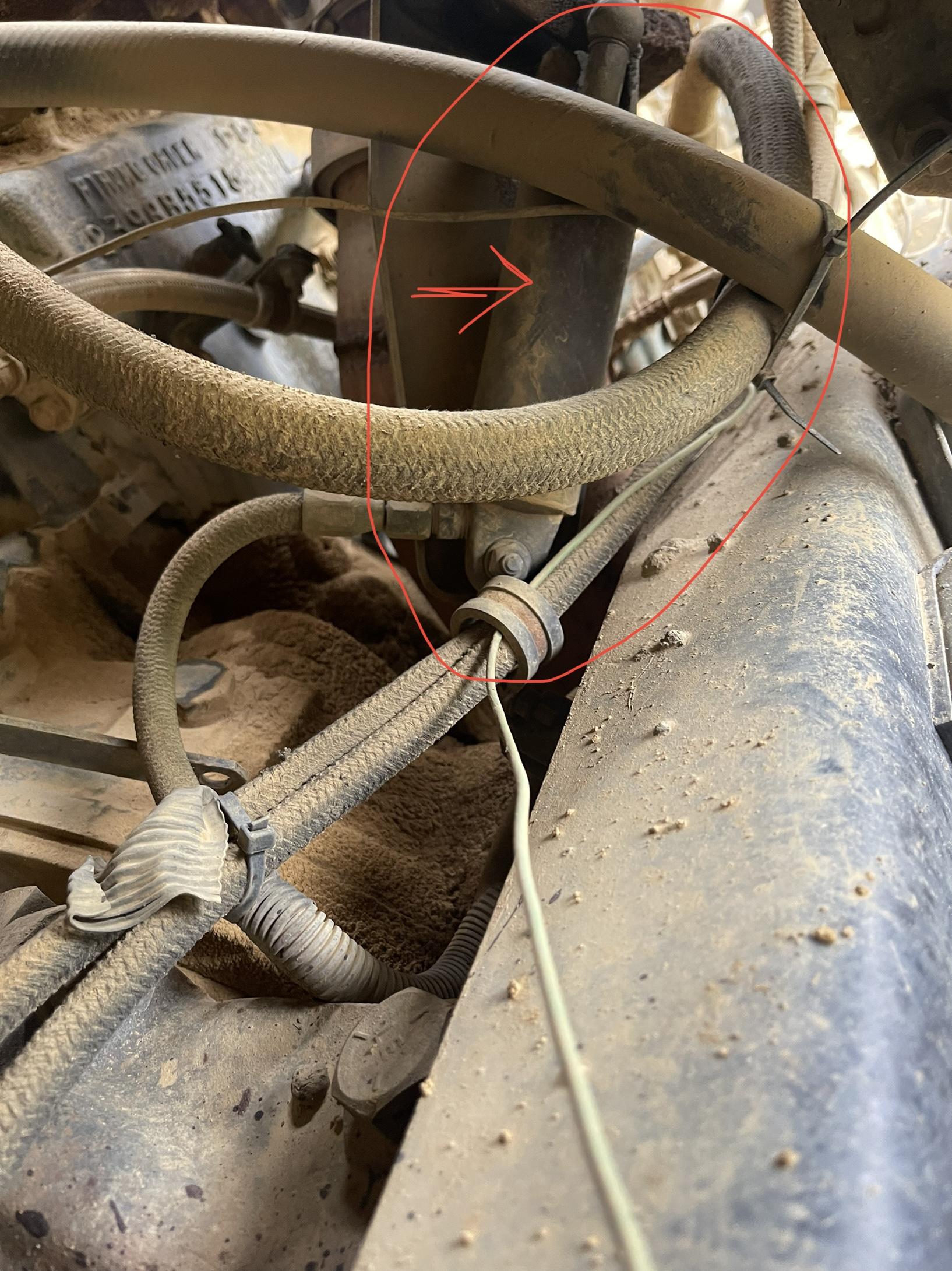

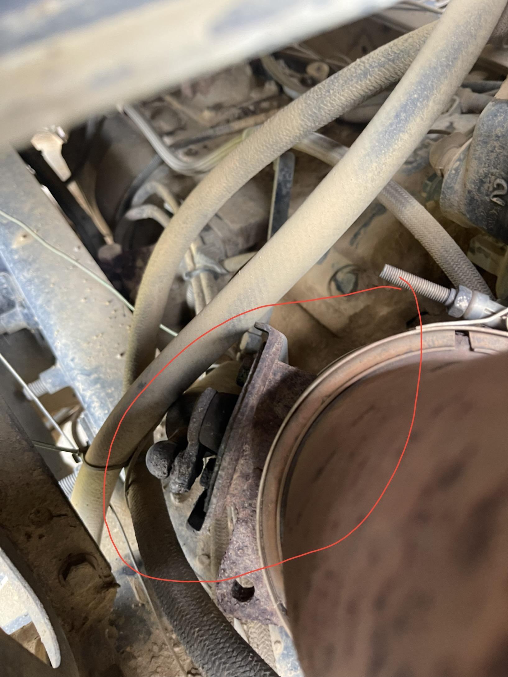

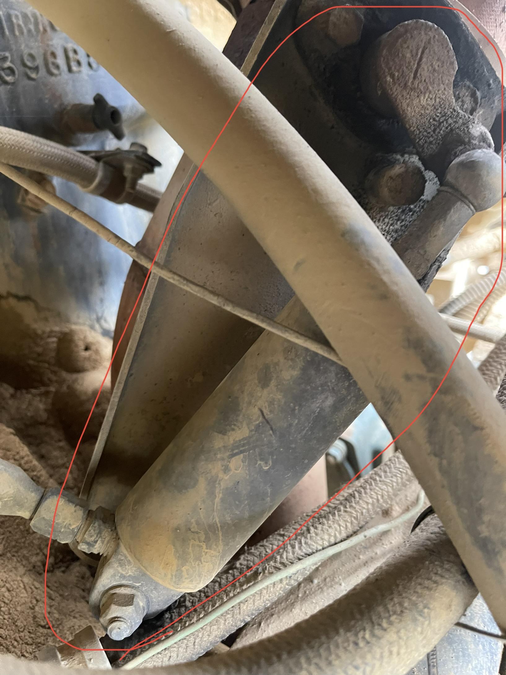

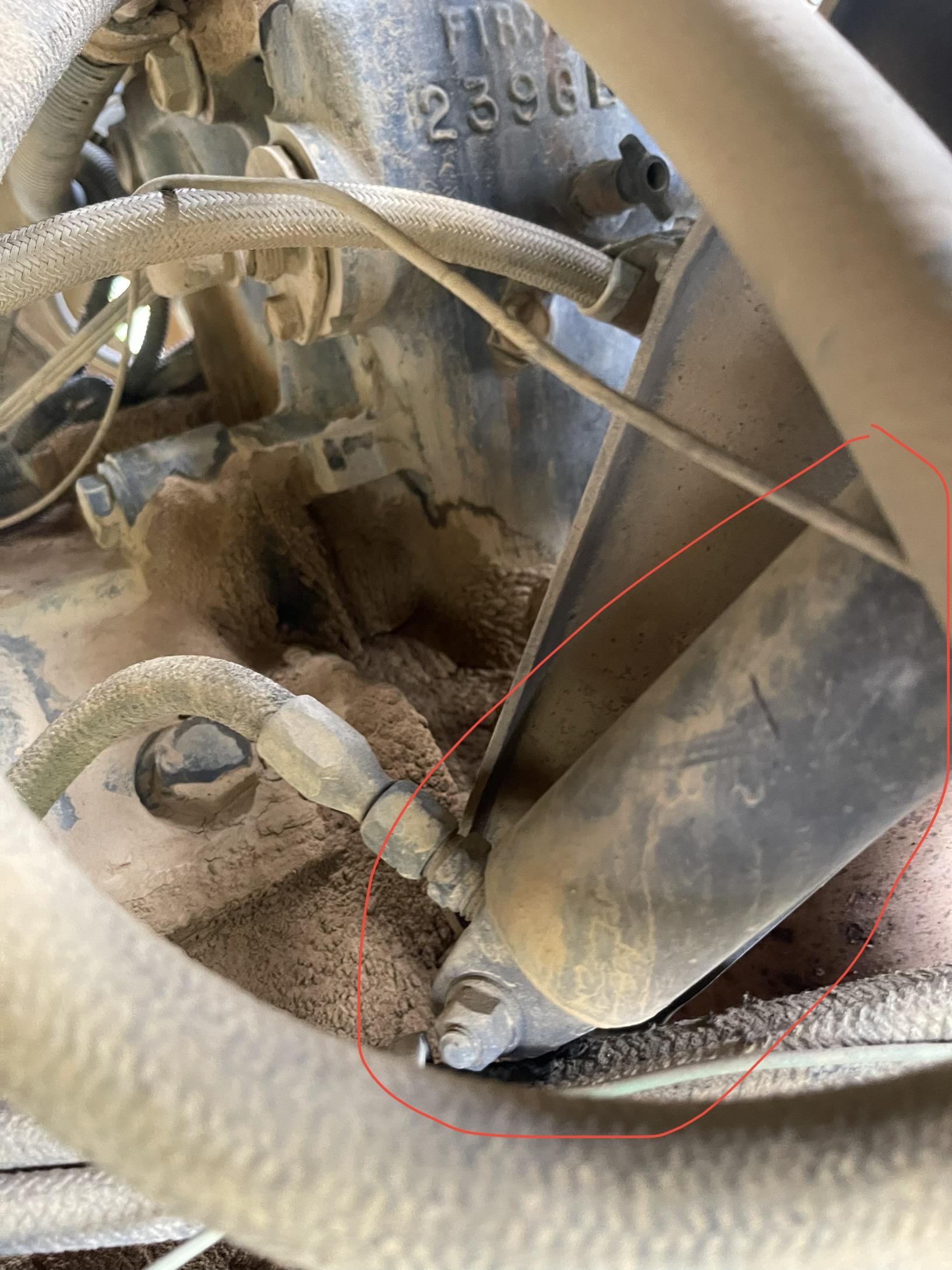

I’m trying to reroute my exhaust and put a muffler on my truck right now it’s straight pipe. I look at the pipe coming from the exhaust and saw what looks like to me a little cylinder or a “gate” on the side of the exhaust  pipe with a beaded like at the bottom (maybe air?) Do anyone know what it really is and what it’s for? Please take a look at the pictures. I want to run my exhaust under my cab but I’m not sure I’m I remove this what will happen. Truck is 1997 CH 613 Thanks for any input.

It must be attached to an air solenoid that is typically easy to unhook.  Is it an electronic or mechanical engine?  Does it have an engine brake as well?  I've never seen a CH that didn't run the exhaust right under the cab.  That seems pretty rare on a Mack.

just for kicks, look up 'stealth brakes' this may be one of those rare cases....  I barely remember them add on to assist the crapy dynatards....  I could be all wrong here, but..... jojo
https://www.bigmacktrucks.com/topic/68601-exhaust-part/#findComment-482085
That's a Stealth Brake and it is intended to work in conjunction with the Jake. If it's removed (if it even still works) you may want to consider resetting the lash on the Jake. That exhaust brake enables it to have a larger lash than a non exhaust brake should (should ) have.

Being mechanical it is most likely to have an internal or external throttle switch on the injection pump that could be unhooked as well.  It seems you would know if it was operational or not and should have a dash control switch like an engine brake.  In some cases they can work as well as an engine brake and are utilized in situations when trying to avoid the noise of an engine brake.

All our 97 ch have them. They’re electronic engines.   The solenoid will be on the passenger side inside the frame rail behind front tire.   On our Jake switch, 1 was both heads and position 2 was both heads and butterfly.   Worked better than nothing but not great.

I Have an electrical pump(grey plug on the side) so would this make mine like yours? But I don’t have a switch on the dash I’ve had this truck since 2013 and never used an exhaust brake. I only found out about this because I decided to reroute my exhaust because it got damaged
