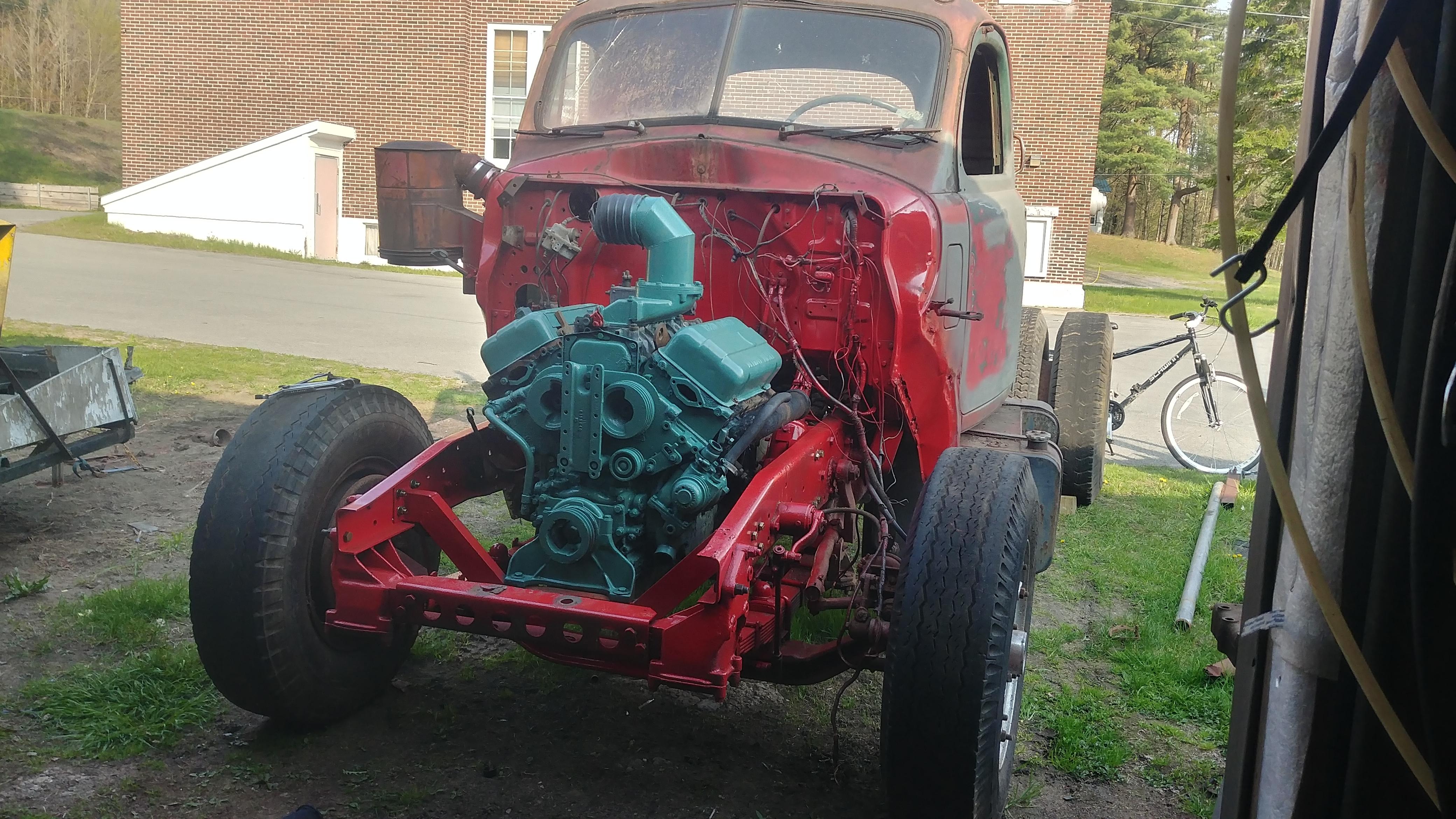

Hello everyone,  Hope you got your junk put away...the white stuff is a comin here in the Northeast.  I had a guy stop in the shop last week and informed me that he has a 1958ish B Model with a diesel and triplex sitting in the weeds. Frame was cut at the front spring shackle and the outer fenders were gone but the rest was there. I have not seen it in person yet, but the price sounded real good. Soooo.  I want to know what you think about a triplex behind a 6v53 Dripoit.  Is it even possible to bolt it up.  The Detroit is a SAE2 and I have no idea what the Triplex is...PS.  Don't be haten

I've got a 6V53T in my B85F.  Allison automatic behind it however.  Fantastic motor as a replacement for this sized rig.  Pretty sure the triplex is a single countershaft transmission.  Not sure it would handle the torque of the 6v53.  I mean I think you'd be fine with it as a hobby truck, but pulling a hill with any sort of load I think would be a risk.  Upside though is much of the issues mating a triplex to a more modern engine (ie. 237) may be mitigated by the fact that the detroit is a high revving engine and the issues with the triplex is usually making sure you don't lug it at lower RPMS.
I could be wrong, just what I think I remember reading in the past and from limited experience.

I have got the engine install pretty well figured out and have been toying with the idea of what trans to use.  I have the original Fuller 5 speed that came off the Detroit and I have the little Duplex from the 401 Gas job.  I would love to keep 2 sticks but the Duplex would not enjoy the torque of the 6v53N.  Being the Triplex if from a diesel i thought it would be better suited for the Detroit...If I can make it fit.  According the build sheet it looks like its got a 6.20 rear axle and with 48" tire, 2500rpms and 1:1 in the transmission.  It should run 52mph.  If I push the Detroit to 2800 it should run about 57mph.
What kind of torque is that Detroit rated at?  I see info suggesting 650-666.
I think the n-plex boxes were used with engines rated up to 650 ft-lbs or so.  If that's the case, it should be fine.  Like with a Maxi, maybe keep the revs up...which shouldn't be an issue with the DD.

Certain models of Triplexes and Quadruplexes (and there ARE different models...check your model number) were routinely used behind the ENDT-673C, which was rated at 250HP and 701 ft-lbs of torque.  I have hauled 111,000# with that setup many, many times.

Put the 2 stroke in there!! It's your truck, don't even concern yourself with what anybody thinks. The small duplex is probably a 67 series and it might not like the ride too well. The triplex will be either single over or double over which will help road speed. GO for it and keep us posted
Yeah, a TRT-7220 or TRQ-7220 should hold up fine.  Learn to split all the gears, and that DD would sound great going up through the cogs!  Only about 300 RPM drop if you hit all of them.
