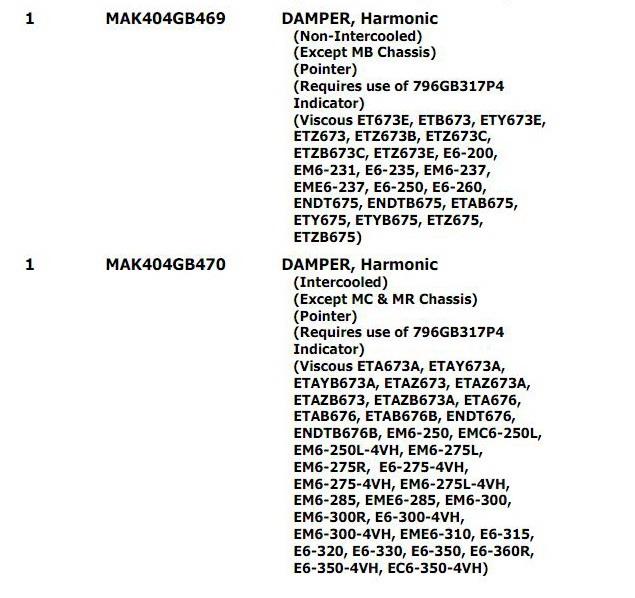

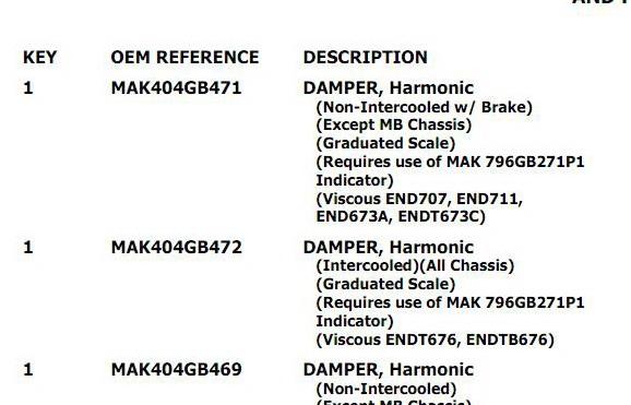

Wow! Thanks. It took me nearly 20 minutes yesterday evening to find a balanser. It was one from PAI though. I don't mean I found it locally, still in the States. It could be delivered to my place for reasonable cost but long in time. The item cost is expected to be US $450-500. I can afford it but there's plenty of other things I may use that worth for.

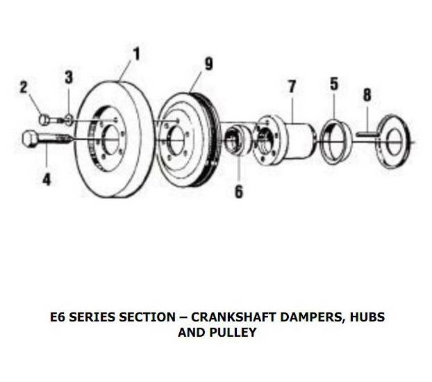

Interesting that PAI states the same balanser should be used on both 2V and 4V E6's along with many other engines. The pics are from some NZ parts list which conteins Mack numbers but its basic source is a PAI parts list I belive.

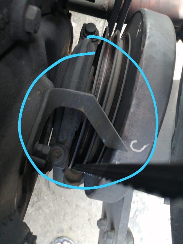

BTW the dampener off my truck is that 404GB470 judging by a mark stamped on it. R688 with E6 4V made in 1988. The pointer is a 2 edged one like on the photo above.
