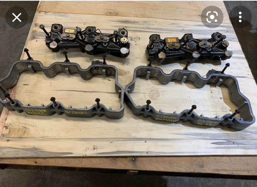

does it run poorly, whether the engine brake switch is on or off? just curiuos,,, is there a 2" spacer under the valve cover and the jake wire plugs into it, or is it just a valve cover and the wire plugs into it?

the lower exhaust bollt are open into the pushrod bores,, when they are not sealed good or just old, they bleed oil. the engine brake wires are on the left side above the intake manifold. 2 wires total.

No spacer under valve cover according to the data plate on the truck it’s supposed to be a e7 427 I’ll see if I can find the plate on the engine
Spacer looks like the one the picture attached .has a grommeted hole for the brake control wire.

no spacer, you either dont have engine brakes or you have powerleash. the wire plug into the valvr cover on the left side's around cyl. #2 + #5..  "V" has a good point about fuel pressure.. put a gauge on the fuel outlet in the block and read it,  60-100 psi....  the wires for the engine brake run behind the water manifolds, and has a 90 degree plug end on it that plugs onto a small post that sticks out of the valve cover, or spacer depending on the engine you have..  jump up there and take a look...  pics. would be helpful.. for engine brake I.D.  the rough running part can be many things...  More guys will comment on this, so do youre best to be specific about the symptoms,,  keep in touch, jojo
