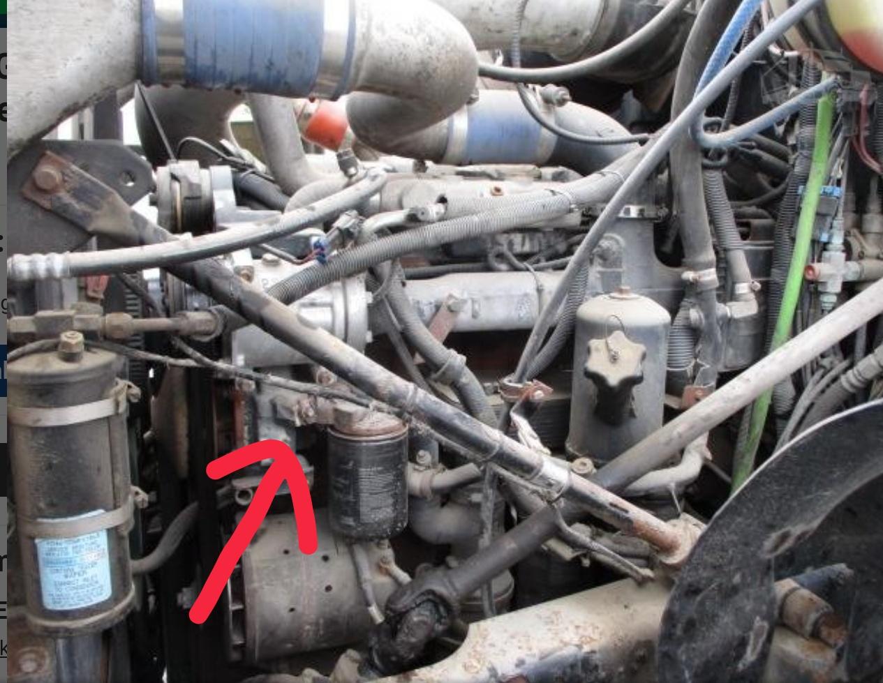

My cv713 did not come equipped from factory with a coolant filter .I would like to add one.attached is a picture of a truck that has the mount for the coolant filter , mine has two npt plugs in its place.Does someone have the part number for the coolant filter mount?or is just better to install a generic one from Amazon or eBay that mounts to engine or chassis.thanks

how about taking the last six of the v.i.n. on the truck in the picture and calling Mack to get the part or the part number.? Mack pricing may scare you, but if you have a parts guy who is friendly with you , he can give you the part number.. jojo

No such thing in my area.they keep part numbers more secret than the coca cola formula

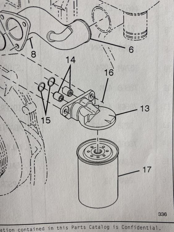

the mount you want needs to be a Mack mount...  you could just for kicks, measure the diameter of a coolant filter and check the threads,,, metric is my guess....  take the measurements or your friends old filter to NAPA then buy a spin on fuel filter with the same dimensions, and then you will have filtration without the Ph balancer pellet inside.... just a filter...

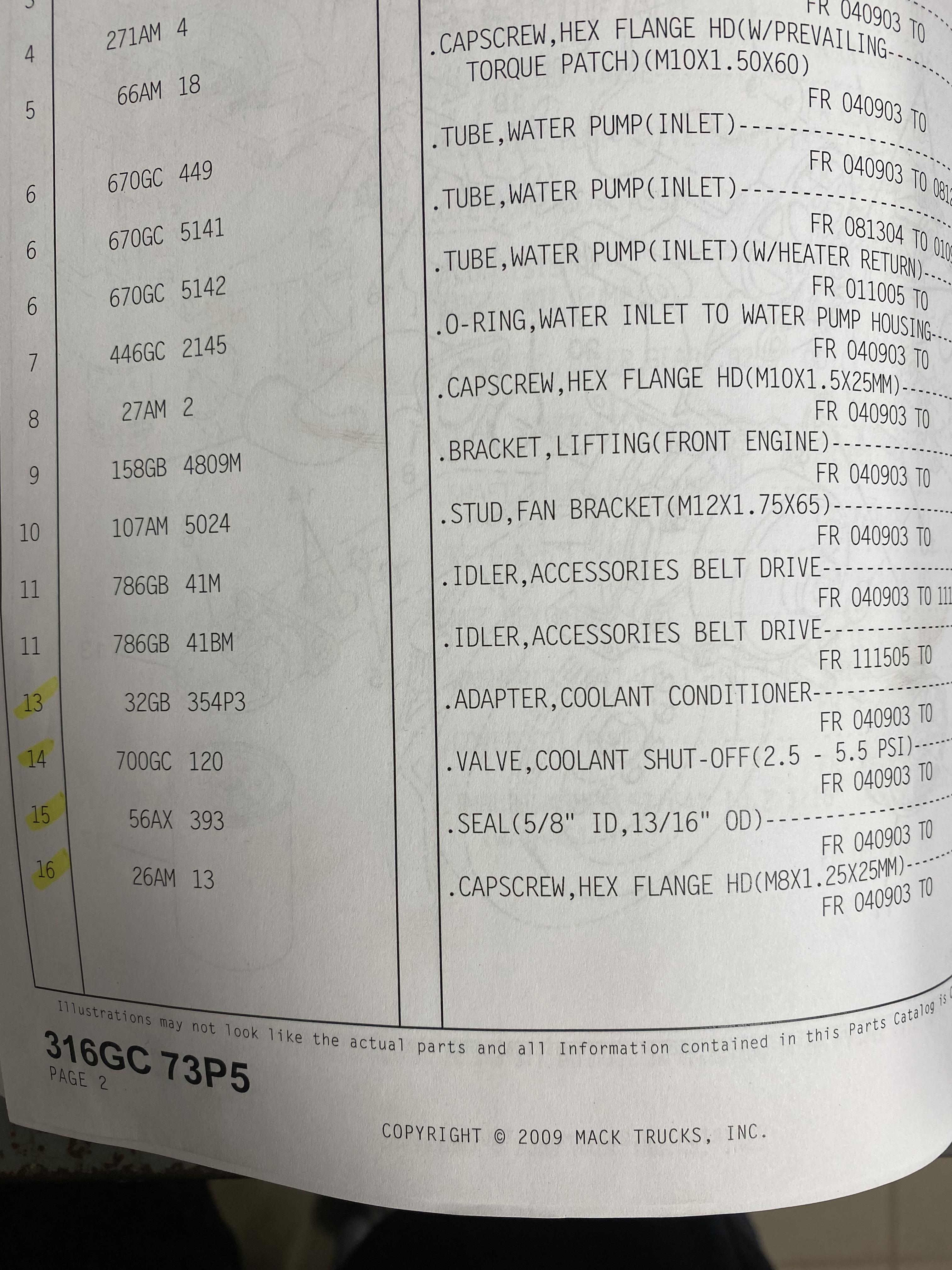

I’ll check our parts books or Mack truck portal on Monday for the part number. If for some odd reason I can’t find it there, then ill have you give me your last six and I’ll call Bergeys Truck Center and get it from them.
Haha, thanks. Appreciate that, I actually learn ALOT from Joey Mack, Vmac3, Glennakerstwo, fjh, and a bunch more guys on here. I’ll see about getting that part number first thing Monday morning.
