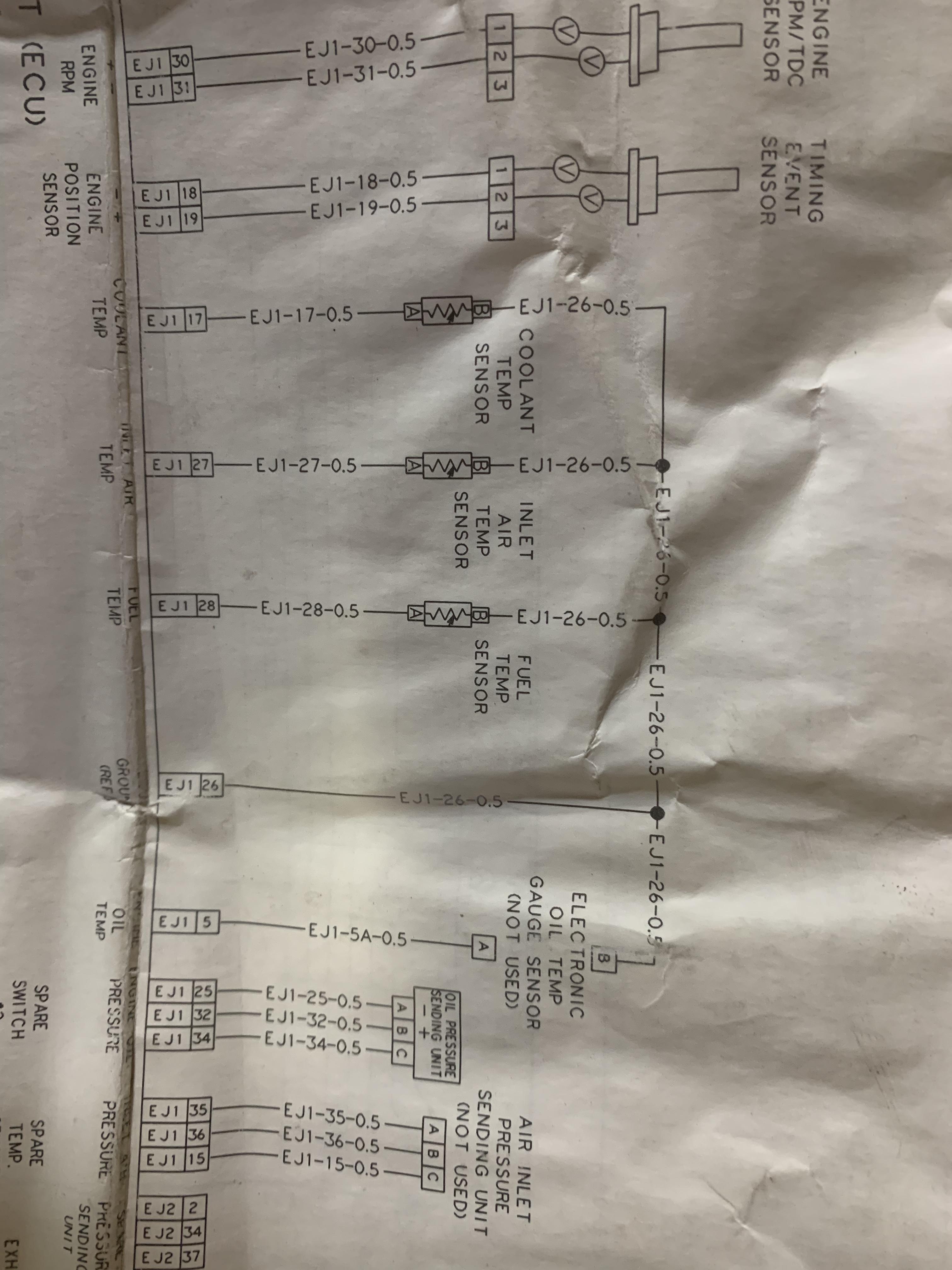

Odd thing is it has that malfunction light on with those codes will set an run normally you leave with it an out of the blue it will kick the shut down light on and shut it off.   May have to stop and restart it may come back 🤷.
what does that ambient temp sensor have to do with anything?
https://www.bigmacktrucks.com/topic/68848-blink-codes/#findComment-484498
its the J1 connector on the engine computer.. the printing on the wires is Identification.  ie: EJ1-26-0.5 means ' plug J1, wire #26, 0.5 is the wire size..  this is likely the ground circuit.. notice other wires have different wire #'s. they too are associated with the pin location in the plug.  very hard to see the numbers on the plug. I need a magnifying glass, now that I'm older... keep in mind when you read a schematic, generally , the top is power in and the bottom of the diagram is the negatives.. this particular diagram is a bit different,  jojo
https://www.bigmacktrucks.com/topic/68848-blink-codes/#findComment-484519
Just in case you chase wires in the cab.  They will say VJ1-2or3, then wire # then a letter, (a,b,c) for example.. those represent intersections in the wires, and then the wire size will be the last #.. The V stands for V.E.C.U.   jojo
https://www.bigmacktrucks.com/topic/68848-blink-codes/#findComment-484520
Interesting, thanks Joey. Possible VECU? Clearly do a bunch of tests before jumping to that. I’d say make sure the connector is all the way in and also the pins look good. Then check voltages at the pins and after the sensor.

no sweat..  if you have questions, post pics with them when possible.. The reason I posted about wire I.D. is to show you how helpful it is to follow the circuit.  jojo
https://www.bigmacktrucks.com/topic/68848-blink-codes/#findComment-484526
have you removed the J1 plug and inspect the pins? #26 specifically..do you have a helper who can watch the light, while you gently move the J1 plug while running ,without unplugging it?
